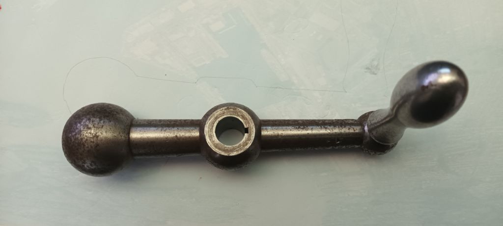

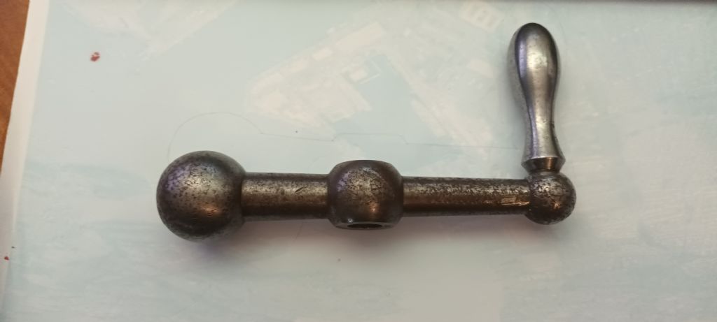

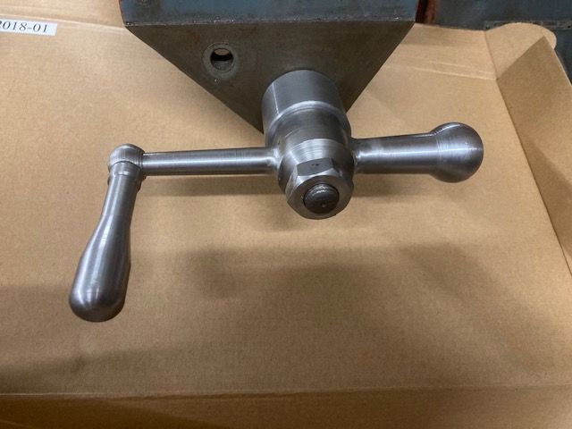

      20220218_105014.jpgSo I'm missing a crank handle for my new to me bridgeport. I didn't realise just how expensive spares are when I bought it so now thinking it could be a good project. Although it has me worried (difficult)
      So what would be the proper sequence?
      I'm thinking, rough it to the various diameters between centres. Then turn the tapers and balls (going to be a seperate thread!!) Then mill the flats and drill the hole. Although how would I fix it for the mill work. Or would it be better to do the mill work first? Would it be best to start with round or square stock?
      I find working up the plan difficult! Cheers Colin

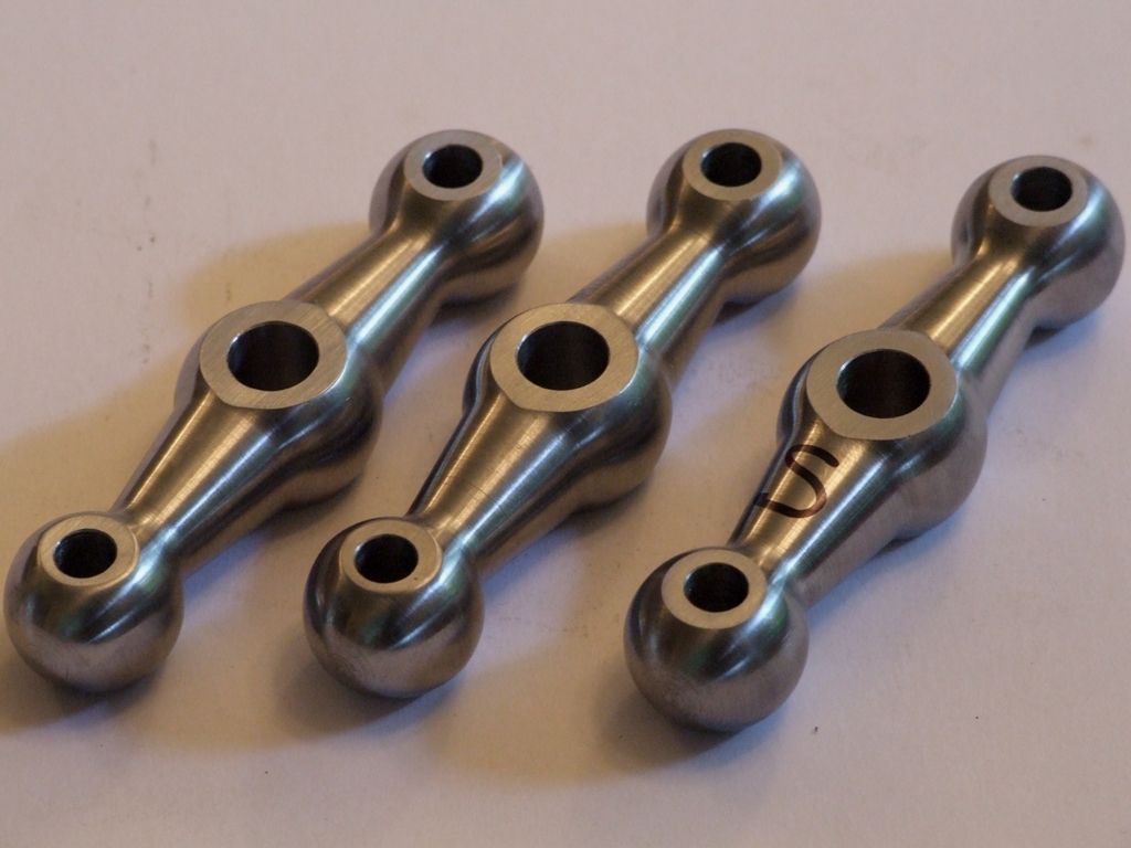

                  Coincidentally I made something very siliar a couple of weeks ago, in my case for the "x" travel on my Centec mill.
                  I cheated and made it in three parts. First the centre boss – which I decided I didn't need to make as a ball – so I milled two flats on the boss and hid two M6 tapped holes in them. I then made the two arms of the handle, with balls and tapers to suit, and drilled and tapped the inboard end of these M6 to match the boss. A short grubscrew in each preserved alignment and held the arms in place while I welded the arms to the boss.
                  Having now established the orientation of the handle part I drilled and tapped a hole in the end of the small arm into which the handle was then loctited. A bit of fettling around the welds just to tidy it up and Robert is your Mother's brother.
                  It's not as pretty as the examples above – but it'll do a good turn nonetheless.
                  HTH Simon
