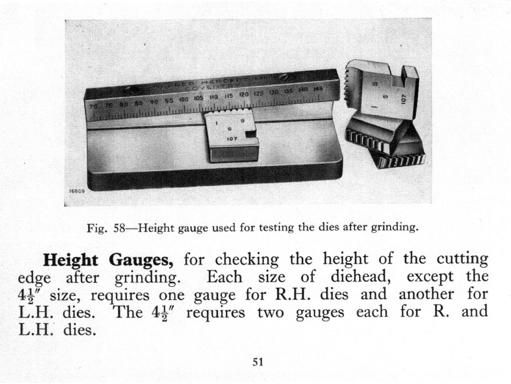

                Nicholas Farr
                  @nicholasfarr14254
                  Hi, this scan below is a copy from a PDF of; The book of the Coventry Diehead 24th edition. the only other mention is how to use it. I don't know if it is the one you a looking for though and there doesn't appear to be any angles quoted.
                  Regards Nick.
