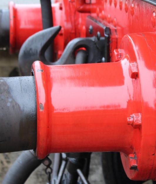

      I've been busy making bits for the front coupling on my LSWR O2 0-4-4T to Don Young's Fishbourne design in 5"G. I can think of a number of ways to assemble the top link to the coupling hook, involving silver-soldering bits together, but looking at photos of the real thing, how on earth did they do it when they made them? Did they forge the link ends after they'd passed it through the hole in the hook? No way would the finished link pass through the hole! Some links on Other Railways have a flat on them to pass through a slot provided above the hook hole, but not on these. A slot in this hook would weaken it too much.
      This is Calbourne in full size:
      I suppose they enjoyed making life difficult for themselves back in the day…

        Speedy Builder5
          @speedybuilder5
          Clever bit of blacksmith forging, putting the second eye on after passing through the hole in the hook?
          #357427
          Jeff Dayman
            @jeffdayman43397
            +1 on a forge weld on one side of the link between eye and hook bend, lots of room there to make a scarfed forge weld very strong. Parts may have started out one being long rod and one eye, passed through hook and bent, then a short rod and eye welded to it. Also possible to pass through a long rod rod and eye, wrap-bend form the second eye, forge weld the second eye, then bend at the hook and adjust centre distances of eye to be even. Skilled work in any case.

                You’d need to examine it closely for tool marks but if these were made by the hundred then my guess is both ends were likely drop forged in several stages. The link is certainly long enough for the hook to be placed out of the way whilst the ends are formed.
                #357444
                Bazyle
                  @bazyle
                  You can see some couplings where there is a slot in the top of the hook hole and a flat at one part of the link so it can drop though the slot yet be retained being too wide when in normal position. Productionised to reduce need for skilled workers.
                  #357459
                  Jeff Dayman
                    @jeffdayman43397
                    Hadn't ocurred to me before, but it is possible the link could be forged first, set in a sand mould, and the hook sand cast around it. This is a technique that used to be used for large cast chains for ships. Two links were cast then placed in a sand mould where the third link was cast around the end loops of the original two links.
                    I have no idea whether this was ever done for these links, or if hooks were ever cast -they may have only been drop forged, for additional strength vs castings. Maybe someone who used to be at a loco works can tell us.

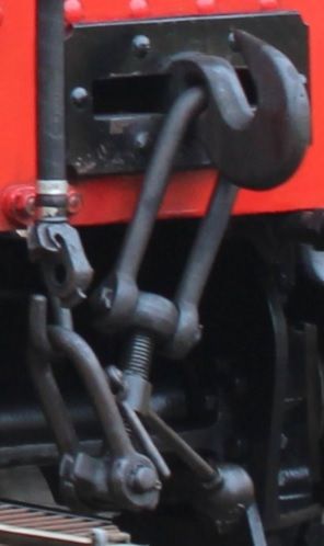

                      I can't answer your question as such but I do know that it's now usual for the drawbar to have a slot cut out of the top and corresponding flats on part of the shackle to enable it to be removed.
                      Its just about visible here :-

                        As a retired blacksmith, these would have been made from a single piece of tool steel. Upset one end and form the eye, then hot punch the hole and drift to size. Push through the hole in the hook and repeat the process. It would never have been welded.

                            Mobile crane hooks are always forged from high carbon steel, so it would be safe to assume that train hooks would be made in the same way. Depending on the length of the train the load on the hook could be upto a 1000 tons.

                                Chains on waggons were made by bending 2 U shapes and resistance welding them together in the 1950s, and the first waggon had to take the full load. I have a very good ILocoE paper about waggon building. In the early 50's BR had over 1,000,000 waggons, quite a thought. Making new ones was big business as they didn't last for ever

                                                Looked up the article on making hooks and chains, chains were made by flash butt welding from 0.2% carbon steel (pretty much EN3 territory) and then load tested at 75 tons. Hooks were forged from 0.3/0.35% carbon steel, getting up towards EN8, but not tool steel.

                                                  P.S. how do you flash butt weld a chain link – surely it's shorted out on the other side of the link?
                                                  #357611
                                                    I'll answer my own question… 'like this' – the other side gets very hot, but it works!

                                                      the waggon chains were 2 U shapes welded together all in one operation. It obviously worked, they made gazillions
                                                      Here's another video of chain making, all the way from wire to finished chain, and not a chainsmith in sight
