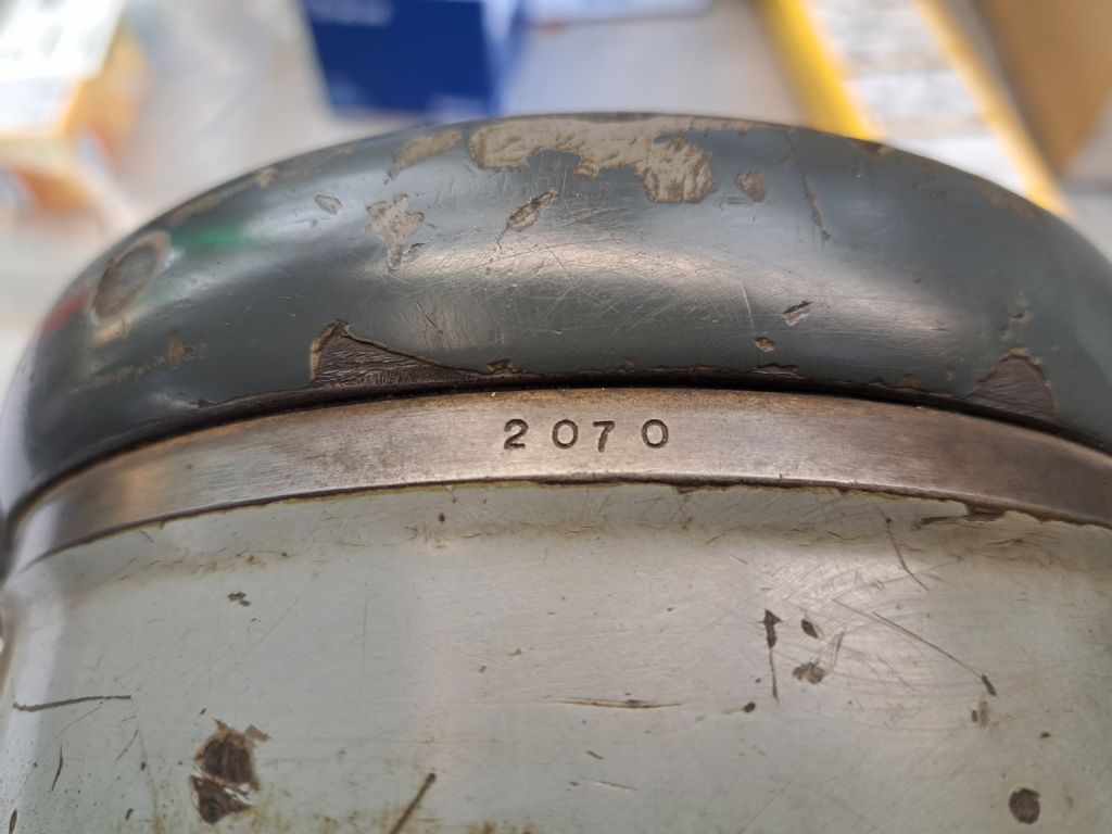

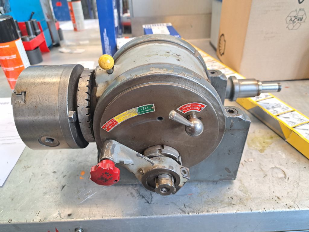

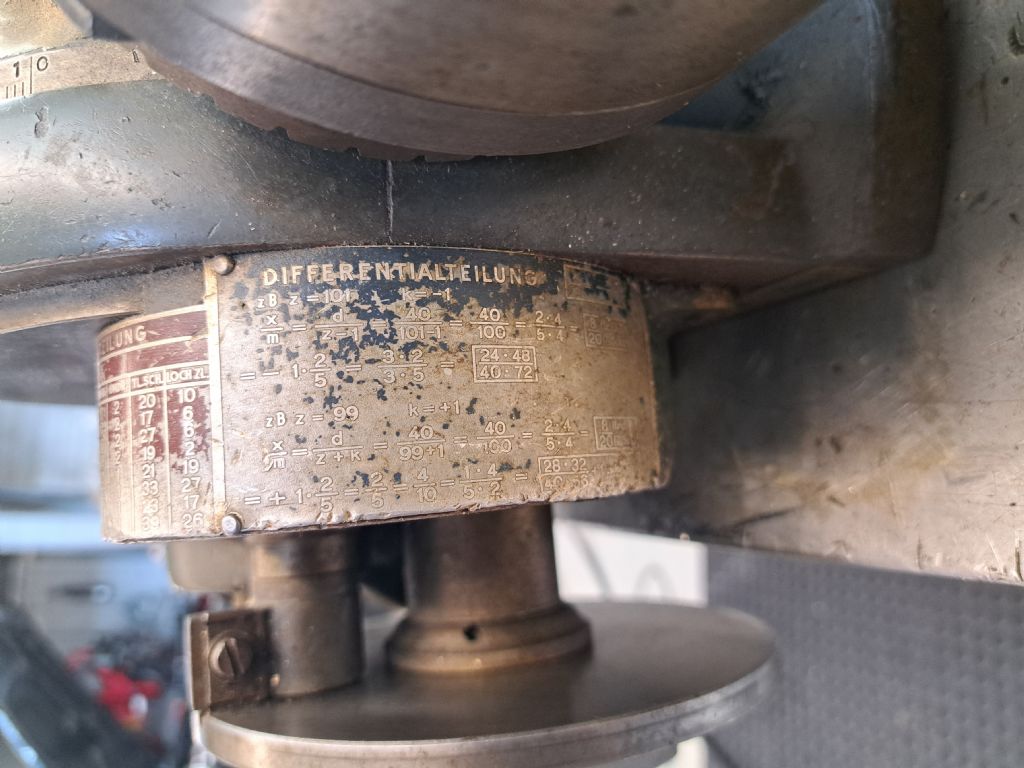

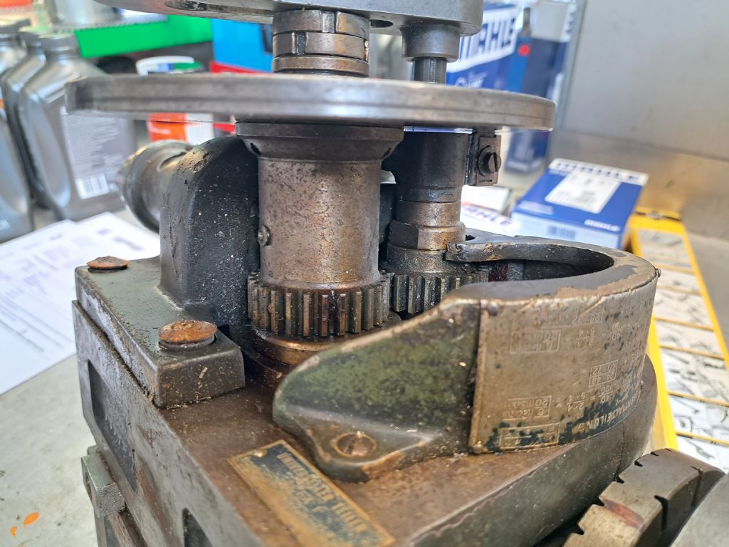

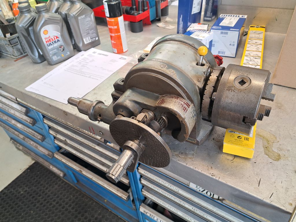

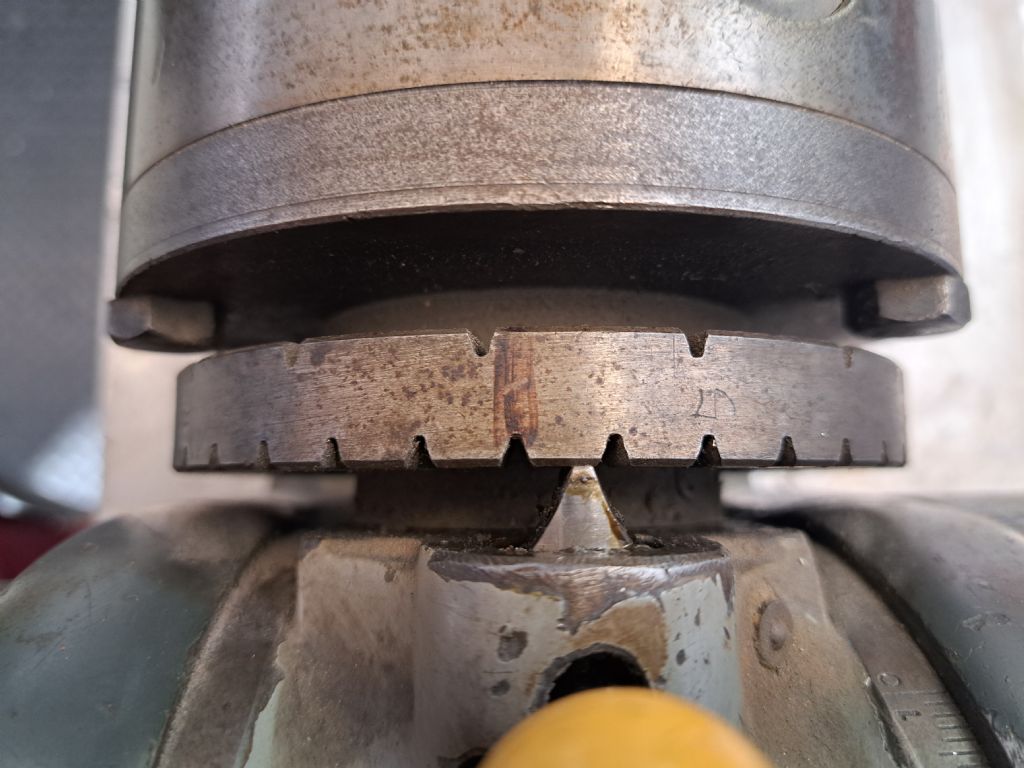

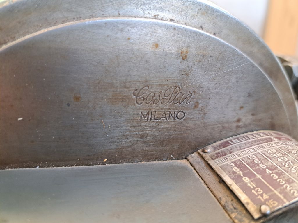

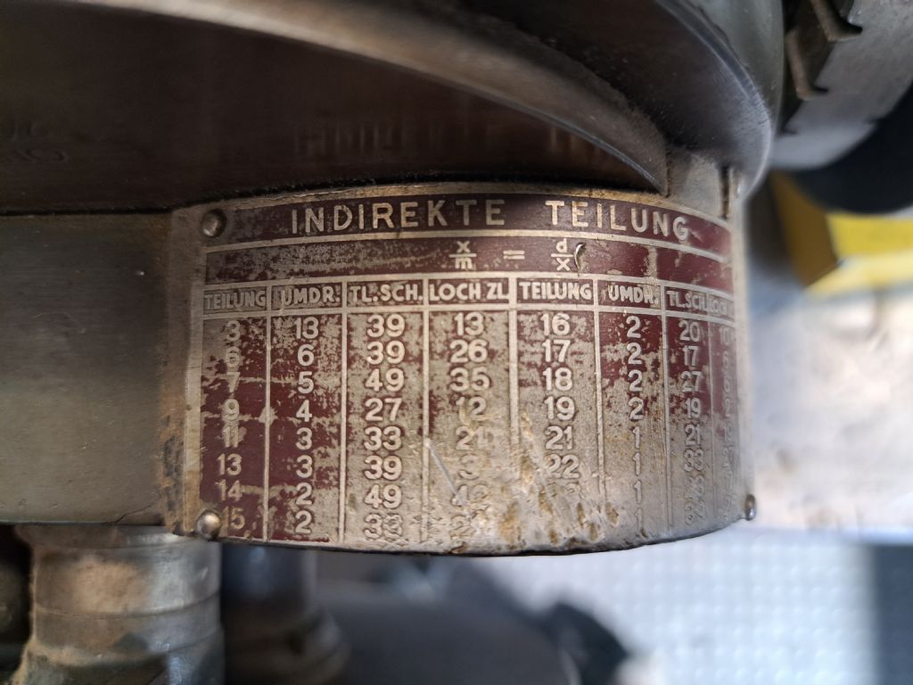

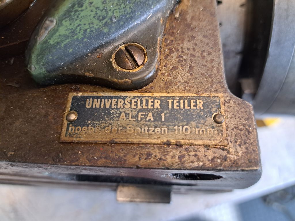

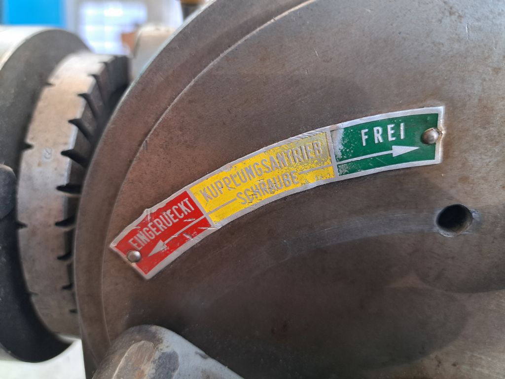

      I was extremely lucky and bought a very beautiful Cos-Par Alfa 1 Universal Divider – I'd thought I'd be outbid but guessing that I was very lucky and others either didn't know what it was or couldn't lift it.
      I'd initially thought that it was a direct and indirect divider with 2 dividing wheels for indirect dividing and the option to use off-the-shelf or custom made custom dividers for direct dividing.
      Looking at it in more detail though I realized that I'd got something more special in my hands. It can be attached to an external drive and I think the idea is that a blank divider disk can be made and slots cut in the reverse side of it so that it can act as some sort of programming wheel to allow the indirect divider to be programmed to automatically move through a predefined sequence of steps. It's more sophisticated than any other mechanical divider I've seen though and I'm having difficulty working out how to use it in fully automated mode. I can't find anything about it online. Does anyone have any details?
      Here are some photos then a video with the indirect dividing disk removed to show the mechanism in action :

          Wow! One lucky find!
          I wonder if is not only for static spin-indexing and compound dividing, e.g. for cutting spur-gears, apparently using change-wheels as well as the usual "holy" division-plates.
          It's not clear from the photos, but can it also be used for spiral-milling: helical gears and worm-wheels, long-lead threads, and similar work, for which the spindle is usually geared to the milling-machine's long-travel screw?
          It has had careful owners too. Yes the paintwork and labels are rather aged, but the direct-indexer is still shapely, the chuck jaws seem in good condition…. Look too at the circular nuts on the operating-spindle: still square-edged, not bashed about by hammers and makeshift drifts!
          I have just had a far-out thought, looking at the labels on this dividing-head. Recalling that strange "circular slide rule" that had us all foxed a couple of years ago now, might that have been some sort of highly-specialised gearing calculator?

                Ah – I had not quite twigged the purpose of the gears. They are for the technique of Differential Dividing.

                  A nice bit of kit, too big for the mills at the museum, a bridgeport size mill would be a good match. It must have been made for the German speaking market, by the Italian manufacturer.
                  #639783
                  Anonymous
                    Lovely bit of kit; did it come with all the gears, brackets and a tailstock?

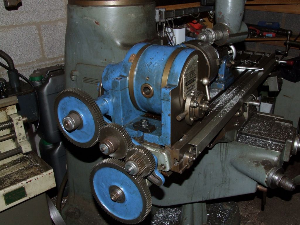

                    It can be used for direct indexing using the plate behind the chuck, simple indexing using the division plates and compound, and differential, indexing for divisions not available using the standard division plates. As stated above, in conjunction with a universal horizontal mill it can be used for milling helical gears:
                    Or on a Bridgeport for high helix gears:
                    Like this:

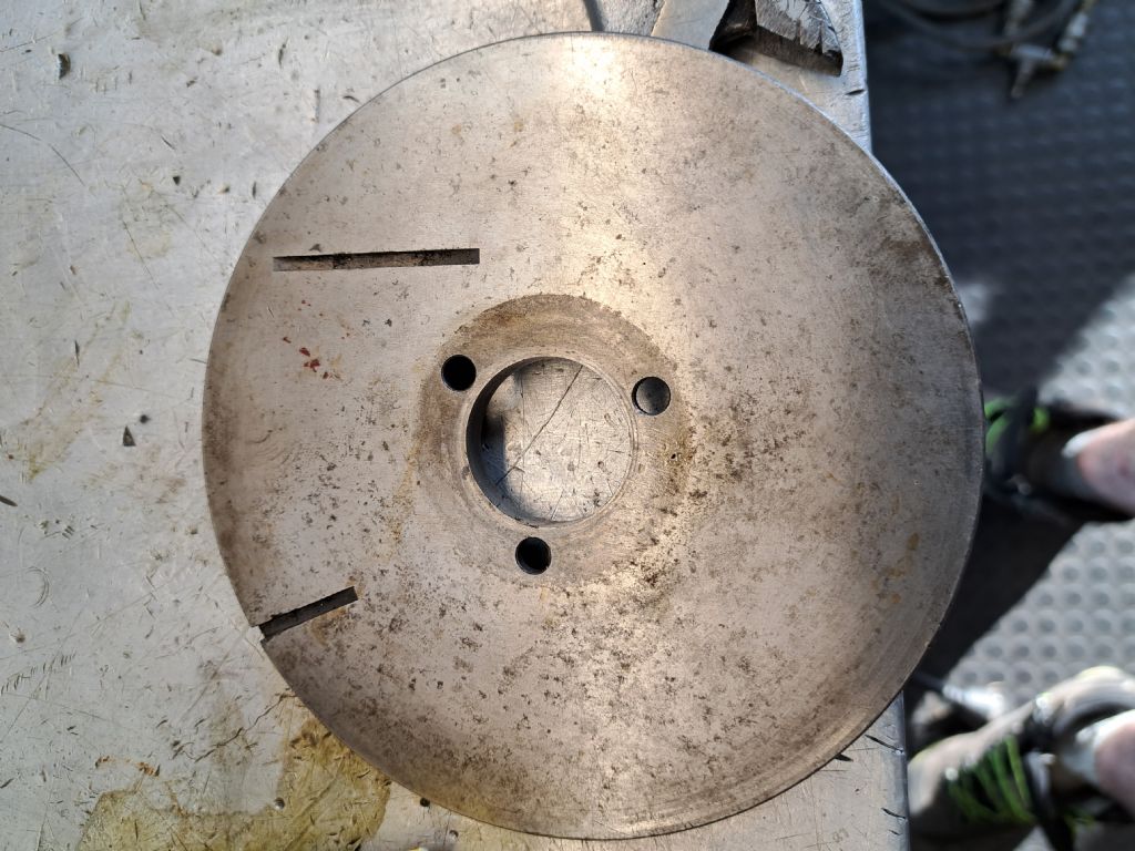

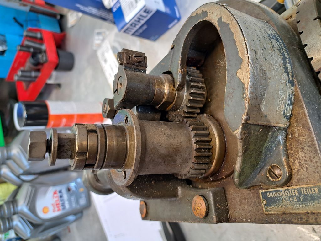

                      Although the indexer itself seemed in very good condition (there was a little backlash but I think that can be adjusted away, addressed by locking before each cut or addressed by always cutting in the same direction) the tailstock, gears and brackets were all missing – one of the direct indexing wheels had a few teeth missing but I think they were intended to be replaceable so that custom direct indexing wheels could be made for frequently used sequences.
                      My guess was that I could run without the tailstock if I kept the cuts very light – or should maybe try to make a new tailstock for it?
                      With the gears and brackets missing would it be better to replace them with a stepper or servo motor and driver and use electronic synchronisation?
                      The part that fits into the notch at the top looks like it was designed to be easily removable and replaceable – is that simply so that it can be removed when using a gear train to move the indirect indexing wheel for differential dividing? What does the second notch cut into the back of the dividing wheels do?

                        I bought it in Switzerland so guessing that it must have been made near Milan then labels made in French, German and Italian for the Swiss market.
                        Yes – it looks like differential dividing – which until Andrew's explanation above was a technique that I'd only known very vaguely about (I'm from the CNC generation…).

                            It should be used with a tailstock even if you need make one, or make some sort of adaptor for a tailstock borrowed from the lathe; at least on work needing a long overhang such as features on long shafts, and gear-cutting needing maximum rigidity and long run-outs. One sold by e.g. Warco for the Vertex clone dividing-head might work – if necessary with a raising-block.
                            Stepper-motor? Why try to complicate it? Try to keep as original as possible – especially having complimented it on its looks!
                            It was made in Italy for a German-speaking customer so the gears are almost certainly of mm Mod pitches though I would not like to say what pressure-angle. So it would be worth looking at what stock wheels are available, from e.g. HPC. The bracket could be designed and made from studying manuals for similar dividing-heads. It does depend a lot on how much very advanced helical milling you intend to do!
                            Those two slots in the plate puzzle me – I'd guess they are part of the controls that engage and disengage particular functions.

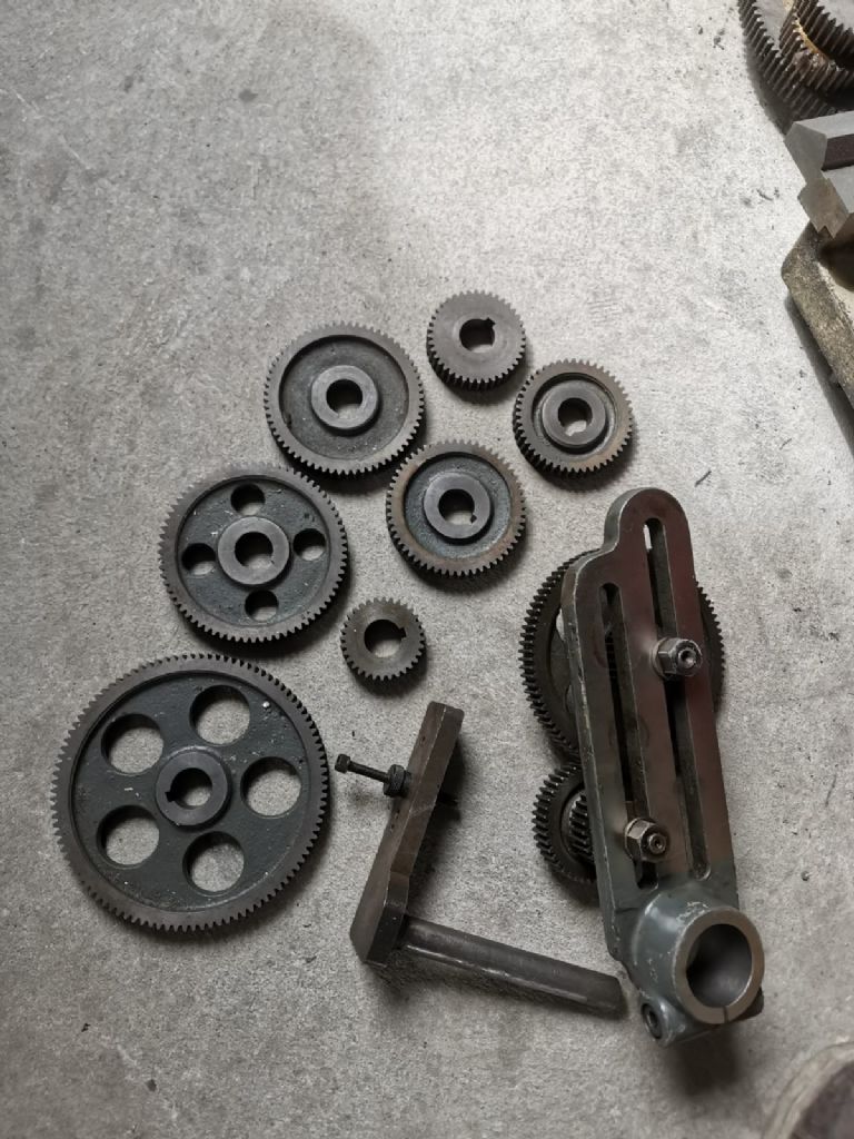

                              I sent the person who'd sold me the divider the information that people on here had found – he used it to have a search around his workshop and found this: smiley

                                  Wow! Almost a home run; looks like ten gears (?) whereas a standard set is eleven gears. Banjo and gear studs are an excellent find. I had to make new studs for my my dividing head.

                                    When you see a set of gears, eg on ebay, the inclusion of 86 is the tell-tale that they are dividing head not lathe wheels.
                                    You will find charts for differential indexing on the internet but check the calculations as there are a couple of mistakes in the B&S ones. Also see Machinery Handbook of course, if you can read the tiny print.
                                    you have been lucky to get what looks like the full set of 11 gears to allow indexing up to 500. For anyone who is 'making do' check the tables, work out the ratio the gears are providing, and use any other gears from your lathe to make the ratio – there is nothing magical about the actual gears used in the tables except that it was some clever mathematician that worked it out way back with only a Babbage computer to dream of helping.
                                    The extra slot in the plate is odd but might be for linking, 'compounding' , two plates back to back for 'compound indexing' which is rarely used or referred to now but uses two sets of holes simultaneously. It should get more press as it can be used with a non-universal dividing head with minor adaptations.
