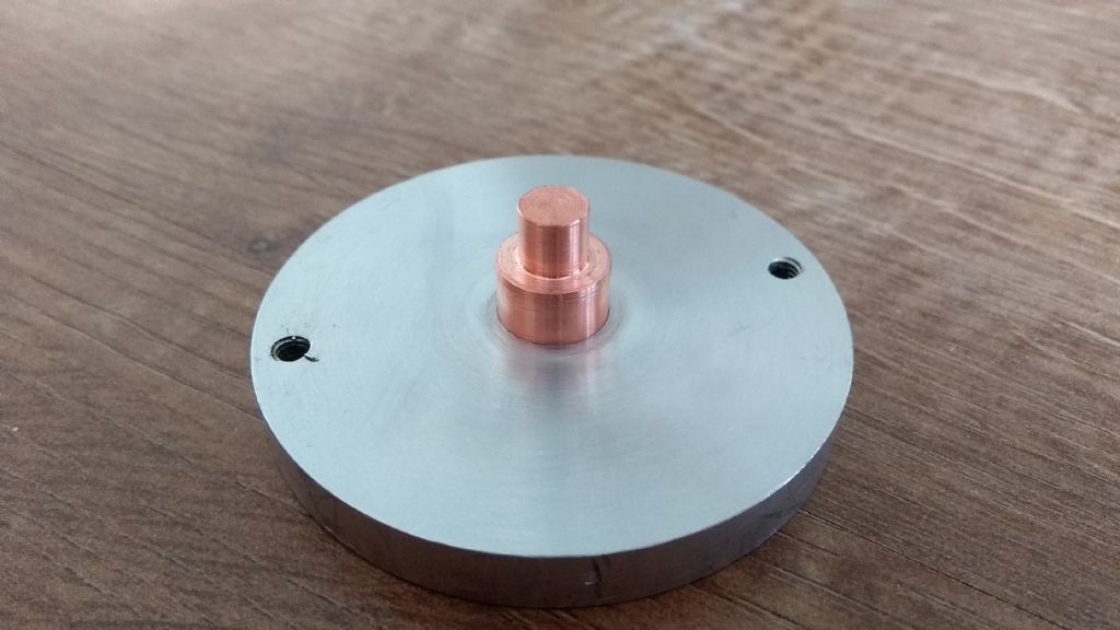

        Ok, plenty of people will be able to guess the general idea, but armed with a vague idea of my interests can you give a more than just a name to this part?
        Clues – the two parts are an interference fit and pressed together in the vice before finishing the central part. There are two more threaded holes to be added either side of the column and in the finished project this will be totally hidden from sight.
        Strange distortion on the phone camera, those holes are diametrically opposed!
        Edited By Neil Wyatt on 31/08/2019 14:14:01

          Posted by Neil Wyatt on 31/08/2019 14:12:44:
          … armed with a vague idea of my interests can you give a more than just a name to this part?
          It's an Industrial Grade Nipple Shield.

          Brian Sweeting 2
            @briansweeting2
            A telescope pivot?
            #426814
            peak4
              @peak4
              Considering an interference fit with the copper item; is it a heater to combat dew forming in a telescope?
              Bill
              #426816
              Arthur Sixsmith
                @arthursixsmith43623
                Guitar effects peddle?
                #426817
                Nicholas Farr
                  @nicholasfarr14254
                  Hi, it's a base for a rotating space camera/telescope which is due to be taken up to the ISS on the next launch and then one of the astronauts will do a space walk and weld it somewhere on the outside. nerd
                  Regards Nick.
                  Edited By Nicholas Farr on 31/08/2019 15:37:25
                  #426824
                    Posted by peak4 on 31/08/2019 15:32:42:
                    With similar, but inverted logic … is it a cooling stub for a camera ?
                    #426830
                    Joseph Noci 1
                      @josephnoci1
                      Posted by Michael Gilligan on 31/08/2019 16:19:30:
                      Michael's got it…To cool the sensor.

                          Michael, Joe and Robert have it.
                          It's for a 'Toupcam Mono', a very simple mono camera with a small sensor, normally the sensor sits on top of a 'stalk' that is moulded into the case, quite a neat arrangement but only basic passive cooling.
                          If I cool to zero or below it I will be able to take long exposures with little noise. It will fit on a cheap peltier and heatsink/fan module in place of the small internal fan and heatsink.

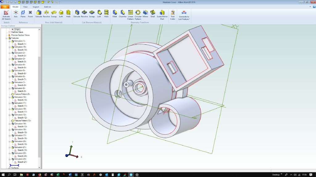

                          I'm 3D printing a 2nd prototype case, obviously plastic with a honeycomb of air inside is a good choice for insulation, with some strategically placed foam above the body of the heatsink.
                          The final design will need to include a t-thread to attach and adaptor and perhaps a storage space for a silca gel sachet.

                                      Current iteration. Designed to have a Canon ET to T-thread adaptor glued in the end to give the same back-focus distance as a DSLR so it can be swapped across without re-focusing and used with field flattener/coma corrector (although these are probably uneccessary with such a small chip it makes things easier = more reliable).
