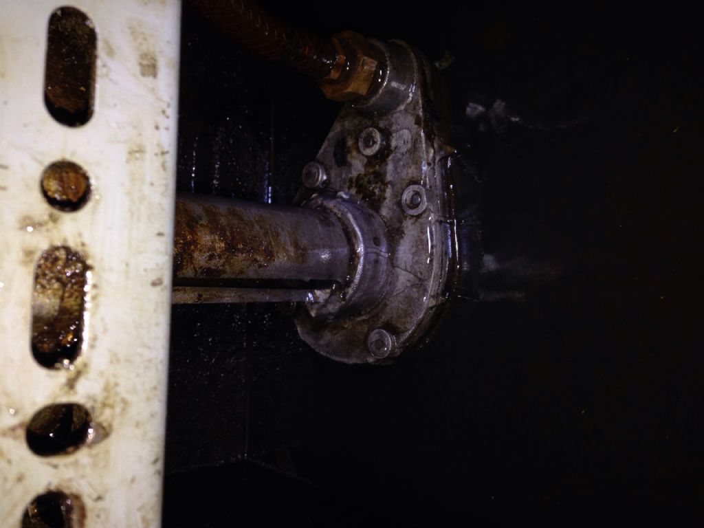

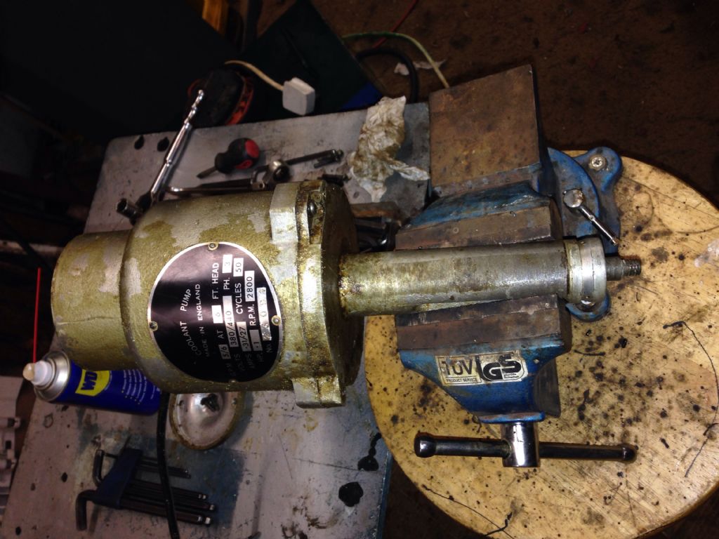

        I have a coolant pump on my lathe but it can't push the coolant up to the outlet! The pump states RPM 2800 but 2000 is the max I get! It's 3 phase and I'm running it through a converter, how do I test it's getting the correct volts, 3 wires on the back of the pump 1 2 3 terminals, and an earth,. Also when the pump is running fluid is coming out the drive shaft see photo, should it do this? I have got it apart but there are no seals around the shaft just a small gap say half a mm, I will put the photos on in a moment as they are on my iPhone .

                  Posted by Robonthemoor on 09/11/2013 21:48:00: this is the pump in action, as you can see fluid is pouring out the drive shaft turret below is the pump above is the motor, I have only put water in it so the inlet at the bottom of the pump is covered, the blades on the pump are good & a good gasket seal was found so no problem there. Do you recognise this type of pump, British made.

                        How can you see fluid coming out of the drive shaft? The part in your last photo is the impeller housing which must be submerged in the coolant, there is a spigot on this for the delivery hose. If you are using a converter (not a VFD) you should not run the pump without the main motor, 3rd leg voltage can rise excessively and damage pump windings, minimum load for converter is usually around 1/2 HP. Voltages from converters can be lower than expected but would not affect RPM. Check impeller, check pipe and valve for blockage.

                          Rob, as Dave says above, the pump housing must be fully immersed in the fluid being pumped, most run with fluid covering the pump by a good couple of inches.
                          Most of these pumps (that I've seen) do pour out a fair bit of fluid from the shaft housing when running, this is to prevent cavitation (and the noise that ensues) when the pump outlet is stopped off and also helps to maintain a good mix of coolant fluid.

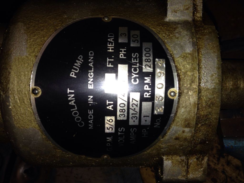

                                From the label on the motor it requires about 400 volts between phases. You use the term "converter" so I assume it uses capacitors to produce some phase shift. (Rather than being a true three phase inverter.) I suspect you do not have 400 volts between phases. Measure the voltage between each of the three phases and report back with these readings. Also check the pump turns freely as Jonathan suggests.

                                                Errr, 1hp seems pretty big for a coolant pump? Unless that's a bit of dirt in the picture of the motor rating plate, might it be 0.1hp? I can't quite get my head round why it's running way below it's design speed, I'd have thought that if the frequency was right then the speed would be within a few percent of 2800rpm.

                                                  I agree, Andrew
                                                  The rating plate reads more clearly in the wide-shot.
                                                  380/410 Volts
                                                  .31/.27 Amps
                                                  .1 HP

                                                    Earth to L1 260v earth to L2 260v earth to L3 265v
                                                    L3 to L1 415v L3 to L2 415v
                                                    L2 to L1 000v L2 to L3 415v
                                                    Wire colours , blue brown black green. In the top of the motor just 1 2 3 terminal
                                                    can you work it out from this?
                                                    Rob
                                                    #135171
                                                    Anonymous
                                                      L1 and L2 are the same thing, ie, shorted – Andrew
