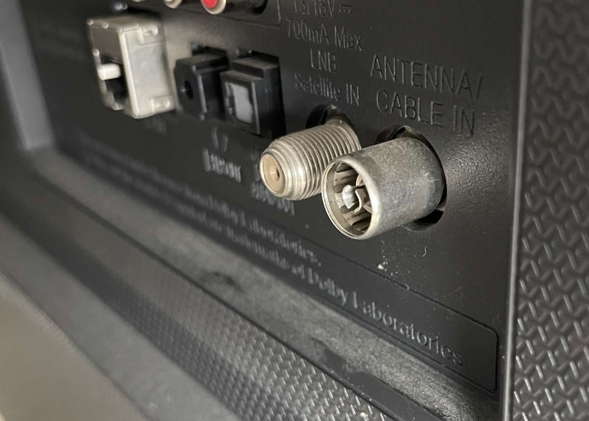

      I have just spent a very frustrating afternoon doing a five-minute job !
      When I moved to North Wales, I just plonked the LG television on a convenient shelf, and didn’t bother installing it.
      A couple of weeks back, I tried plugging a shiny new coax antenna-lead into the socket … “oh deary me” says I [or words to that effect], the plug doesn’t fit the socket and it feels like I will break the circuit board !
      Returning this afternoon with an assortment of leads gathered from my hoard [the original, of course, having been left in-situ at the old house] … not one of the plugs fits the TV !
      As luck would have it … I also had a ‘Trade Pack’ of loose plugs from MAXVIEW and Yes these fit beautifully.
      So … my question for the forum is: Is there a dimensional standard for these plugs and sockets, and if so, how tightly toleranced is it ???
      I rather suspect that some evil ‘rounding’ has crept-in with metrication
      Edit: __ For the benefit of anyone else hitting the same problem:

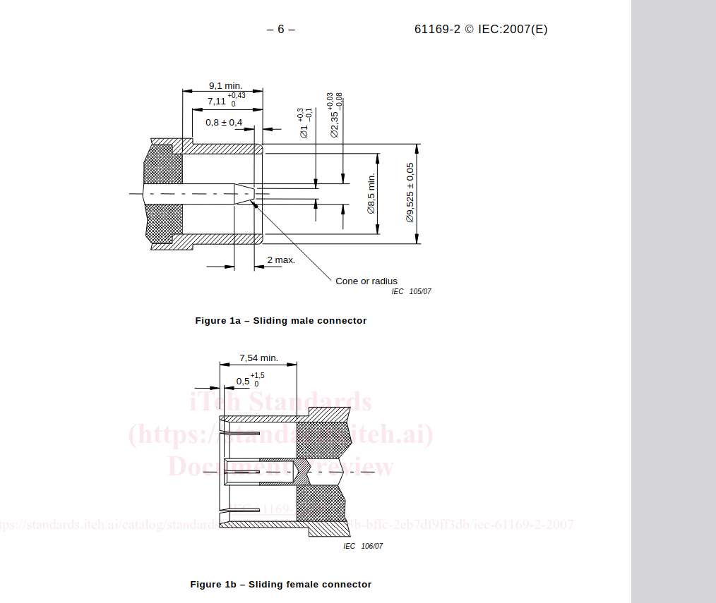

          The plug diameter should be 3⁄8-inch (9.525mm). I have not found what the diameter the inner pin should be.
          https://en.wikipedia.org/wiki/Belling-Lee_connector
          #786943
            Thanks, Peter … I will measure the two inner pins tomorrow

              Yer tis’
              Screenshot From 2025-03-02 19-23-53
              I’ve got loads of them, so will measure a few.  Quality varies enormously.   The LG problem might be the female – they’re spring-loaded in various ways to grip the plug, ranging from cheap and nasty slots to elaborate clips.   Possibly the LG has a strong spring and needs a lot force to open it.  The chamfer on the plug that opens it isn’t specified…
              Why is nothing ever easy?

                      Many thanks for the drawings, Dave !
                      … and for your offer of some sample measurements.
                      Edit: __ This is an earlier model of LG TV … but I am taking it as circumstantial evidence of their build-quality:

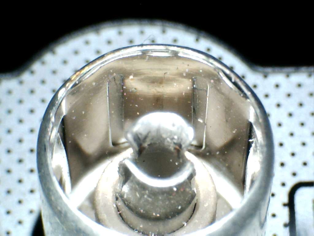

                        In my present enfeebled state, I dare not risk taking the TV off its shelf, but I’ve managed to get a snapshot of the female connector … confirming Dave’s assumption:

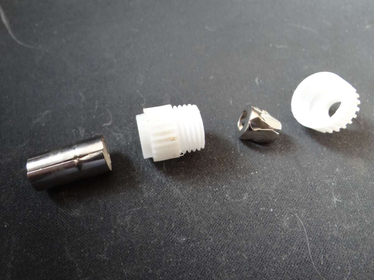

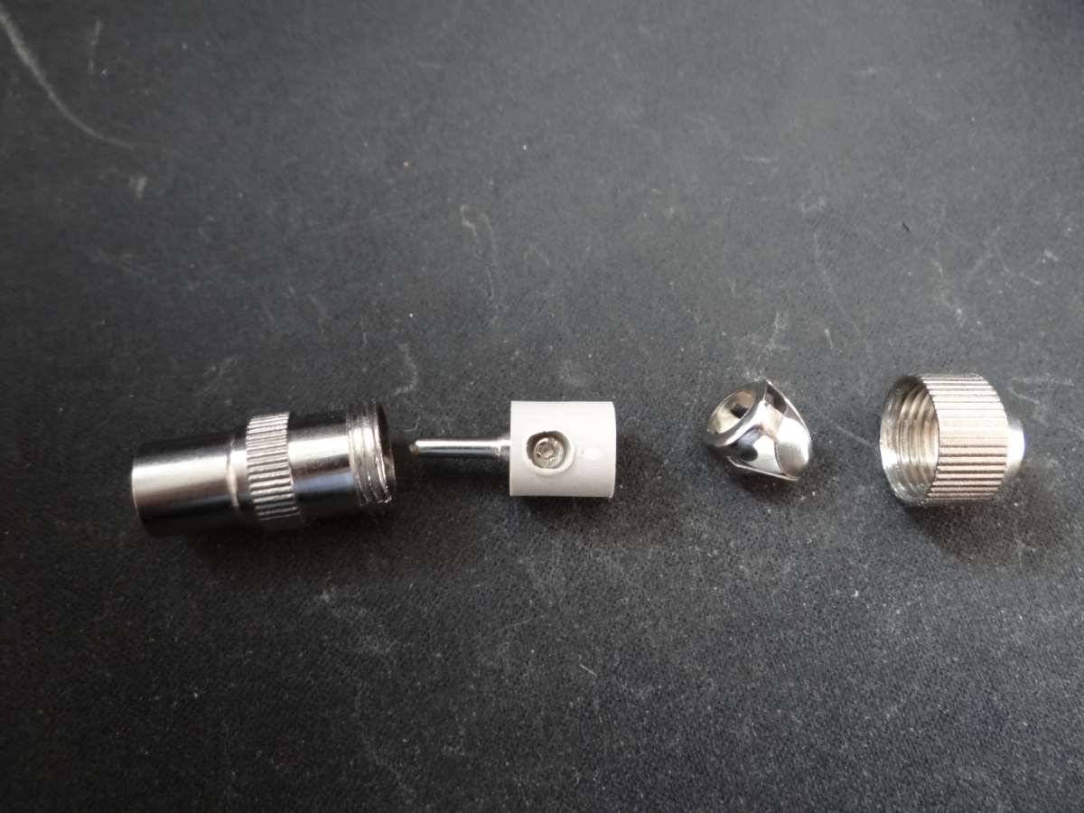

                          As promised some measurements.   I’m surprised!
                          Be warned: don’t read this if you like to believe British made stuff from yesteryear is high-quality compared with modern rubbish!

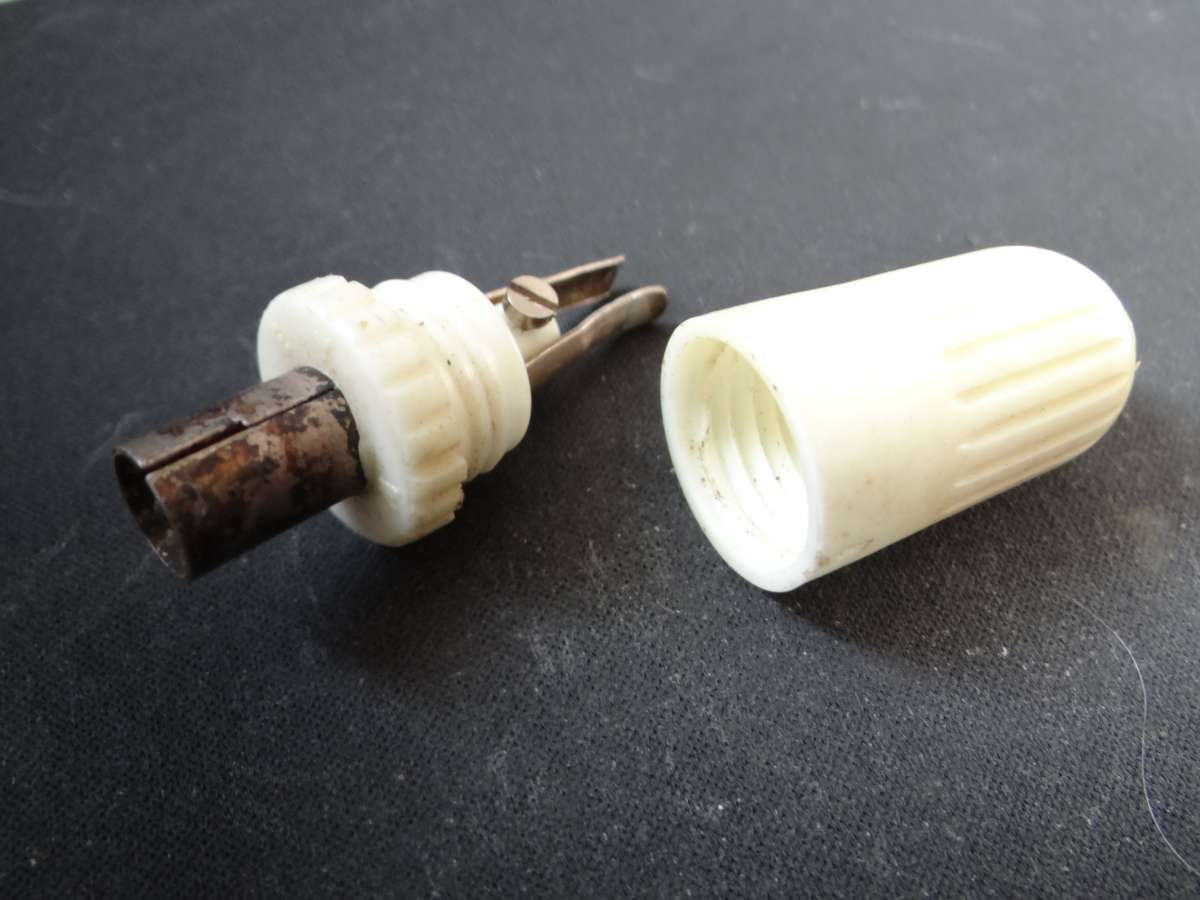

                          Here are the examples:
                          1. 1950/60 British.
                          DSC06885
                          2.  Modern plastic, circa 2000.
                          DSC06886

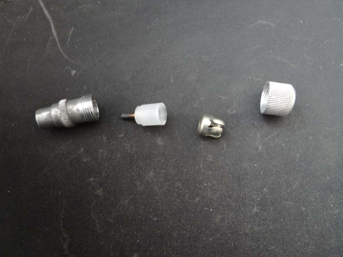

                          3.  1970-ish British, Aluminium, very common (2 examples):
                          DSC06887
                          4.  Metal recent, foreign made:
                          DSC06888
                          In general these are not precision made!  The pins and bodies are not round, and sizes vary considerably on the same plug and in comparison with others.
                          1950’s British, with silver plate.   Body 9.32, 9.46, 9.40, 9.55, variance 0.23mm.   Pin 2.40mm
                          1970’s Aluminium.  British. Corroding.
                          • Example 1: Body 9.54, 9.59, 9.55, 9.52 variance 0.07mm.  Pin 2.35, 2.33, 2.32, 2.37 variance 0.05mm.  Crudely threaded, hard to assemble
                          • Example 2: Body 9.46, 9.45, 9.47, 9.46 variance 0.02mm.  Pin 2.49, 2.35, 2.41, 2.37, variance 0.14.  Clean thread,
                          Plastic Modern circa 2000:  Body 9.53, 9.56, 9.54, 9.47 variance 0.09mm.  Pin: 2.37
                          Metal Modern, recent purchase:  Body 9.49, 9.48, 9.47. 9.50, variance 0.03mm  Pin: 2.36, 2.26, 2.25, 2.26 variance 0.01mm
                          These plugs aren’t made to high tolerances!  Though they look similar one British Aluminium plug is more accurately made than the other.
                          And although the silver-plated plug looks good, it’s dimensionally poor compared with the Aluminium plugs.  The plastic modern plug is slightly worse than them, but the best is the recent purchase.
                          Body dia should be 9.525mm.  Mine are mostly under that, except for a couple of fat spots, probably due the body not being round.
                          Pin should be 2.35mm.  Again, my examples are mostly undersized, with a few fatties.
                          Conclusion:   with one exception, possibly lucky, my sample plugs clearly aren’t precision made!  Therefore expect some loose and some excessively tight fits.   I guess Michael’s TV has a sprung tight socket, and his plugs are all fatties apart from the Maxviews.  I must have used hundreds of Belling Lee plugs over the years and not had a problem, but…

                              Further to Dave’s very informative measurements …
                              The central pin [actually a tube] on this particular batch of MAXVIEW Plugs measures only 2.24mm … bulging very slightly to 2.25mm where tip has been worked.
                              The ‘oversize’ pin on the ready-made lead measures 2.36mm … bulging very slightly to 2.37mm where tip has been worked.
                              The large diameter is 9.46mm on both.
                              I must therefore conclude that the underlying problem is indeed the socket that LG uses … which is fortuitously ‘just right’ for the undersize pin.
                              Just to emphasise: The socket would probably accept a full-size pin if you push hard enough, but I was not willing to take that risk … and a look at the video I posted earlier would suggest that the risk is significant.
