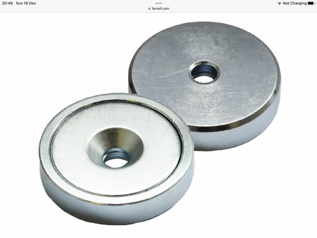

      Browsing ebay last night, I spotted that Zoro is listing Eclipse Magnetics E1001/NEO at what appears reasonable price … but I’m confused by the product itself.
      Farnell has the Eclipse data-sheet available: **LINK**
      https://www.farnell.com/datasheets/2290329.pdf
      … but I’m still confused.
      Does the Zinc plated casing provide any useful functionality, or is it just a cheap way of making a small magnet look bigger ?

          Virtue out of necessity I think. Usually they are plated with nickel, then copper then nickel I think as otherwise the material corrodes very quickly. Zinc is probably cheaper?

            Thanks, John … but it appears to be a casing rather than just a plating-job

              Perhaps a countersunk fixing could cause an unconstrained magnet to split if carelessly fixed.. ..is the housing to provide support..? 'containment'

                Hi Michael,
                I believe the”can” is there to complete the magnetic circuit. Once the “target” touches the face of the magnet a path exists for the magnetic flux to complete its circuit. For this to be so the “target” needs to be of sufficient diameter and aligned correctly to cover the can and magnet.

                  Neodymium is too brittle, fragile and chemically 'active' to be used 'naked'. Hence the magnets are encased for mechanical and chemical protection, and the Zn plate is presumably to protect the case material against corrosion. It looks like the case also acts as a 'pot' magnet's peripheral pole piece, as suggested in the post above.

                    Thanks, folks yes
                    That seems to make sense … now I’m just surprised to see how many ‘naked’ ones are around.

                      I think that neodymium nudity is very rare – every one I've ever seen is nickel plated at least. Once I managed to chip the coating off and the magnet quickly corroded.
                      **LINK** shows a pot magnet that definitely has a surrounding case – however you can clearly see the gap between the "pot" and the centre pole needed to make sure the flux isn't shorted. There is only a very thin line between the outside "pot" and the magnet face in the Eclipse photo though – but I notice that if you look at the screw hole it does look as if there's a plate at the bottom. You must tell us what you find Michael!

                                    David Davies 8 is correct, the casing or "pot" is there to complete the magnetic circuit and increase the force. They are often called Pot magnets and existed before rare earth magnets.
                                    The pot also protects a brittle magnet from direct impacts as a secondary benefit. Both magnet and pot are plated to prevent corrosion.

                                                  Yes … it seems the Eclipse one has a countersunk magnet. Don't really know why that's necessary and it makes the magnet a bit "special".

                                                    The Lee Valley design uses a standard magnet but has the disadvantage that the mggnet fits over the screw after fixing. This has two disabvantages:
                                                    1. The assenbly is thicker / taller
                                                    2. It is very difficult to remove the maget to get at the screw if it needs tightening or the assembly moving.
