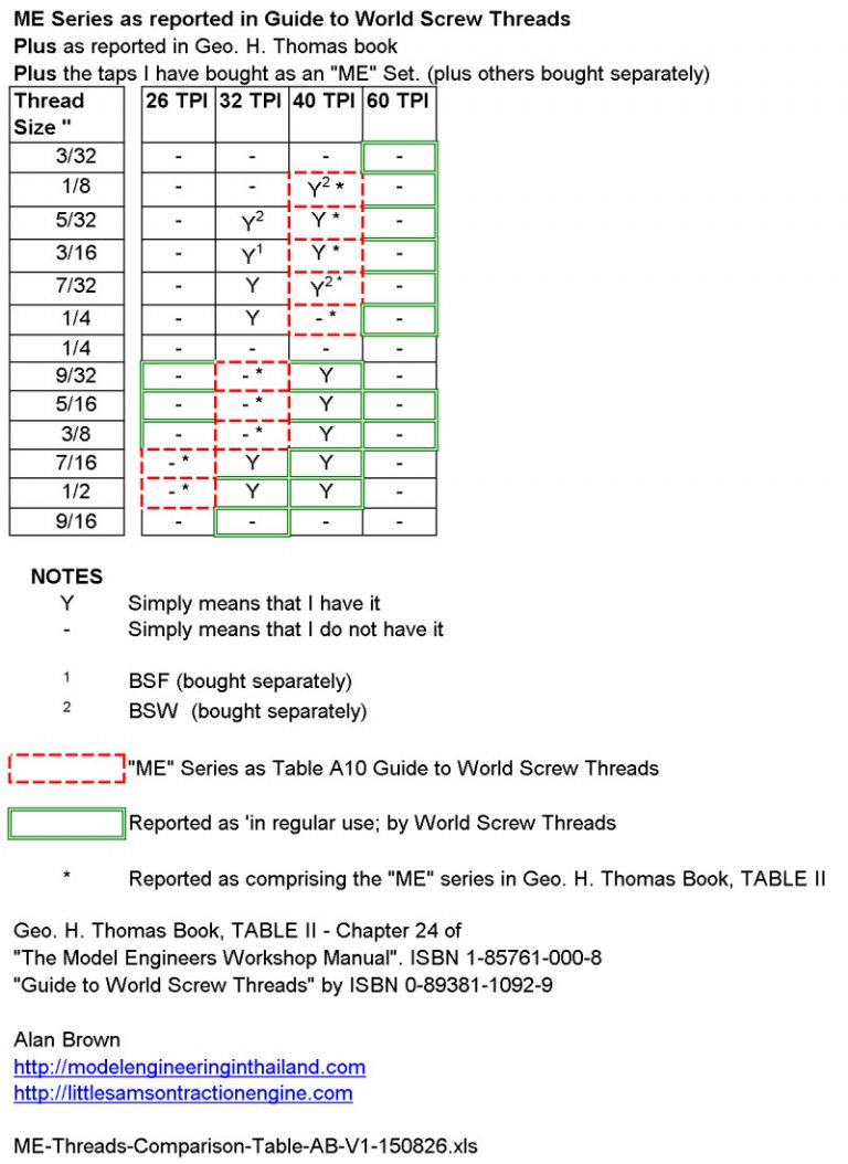

                                                    Well, thank you everyone who has helped me to understand the ME Series of threads.
                                                    I needed to have this knowledge because I want to buy some steam engine pipe fittings and I wasn't sure what the threads stated in the vendor's catalogue were nor if I had the right taps and dies to make matching components.
                                                    With your help I have compiled the Table below which shows three main pieces of information:-
                                                    1) The Threads forming the ME Series as reported in a book "Guide to World Screw Threads" by ISBN 0-89381-1092-9.
                                                    The above Series is repeated in the book "The Model Engineers Workshop Manual". ISBN 1-85761-000-8 by Geo. H. Thomas. Seems he was correct and my comment in a previous post is withdrawn with apologies.
                                                    2) Additional threads reported in the same "Guide to World Screw Threads" book as being "in regular use".
                                                    3) The taps and dies that were included in a commercial ME Series tap and Die set that I purchased from one of our regular suppliers. (Plus a few I bought separately)
                                                    This may be important to you if you are thinking to buy a set because you, like me, will probably end up need supplementary taps and dies.
                                                    The fittings I was interested in purchasing include some for which I do not have taps and dies, namely 1/2" X 32 and 9/16" X 26 both of which are not in the ME Series.
                                                    A Standard for the ME Series
                                                    It seems that there is no published Standard for ME Series threads. The range has grown by demand from users and the trade has stepped in to supply the demand.
                                                    The situation as above is supported by Geo Thomas in his book on page 266. (I would like to quote but the book is copyright).
                                                    Whitworth Form
                                                    Although no publication I have seen states that the ME Series is Whitworth form, the description of the ME Series on page 19 of "Guide to World Screw Threads" appears in Section A "BRITISH THREADS OF WHITWORTH FORM". So that seems to confirm that Whitworth is the correct thread form.
                                                    Below is the Table I have compiled illustrating the ME Series of threads.
                                                    Once again thank you everyone who has contributed, it seems that my question has been answered.
