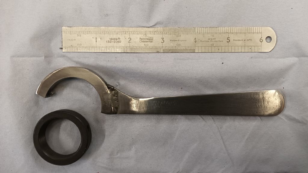

        Morning all. I just bought myself a 5c collet block set and it would appear I need a C spanner to tighten the collet up. This wasn't supplied in the kit ( which seems odd to me). Could someone point me in the direction of a suitable sized one? Thanks Colin
        #629013
          If no other reply I'll measure up the one I use a bit later.
          #629014
          DC31k
            @dc31k
            In addition to 'C spanner', they are also known as 'hook spanner', so that might give more options when searching.
            They are sized according to the OD of the nut so measure what you have. There is a table of sizes on this eBay listing, which might help:
            https://www.ebay.co.uk/itm/194318571071
            If there is an 'official' standard for them, it is DIN1810 (DIN 1810 specifies many 'Forms'. The one with the square prong is Form C).
            https://www.ganternorm.com/en/products/3.2-Mounting-positioning-levelling-with-screws-clamping-and-supporting-elements/Nuts/DIN-1810-C-Spanner-Steel
            If you have an ER collet chuck, try the spanner from that. It is the same type of spanner so it might fit.
            #629015

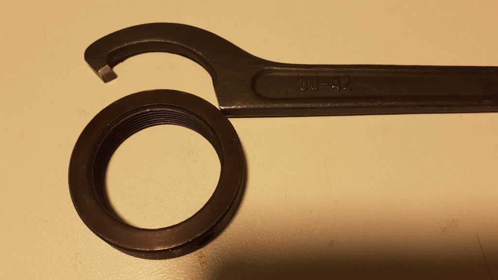

              Had a but more time than I thought. I use a 38-42 one that has had the tip slightly ground so it fits in the hole rather than a slot.
              The ring on mine is actually 42mm so you could also use a 40-42 pin type C spanner

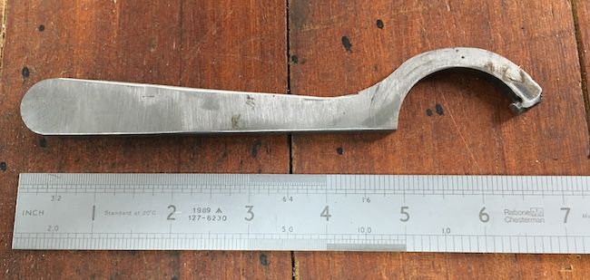

                        This is the one I made perhaps 30 years ago.
                        Works well.
                        As I recall things I cut a 1/4" thick ring from the end of a piece of steel bar and cut it in half.
                        The pin was positioned by eye with reference to the collet block "nut" and welded in place before a bit of light filing to clean up to a
                        I cut the half ring down to what looked like a suitable length of arc and welded that to a short offcut of 1/4" plate. Bandsaw, file and linisher to finish off a bit smart with no sharp edges.
                        Objectively a bit more time and trouble on radiusing the edges with a bit more spit'n polish would have been nicer but made no difference to how well it works.
                        The taper on the handle makes it much more pleasant to use. Could have done a simple rectangular bar or even a rod but such tend to be unpleasant to hold. Sufficiently so as to make positioning harder. Learned a long time ago that tapered handles, large end out, are well worth the effort.

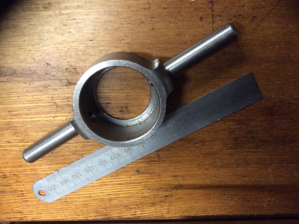

                                    Clive, I hope you don't mind but I copied your spanner!! It works fantastically. Thanks for taking the time to post the picture.20230129_123537.jpg

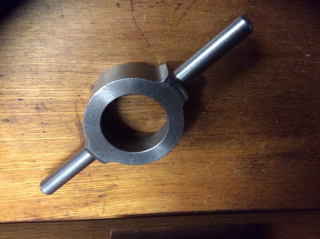

                                      c34bb8d6-dad2-43cf-a08e-23471c42fa97.jpegOn the subject of collet spanner’s I made a two handled spinner type for my ER collet nuts as I found the supplied spanner’s awkward to use. It’s been about 15 to 20 years now and wouldn’t be without it!8f428cd1-46c0-46bf-96e0-00a54c78e538.jpeg

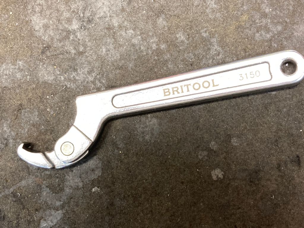

                                          I see you are all fixed up but for interest I have an adjustable one, available in different sizes.
