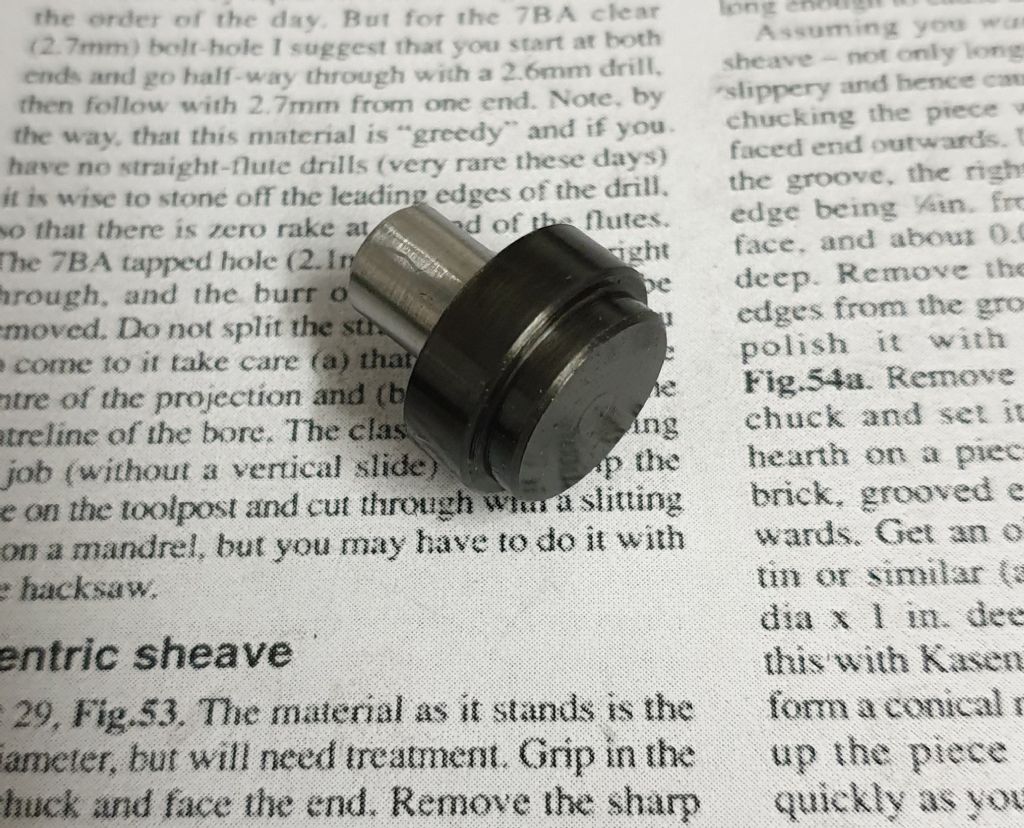

                    If you look at the cannon in my album, that was made in 2002 and blued with G96 paste after unsatisfactory results with some liquid cold blues. The photo dates from 2005, and it looks the same today.

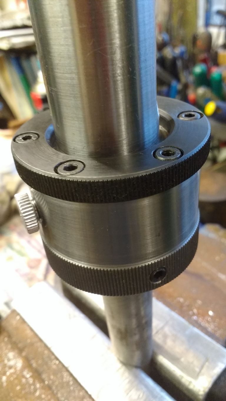

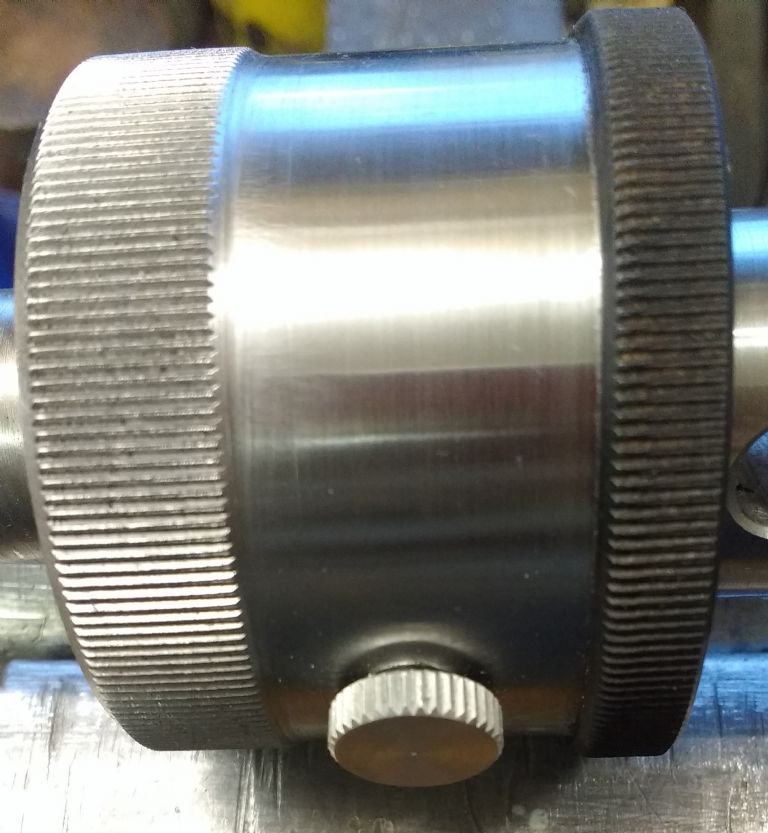

                                                      On the strength of the recommendations in this thread I bought some Abbey Blu Gel to touch up some scratches on a blued surface, worked well.
                                                      Then decided to try it on something larger. I had just stripped down a floating reamer holder I made many years ago, it felt a bit "gravelly" so in need of a clean. The photos show the Knurled ring I blued.
                                                      It took four coats to get a nice even finish. First coat seemed to make it go rusty! Each subsequent coat improved the appearance. I found applying with a brush and gently scrubbing the surface gave best results. It was somewhat more difficult to get an even finish on the knurled surface.
                                                      It will be interesting to see how durable the finish is.
