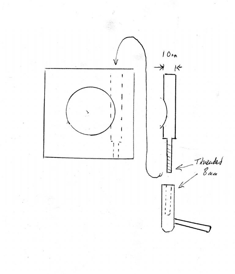

            Unfortunately, as I have already said. it is not possible to tighten bolt 84 sufficiently to lock the quill. I might try the "G" clamp idea. I did consider something along the lines of the sketch below. The only place this would go is on top of the lower casting, under the gear box assembly. As it would need to be 12 to 15mm thick, it would restrict the already puny Z axis travel to about half its current 30mm. The final option would be to make the cotter/locking pin anyway and hope find a part of the casting where one could drill a 10mm hole without compromising any thing else. This would involve a total strip down of the head assembly, which I would only do in the event of a major fault. The bearings shouldn't fail as I fitted a captive draw bar very early in it's time with me.
            I suppose I will just have to carry on holding the fine feed handle to prevent it moving, while winding the X or Y feed with the other hand.locking1.jpg

              I still think the best bet is to put some shim in between the quill and casting near bolt 84. Get a cheap set of feeler blades and try some of them to find out what thickness works best.
              Martin C

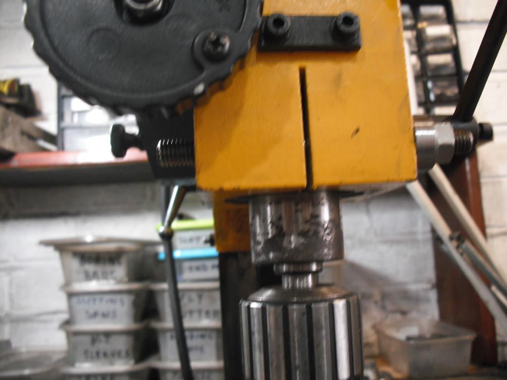

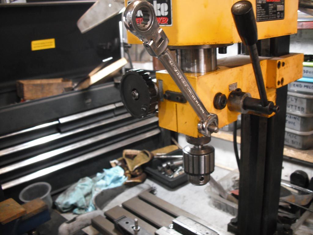

                          Thank you for all your suggestions gentlemen, I can now report success. I cut a length of 8mm threaded rod, which went all the way through the head casting. The bit sticking out on the left hand side would give me something to grab hold of if the rod sheared. On the right hand side I fitted a sleeve I made earlier, a washer and a standard 8mm nut.
                          I then used a BIG spanner on the nut and managed to lock the quill. No way I could have done it just using the allen key. I was quite surprised to find that it took less than 1/4 of a turn of the nut to go from fully locked to totally free. Thank you all once again.big_lever.jpg

                            That's good Anthony, glad you got it sussed, as a more permanent fix, how about a screw on plastic knob on an arm a bit shorter than the quill feed feed arm, you can give it a quick slap with the palm of your hand to tighten it up.

                                Looking at the pictures I understand now that there is M8 thread in the full left half of the casting?
                                The two halves are pulled together by screwing the bolt a little bit further into this long thread. This may cause a lot of friction.
                                In case of the Emco Compact 5 there is a M6 nut with a short thread with perhaps less friction so that less torque is needed to lock the quill
