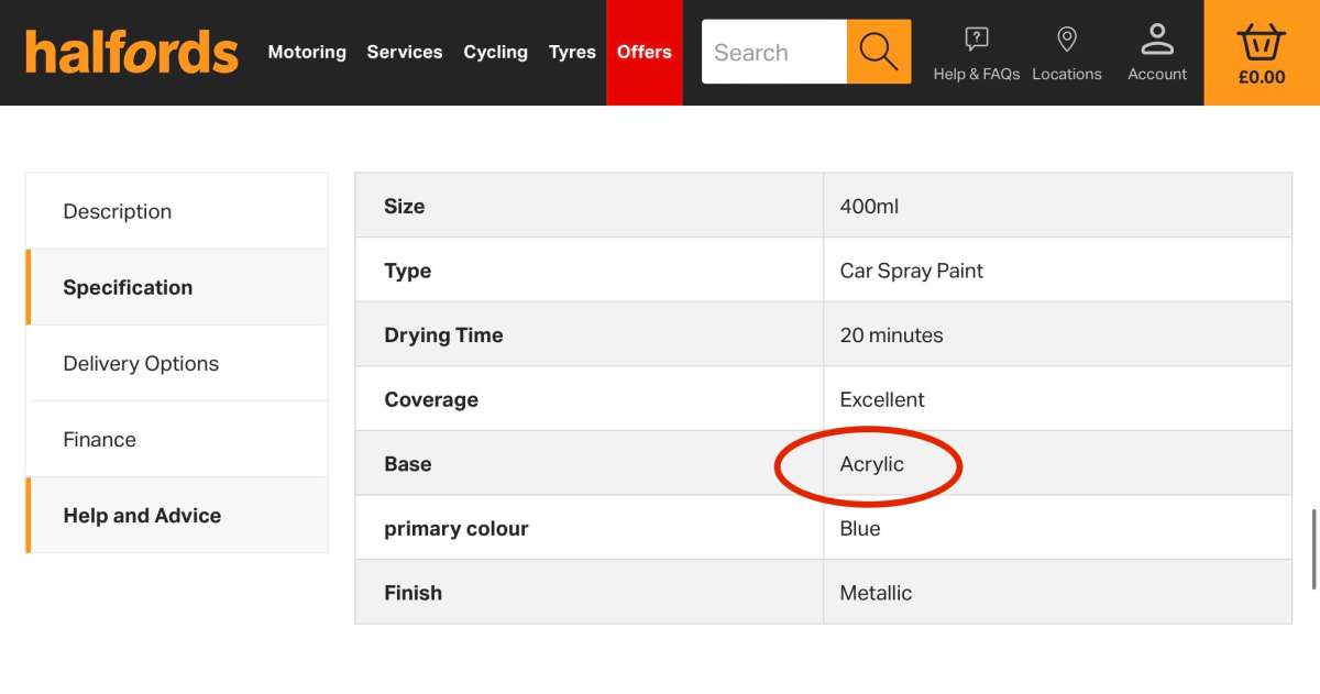

      #733507
        Halfords rattle cans aren’t oil based. The secret is to first know what you are dealing with 😉

            On SillyOldDuffer Said:
            As always, the answer depends!
            An oil-based paint, like wot comes in a Halford’s Can for touching up cars, is probably tolerant of oily residue left after partial cleaning.   But it won’t be tolerant of watery residue left after partial cleaning.   Conversely, a water-based paint won’t be too upset by watery residue, but it will be upset by an oily surface.
            I guess Arcylic paints behave more like water-based paints than oil, but don’t know.  Nor do I know what the various drying agents do when contaminated.   If the behaviour is uncertain, or it matters, do a proper job.
            The secret of perfect paintwork and glued joints is absolute cleanliness.   That said, if paint adheres without blemishing, and stays on for a few years, then, hurrah, that bodge clean was ‘good enough’.  Absolute cleanliness isn’t always essential.  Sad though, when a time consuming paint job bubbles, flakes, or rusts underneath after a year or two.
            Also depends on what the paint is supposed to achieve.   I mostly paint to provide light interior corrosion protection and to cover up embarrassing cosmetic flaws.  That’s much less critical than a serious paint job, intended to protect against all weathers for decades, or to satisfy Inspector Meticulous at a Gold Medal competition.
            IMG_0583

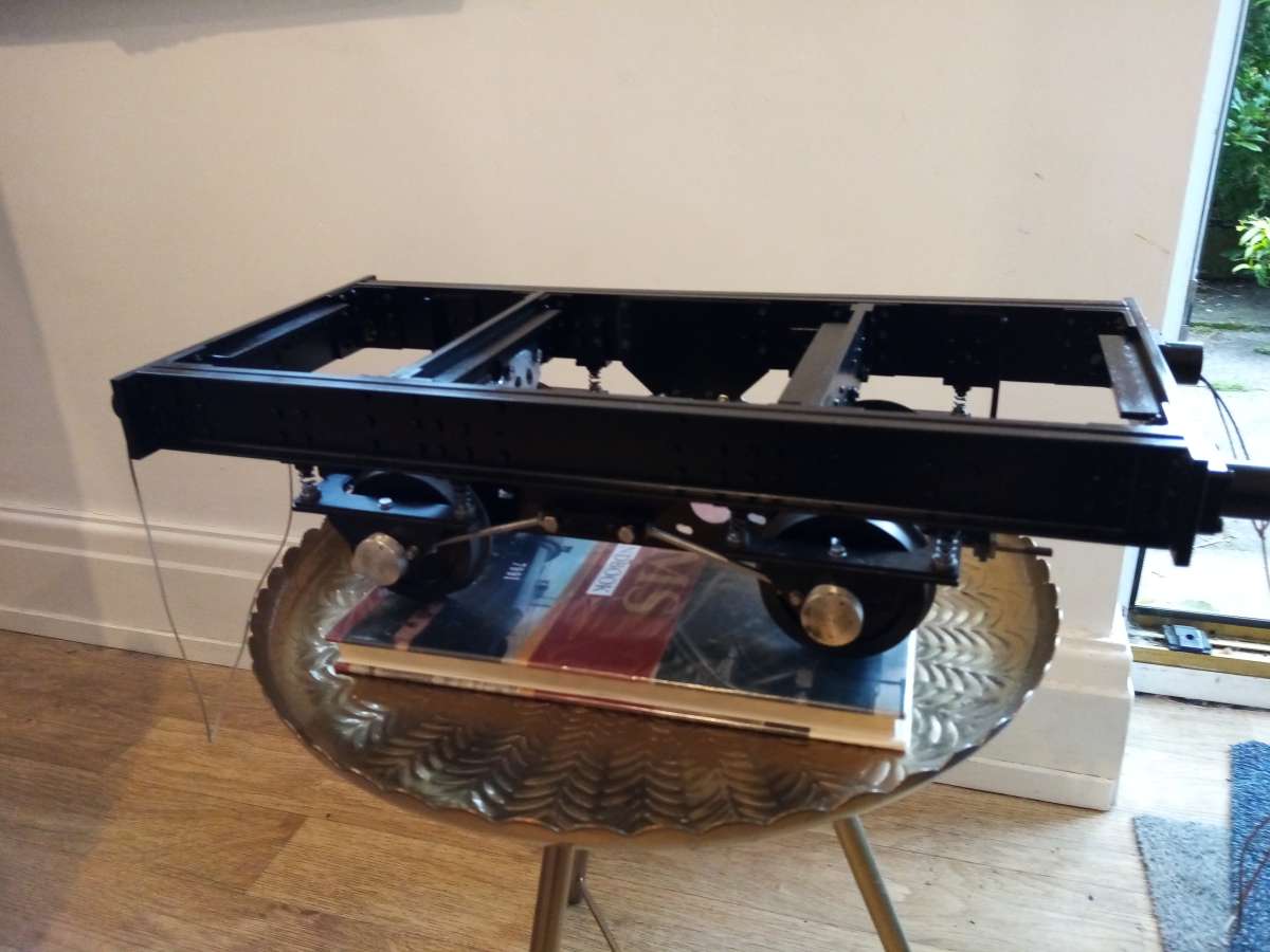

              #734390
              duncan webster 1
                @duncanwebster1
                  <li style=”text-align: left;”>So I wiped it down thoroughly with IPA, then sprayed it with Halford rattle can grey primer. Looked lovely. Left 24 hours and set about the top coat. Whilst shaking the can vigorously for 2 minutes I managed to drop it, the spray nozzle broke off, so back to Halford today for a new can, £12 worse off. Ah well, worse things happen at sea.
                #735516
                duncan webster 1
                  @duncanwebster1
                  So here it is in all it’s glory
                  chassis in black
