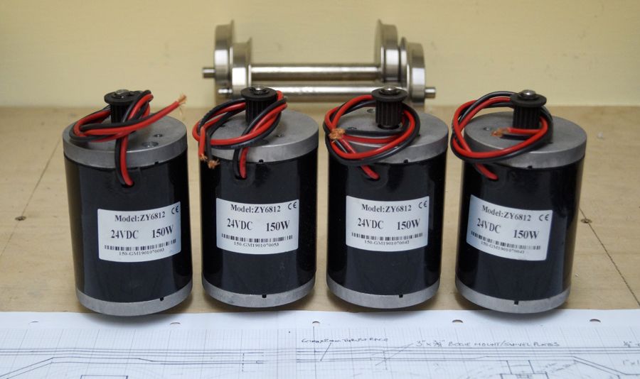

The motors I have decided on have arrived, they are Chinese and available from UK electric scooter suppliers. It was a no brainer really, a set of 4 motors for quite a bit less than the cost of a single UK manufactured motor of equivalent spec. They are listed as 24 volt, 150 watt, 6.25 amp with a no load speed of 2750 rpm and come fitted with a 3mm – 16T belt pulley. They have twin ball races and having taken one apart look to be well made.
There is a question mark over the quoted figures though and I had a "technical conversation" with the supplier. He said: great motor, loads of power. Me: is the 150 watts input or output..? Him: silence, then "input" Me: it would have been better if the 150 watts was output. Him, silence again then, erm, no it must be output, loads of power……LOL
Anyway I read all the user reviews I could find and they all said the motor gives good power and is reliable. One guy thought the 150 watts was about right, based on what though I dont know. Another said probably a bit lower at 100-125. One guy uses one to power a watch makers lathe and he thought at least 150 watts but without proper testing who knows..?
Not knowing the actual figures leads to a bit of guesstimation and gut feeling when making calculations, gear ratio,s for instance. The quoted no load speed is 2750 but the motors I have are within 150 rpm of each other (which is good) averaging out at 4050 rpm.
Now 4050 rpm is quite a bit faster than 2750 so I have estimated a loaded speed and geared at 4.25/1 to achieve a loco speed of 6mph. Will have to see how it comes out in the wash but should I need to change the ratio I can easily change the motor pulley size up or down, hopefully I wont need to.
I was also thinking that one of these motors could be a good candidate for building a power drive for the mill table, doubt I will ever get around to it though.

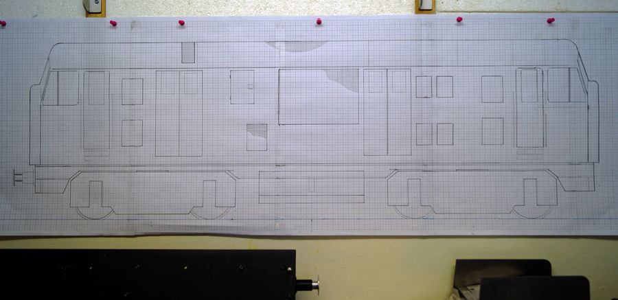

Not too good a photo of it but I sketched up the loco to get a feel for the size, twice as long (45 inches) as the 0-4-0 shunter. Looks as if it will lend itself to some good detail though over 20 fine grid vent panels may prove to be fun, it would be good if I can find some off the shelf material for those. Waiting the arrival of some metal and then I can make a start on the chassis.
Click picture to enlarge.

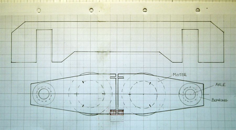

Another sketch showing a design change to the bogie and motor mounts, I,m sure that the previous design for the bogies would have worked well enough but I wasnt happy with the shape and the way they looked. The bogie side plates were too deep top to bottom but that came about with mounting the motors to the plates.
The sketch below shows the plates more to the shape they should be though this wouldnt allow for fixing the motors to them, well not without some bracketry but I dont fancy that. So I have looked at axle mounting the motors, I did this on the 0-4-0 and it worked out well. The 0-4-0 has a single plate running on the axle with a motor mounted each side, I used tie bars and nylon guide rollers to retain (prevent rotation) of the plate whilst allowing the plate vertical movement with the sprung axle.
I dont have the space to do the same with the new shape bogie side plates so I have come up with the idea as seen in the sketch, with the limited space the problem was how to retain the motor plates whilst allowing for the vertical travel of the axle. The pair of plates would be sized and centered to leave a 3mm gap between them this would allow for a small amount of movement and retained to each other via a pair of strong compression springs, I have left off the top spring for clarity. The motors and motor plates will still protrude down past the bogie side plates but they will be inset by 25mm so shouldnt be too obvious. I think this should work but if I am missing the obvious please shout.
The usual way to prevent motor assemblies rotating around the wheel axles is by tie bars from the motor mount to the fixed bit of bogie. It is also better to have the pull point from the bogies to the main frame as low as possible to reduce weight transfer. Can you not have the motors higher, protruding from the top of the bogie frame, they would be inside the body

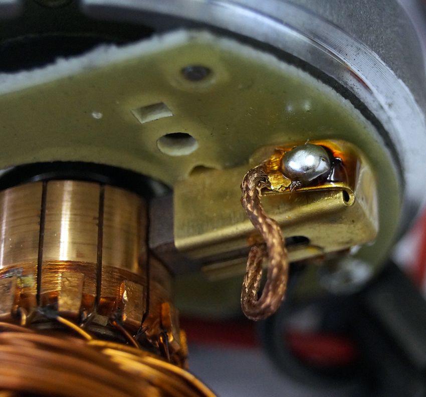

The 4 motors need a couple of mods, the first is soldering the brush wires. The wires are crimped in place under a tab and quite secure actually but I have gone belt and braces and soldered them just in case.

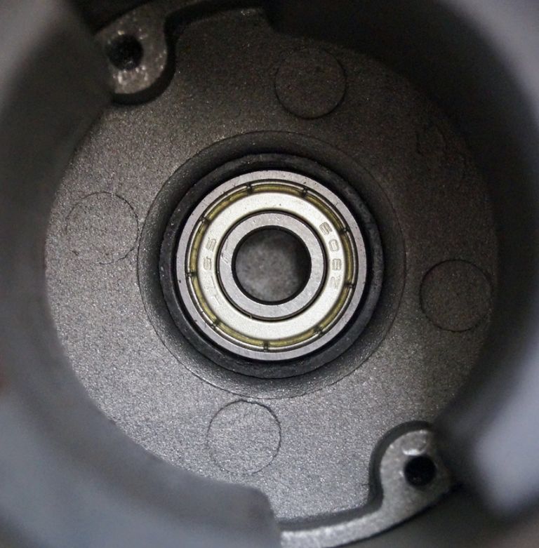

The motors will be sandwiched between a pair of mounting plates but there is only mounting holes (3 x M5) in the output shaft end casing. The rear end casing needs holes adding but the casing is cast aluminium and only 2.5mm thick, so I am going to drill and thread M5 and fix the screws in from the inside using retainer. There will be plenty of clearance between the screw heads and the armature and it will leave threaded studs on the outside for fixing to the plate using nuts, should be ok.
