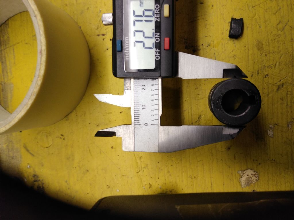

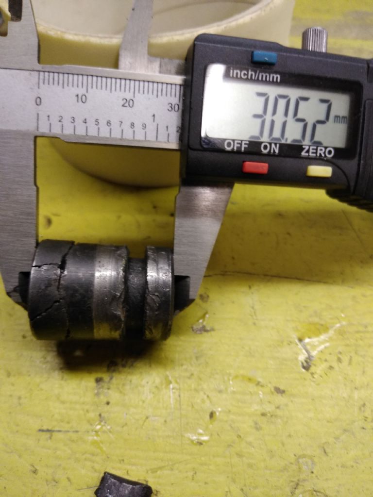

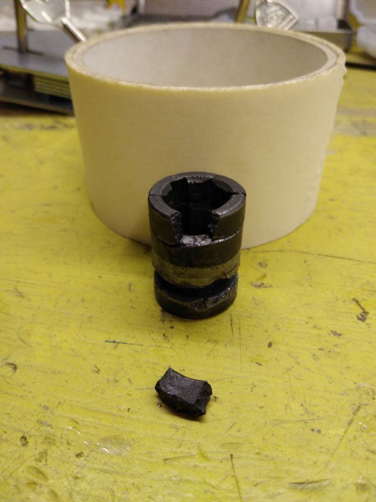

      Hi
      I am looking to purchase a spare part for my Clarke CL500M lathe, please see photos in the attachment. As you can see the part has shattered and pieced back together for better viewing.
      Due to lack of detail on the Clarke pdf file I am unable to zoom in for the correct part I require. As such I have now received 2 incorrect parts from machine mart. These parts were from the gear train. 32 Spline Housing HT3000300232 and 18 Hex Socket Sliding Bush HT3000300118.
      The auto feed is not engaging on my lathe which is why I assumed the part to be under the gear train category (PDF). Perhaps this may not be the case? I and another engineer have looked through the PDF file and we cannot see this part listed. I am hoping someone can help me with this as it is a very important that the gear train/auto feed is working correctly on my lathe.
      I have emailed Clarke and received no reply. I have also emailed machine mart but as above have received incorrect parts.
      Cheers Richard

              #503485
              Richard Callaghan 1
                @richardcallaghan1
                I managed to get this part from machine mart in the end. it was listed under the wrong part. good job really as Clarke never answered any of my emails.

                      #505351
                      Richard Callaghan 1
                        @richardcallaghan1
                        The lathe was bought as spares or repair. It was from a teaching trust so I think some student must have done this somewhere along the line. I took a bit of a gamble when buying. Hopefully its paid off.
                        This part is cast. I think it is made like this to act as a weak link and not damage any other parts further in the lathe? It was the last one left in stock otherwise I would have got a spare. My lathe is running now and the screw threading is working. I just have to make a space for it to live before I can get to use it properly.

                                      bernard towers
                                        @bernardtowers37738
                                        Somebody mentioned that the part is cast but its more likely to be sintered as its easier to make in quantity and that's probably why its broken in that manner.
