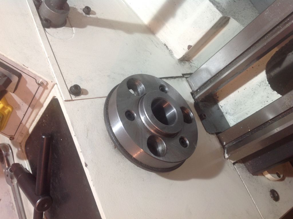

      Ooops, I've taken a smidgen too much from the nose hole of a backing plate I was making.
      Should I/Can I
      a: shim it (beer can fits great)
      b: make hole bigger amd sleeve it/loctite
      c: bin it

          a or b.
          not c!
          I made one of my back plates oversize to the register to allow for fine tuning of run out.

            I've always made the hole as snug as possible because it seemed to me that was how it should be. One of my original Myford supplied chucks was so tight it needed a light scrape before it would fit the spindle. I read several arguments about the fit, more than one stated that the hole should not be a close fit because the register was the back face and not the bore, the thread took care of centralising the chuck. Several of the aftermarket backplates I've bought are a good rattling fit despite which the chucks seem to fit with acceptable run out (for a 3 jaw chuck).
            I wouldn't worry to much about a smidgin but you need to keep it below a gnat's whisker.

              If the spindle is threaded (you didn't say so) then just screw it on a few times to settle it down and then true up the front face ready for the chuck. I have a number of screwed on backplates with registers from 0.0005" clearance to well over 0.010" slop, and they all run true and repeat.

                Hi Paul I would bore out and bush the hole as it is the location that matters. Use the same material, cast iron and Locktite as well as a life press fit then Finnish bore after finishing.

                  +1 for sleeve and rebore, I have always understood that the backplate should be a close fit on the nose register. The thread should be slightly loose to let the register faces do their work. I always bore and face the register surfaces at same setup and cut the thread to ensure they are true to each other, then mount on the nose and machine the chuck register. This seems to work for me. If the register is too tight on the nose then it will wear the nose.

                    Not threaded, it's for a DB10 Super.  A slight lapse in concentration and I took 0.2mm off instead of 0.02mm, must try harder as my school reports used to point out.
                    David is right in that it is this part that determines the position of the chuck, register is a push fit but the slack from behind it would throw the chuck out.
                    Bore out and bush it is then.

                      Yet another vote for bore out and sleeve it, before boring to size

                        Now it is revealed in its true form, I'm in the sleeve and bore camp, it should be fairly straightforward. If the sleeve is to be thin walled when in place, it would be easier to bore the backplate to the required size and make a fairly thick walled bush. Fit the bush and bore to size. The backplate then keeps the bush round when you finish bore it. Thin walled bushes are difficult to hold without distorting them.
                        Do check first that the projecting spigot on the spindle is parallel and not tapered.
