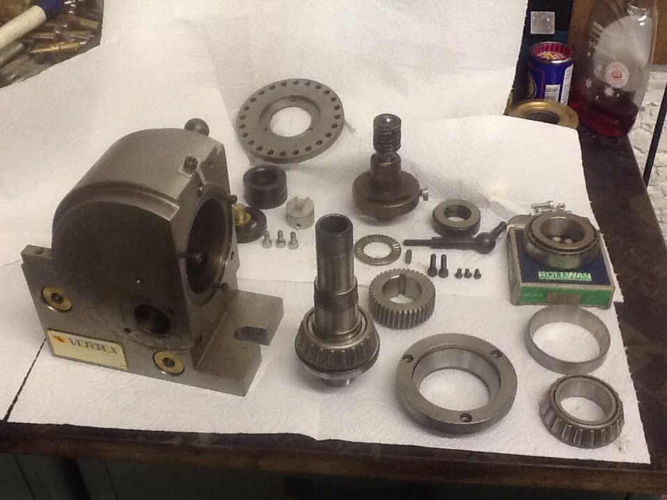

                    I don't think you have to worry too much about the quality of the Chinese made BS0 dividing heads, they look fine to me. It must be almost twenty years ago when I bought my Vertex BS0 from Chronos at either the Harrogate or Donnington show and I am sure back then it cost £199, it came with a tailstock, division plates and a chuck back plate but no chuck.
                    The internals of the Chinese heads are identical to those in my Vertex, and I am not certain that my Vertex BS0 was made in Taiwan, it could also have been made in China, so there is probably no need to search for a Vertex branded dividing head anyway.
                    The spindle has a taper roller bearing at the front, with a radial plain bearing at the rear together with a needle roller thrust bearing.. After checking it over my dividing head sat unused for years from new, when I finally came to use it the spindle seemed a little tight. Dismantling revealed rather too much spindle preload had been applied at the factory. Although it was quite clean inside the factory applied grease was becoming a little dry, so it is worth the effort to dismantle them to ensure they are clean, properly lubricated and adjusted.

                      Thanks Jack, interesting to see the guts of the beast, I'd found exploded diagrams, so that's most helpful. I read somewhere that someone had torn their new one down and fitted quality branded bearings but if the shafts aren't concentric that could be a waste.
