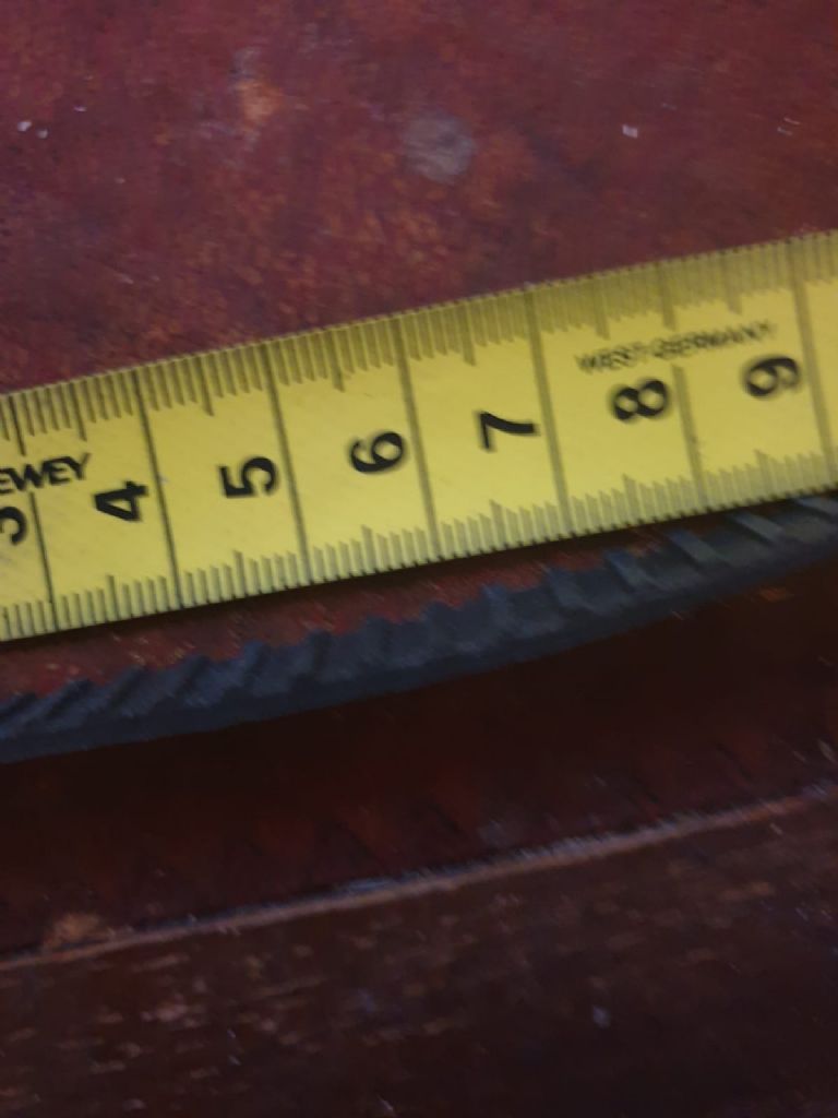

      Hi Jason,
      I think it may be better if Brian confirms this measurement by using string or tape round the two pulleys in place of the belt before he orders one.

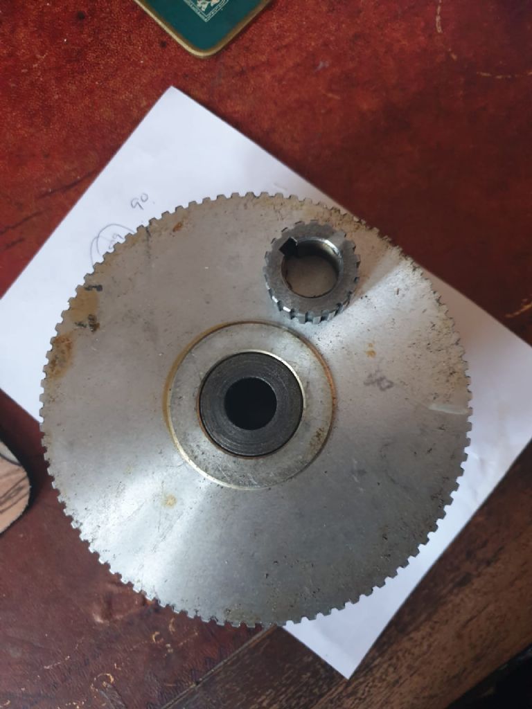

            #518254
              So lets assume that his measurements were the OD of the pully. Teeth are approx 1mm high so lets say the PCD is half way.
              This then give PCD diameters of 129 and 27 and that works with a 1.5X belt so now we need Brian to check and see if the tooth count is 86/18
              #518255
                It is also important to note the location of the pitch circle [d suffix o] … which is beyond the teeth of the pulley, in the line of the reinforcing cords in the belt.
                See diagram in the link
                #518261
                  So that could make it more like 88/19T if we stick with the 1.5X

                  Brian Bassett
                    @brianbassett83323
                    Large gear is 90 teeth small gear 19 teeth

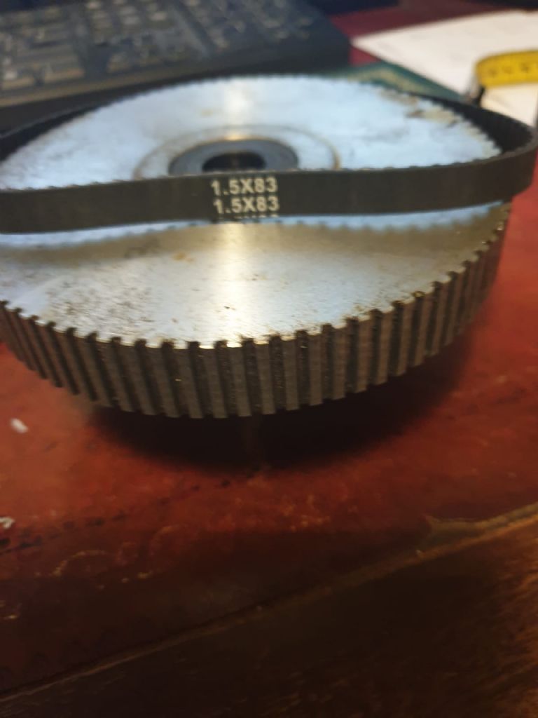

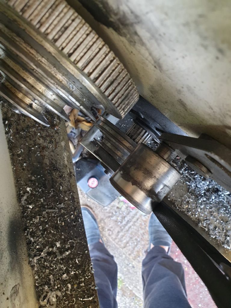

                          Brian Bassett

                                Posted by Brian Bassett on 09/01/2021 18:00:15:
                                **LINK**
                                https://www.arceurotrade.co.uk/Catalogue/Machine-Spares/C1-Lathe-Spares/C1-131-Timing-Belt/C1-131-Timing-Belt-158310-C1-131
                                Might be a close approximation to what yours was, Brian
                                … or is that the one with the correct pitch but the wrong number of teeth ?
                                Edited By Michael Gilligan on 09/01/2021 18:26:33
                                #518735
                                Brian Bassett
                                  @brianbassett83323
                                  Wrong belt to small but pitch looks fine,i think the belt i need is
                                  c6-944 1.5x124x15
