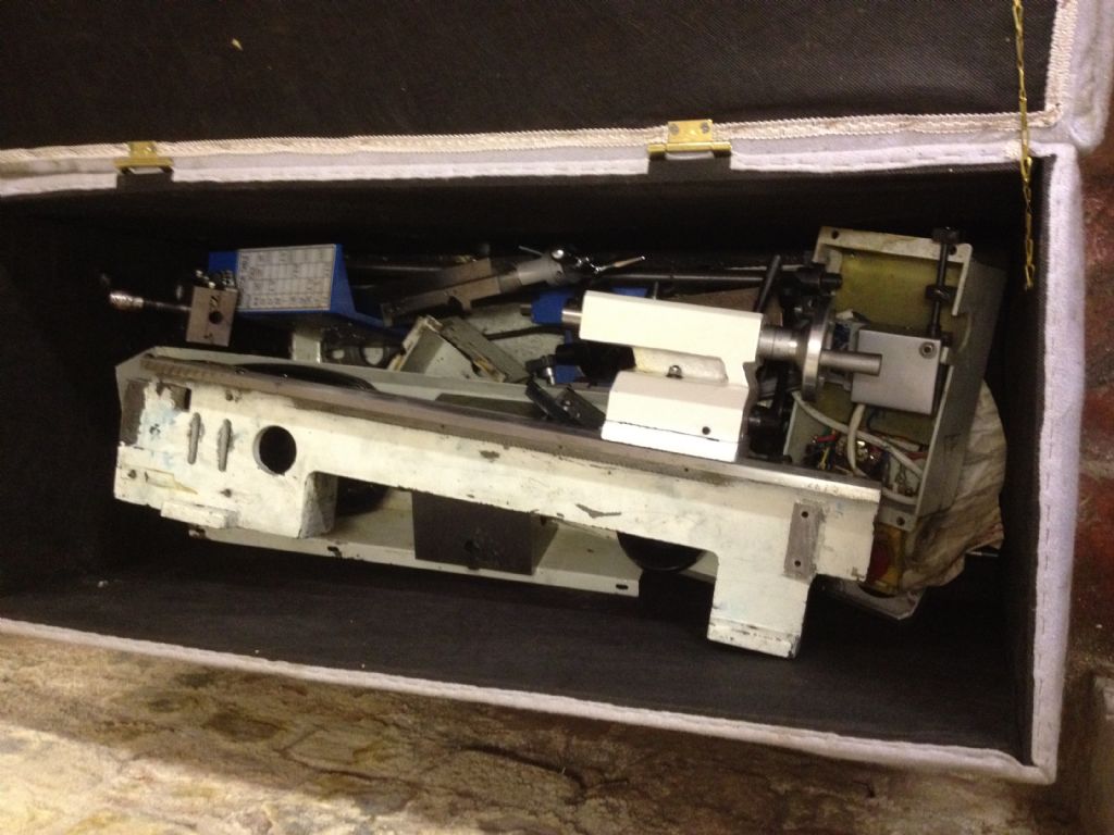

      I'm currently rebuilding a little Chester Conquest lathe that has been seriously abused by someone in the past! I realise with the time I'm spending and the parts I have purchsed it probably isn't worth it. Saying that once I'm finished it will hopefully be a cracking little lathe. So anyone got any tips on what i should modify / do to make it a worth while project. 1 reason for doing this rebuild is the fact that i hate to see machines get scrapped.
      Cheers Mex

              Here's a clue to what I'm starting with
              Is any one interested in me running a post on what I do and How I get on ?

                    Cripes Mex,
                    Throw bits ina box and drop teh bed on top – was the previous owner cross with it?
                    I'm hoping that you have a headstock in there!
                    #95537
                    Mexican jon
                      @mexicanjon
                      Posted by Stub Mandrel on 01/08/2012 20:36:02:
                      Cripes Mex,
                      Hi Neil
                      Been through the box and all the main parts are there smiley it looks like someone had ideas above their capabilities and made a mess of it! I've had most of the bits out and blued the head stock saddle etc. and being that i have a good machine shop already i believe i can get it back to an accurate usuable lathe. As I've said I couldn't see it go in the scrap bin as that just goes against what i believe. So watch this space. The other thing I looked at is ignoring my time It will probably stand me in at less than a cheap import out of the box that would need a load of work to be at the standard i hope this will be by the time i finish. Once I finish the machining and setting up I'll probably strip and repaint and then rebuild for a final time.
                      Regards Mex
