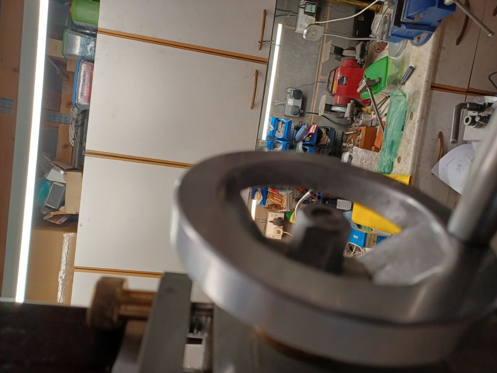

      Hi, I have a Chester Champion 16VS mill, which looking at to fit power feed to the height (Z) adjustment for the mill head. The crank handle on top, as well as being keyed to the shaft, is held on with long 16 mm nut. A 16 mm grub screw is screwed into the top of this nut, the grub screw is not listed on the parts list or appear in the exploded diagram. Does anyone know the purpose of the grub screw?

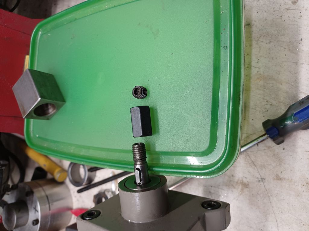

                  Hi I just had a look at the original parts for my mill. It has a long nut and grub screw. To adjust the thrust bearings on the z Axis you unscrew the grub screw a little way then tighten the long nut till there is no play then holding the long nut still with a spanner and tighten the grub screw to stop the nut unscrewing. If you do it this way you don't overtighten the thrust bearings and the nut won't unscrew and you could use s socket to drive the z Axis.

                    These pictures.
                    David

                      David, thank you for your reply and photos, it now makes sense, I was weary about disregarding the grub screw. Will now have a rethink, as regard coupling design.
