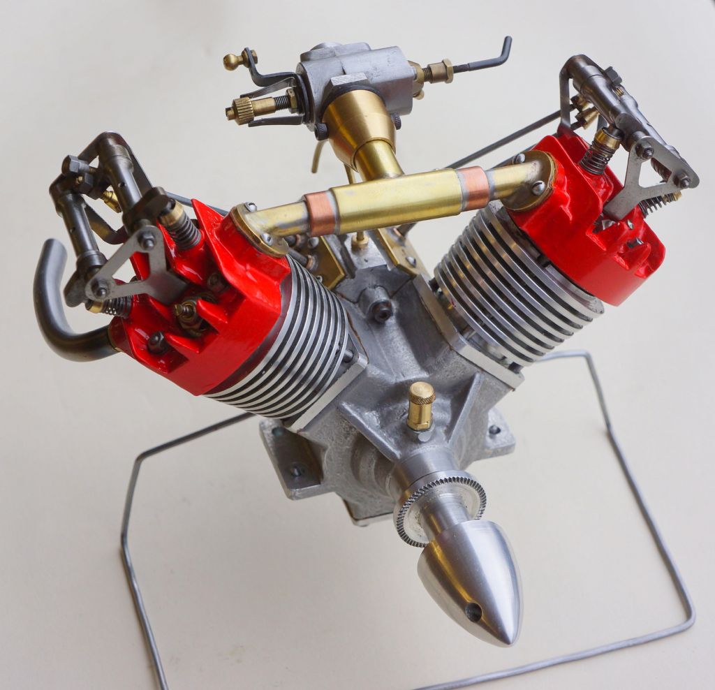

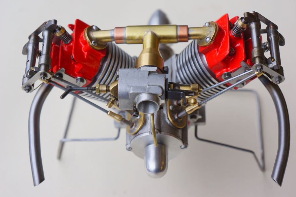

        Two pictures of my completed Chenery Aero Vee-Twin.
        Stats for the interested-Some 2000 hours of workshop time over a two year period. All machining carried out on a well "tuned" Clark Mini lathe and a Warco WM 14 mill,with self fitted DRO.Material kit and drawings from Hemingway kits.
        All work is to the drawings supplied and no modifications were introduced.
        I havnt fired it up yet as I have resisted the urge and am making a respectable
        test bench for it. Perhaps next week we will hear what sort of noise it makes

            Yes, they are there if you click on "2 photos" i had a suspicion that all was not well , as this is my first time of uploading pics.

                  Good looking engine, there is something about redwink
                  I have put the photos in your post.

                        Thank you all for your comments and thank you Jason for adding the photos to my post. I would be interested in knowing where I went wrong.
                        The red heads are painted. I tested several high temperature paints and the only one I found to be methanol proof also was Halfords own brand High Temp Paint, in a tin . The aerosol version is not methanol proof/

                            No Aimed at me, I have a bit of a reputation for painting engines red, hence the title of this build thread, Ramon tends to pull my leg about it. And you know there is a very nice red lightweight on the web though I have something brighter in mind for that
                            In my defence the original engines all the models were based on were red.embarrassed

                                    The engine startled me in firing first squeeze on the starter, but it would not run for much more than 30 seconds and stopped if I switched off the power to the glow plugs. It was originally designed for spark ignition, but is supposed to be OK on glow. Compression was not good as designed, so I re-machined .030" off each head, which certainly improved things,but it then kept blowing a gasket. One of the weak points as designed, is that you cannot get at the head nuts with the rocker gear in place, so you are unable to re-tighten after a run.Higher compression also required a change in the timing and this is still a subject of experiment.
                                    I eventually solved the head tightening by making long nuts for each head so they are now high enough to get a spanner on and this has stopped the gasket blowing problem.
                                    I have changed the carb too from that in the photos and now have a clone of an OS 35 carb fitted.
