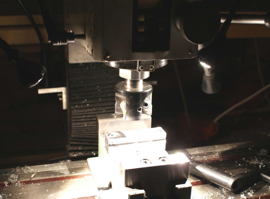

      Professional machine worklights tends to be very expensive for the home workshop. Now, LED-lamps can be a very good alternative, like this lamp I found at Ikea in Norway. It is called "Jansjo" and costs £10 in the UK.
      The advantage with this lamp – apart from the low cost, is that it is a a low-voltage lamp (6 V, 3W I think, safe voltage for swarf) and its long flexible gooseneck.

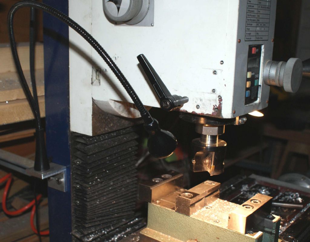

      Here is how I mounted it on my milling machine:
      And here a view of how strong the light is with two of these lamps:
      I think I will fit my lathe with a lamp or two!
      Regards Sverre

          Sverre, I use them on my lathe and mill. They are good as they are not too large and don't get in the way and at the same time bright enough to give a good working light.
