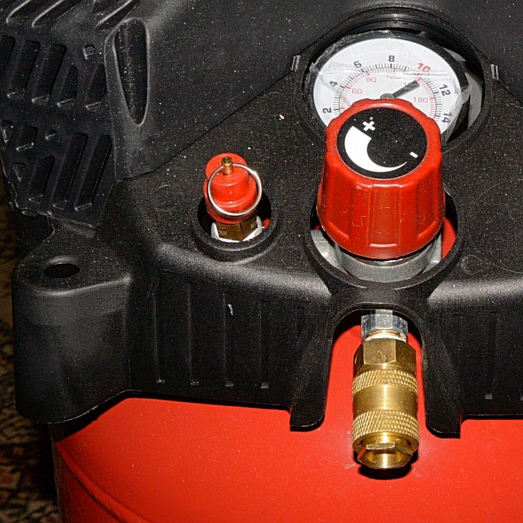

          For anyone is mad enough to buy a hobby compressor that should give 100l/min at 4 bar and costs in my case a touch over £100 I've modified it a bit.
          There was no filter or drier on it or output gauge. I was going to fix that with bent pipe and compression fittings. I nosed around and found Aroplus in Redditch. They stock a huge range of fittings for this sort of thing. Some items take a day to arrive but no min order and I could collect so no postage charge. Turns out it could be done with various BSP fillings.
          The reservoir is vertical on this one so doesn't take up much floor space. The air outlet comes like this.
          It's angled down which is why I though bend pipe.
          Finished up like this.
          The fitting on the right of the filter is a breakable joint. Sort of nipple thing with an O ring on the nipple so can be rotated as needed and tilted a bit. The hole in the plastic to the left of the first shot will probably be needed to add a bracket to stop the stuff tilting when the line air line is pulled but it seems solid enough.
          blushI aught to tidy up the ptfe tape.
          Not sure if it's a mad purchase really. If I graft a twin cylinder pump and motor onto it total costs are probably lower than buying one like that. Actually it might save getting on for £100 and in any case might be ok anyway. It'll look a bit odd if changed but still take up little floor space.
