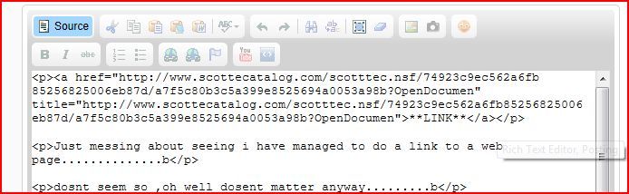

                        #273666
                        bodge
                          @bodge
                          **LINK**
                          Just messing about seeing i have managed to do a link to a web page…………..b
                          dosnt seem so ,oh well dosent matter anyway………b
                          Edited By bodge on 25/12/2016 11:38:46

                          #273667
                          peak4
                            @peak4
                            Posted by bodge on 25/12/2016 11:36:23:
                            **LINK**
                            Almost, you just missed the last "t" off the very end of the link when you were copying it   ………..document;
                            **LINK**
                            It should have looked like this, but without the space between
                            www. and scottec………………….
                            I added the space so the forum software didn't recognise it as a link.
                            http:// www. scottecatalog.com/scotttec.nsf/74923c9ec562a6fb85256825006eb87d/a7f5c80b3c5a399e8525694a0053a98b?OpenDocument
                            Edited By peak4 on 25/12/2016 11:47:35

                              #273670
                                Don't give up, bodge
                                You just need to be sure that you select the whole of the URL
                                see post by peak4
                                This is the full URL:
                                http://www.scottecatalog.com/scotttec.nsf/74923c9ec562a6fb85256825006eb87d/a7f5c80b3c5a399e8525694a0053a98b?OpenDocument
                                Edited By Michael Gilligan on 25/12/2016 11:56:59

                                  #273672
                                  Les Jones 1
                                    @lesjones1
                                    Your link has the last few characters missing. Maybe there is a limit to the length of the URL.
                                    Link
                                    I can't get the link that I have inserted to work. There seems to be nothing pasted into the link.
                                    I have now found out why. there was a space between the www. and the rest of the URL
                                    Les.
                                    Edited By Les Jones 1 on 25/12/2016 12:00:40
                                    Edited By Les Jones 1 on 25/12/2016 12:01:53
                                    Edited By Les Jones 1 on 25/12/2016 12:03:14
                                    Edited By Les Jones 1 on 25/12/2016 12:07:41
                                    Edited By Les Jones 1 on 25/12/2016 12:09:26
                                    Edited By Les Jones 1 on 25/12/2016 12:10:27

                                      #273674
                                        No limit to URL length, not only was the last letter missing but it had been pasted twice, I have altered the link on Badge's post timed 11.47.
                                        Edited By JasonB on 25/12/2016 12:11:25

                                          #273678
                                          bodge
                                            @bodge
                                            Hi Jason
                                            I dont think i posted twice , one was the page Micheal linked to the " two stage reg page" , the second attempt was to the the company home page because i thought i had gone about it the wrong way , which i had twice! no less !!
                                            Pretty sure i got it now , must make sure everything matches in the URL box……….b
                                            Well all the links go to the page i was trying to link to now , so will just check the procedure a time or two to see i got i right , just wont hit the post button,…. till. the next time i see something to link to……..b
                                            Edited By bodge on 25/12/2016 13:00:58
                                            Yes i think i got it , i should scrolled the address bar line along a bit to catch those last couple of letters, then pasted to the URL ………….b
                                            Hi Jason not sure how that happened , i guess i must have got something else wrong too ! …..any idea what i got wrong? i"m guessing i must have double tapped some where !……….b
                                            Edited By bodge on 25/12/2016 13:13:37
                                            Edited By bodge on 25/12/2016 13:22:13
                                            #273680
                                              As you can see the URL was in there twice
                                              #273681
