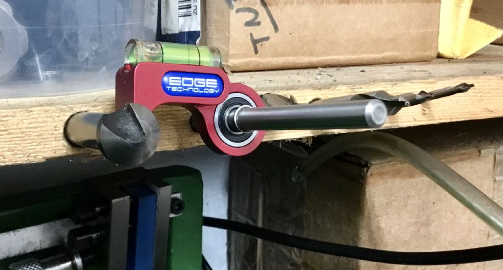

                              OuBallie
                                @ouballie
                                Both tools are best one I’ve ever had:
                                Countersink & Tool height setting
                                The other tool is for setting lathe tool height and is perfect.
                                Geoff – Workshop 25°, outside 30°+
