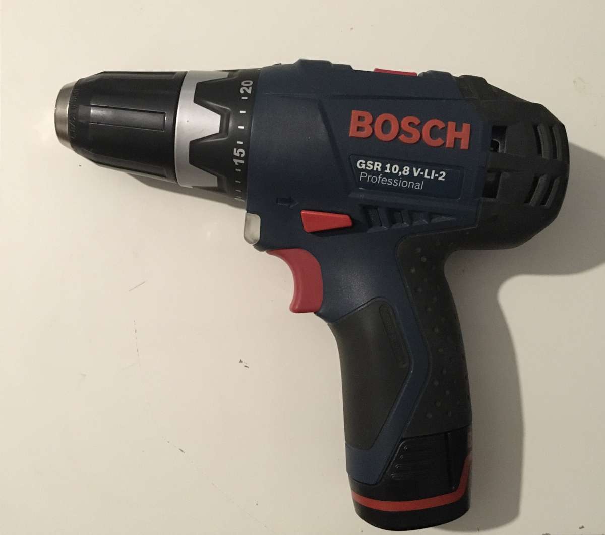

                        #744214
                          Robert
                          Do you recall which Rohm model you used ?
                          The chuck on my otherwise-lovely Bosch GDR 10,8 has always had too much run-out.

                                Sorry, I quoted the wrong code for the drill … GDR is the impact driver
                                Here’s the drill:
                                IMG_9984
                                https://docs.rs-online.com/5765/0900766b80da5644.pdf

                                  DC31k
                                    @dc31k
                                    On Michael Gilligan Said:
                                    Here’s the drill:
                                    I hope I am not trying to teach you to suck eggs here, but remove the old chuck and look at it before going too far in selecting the new one.
                                    In particular, the back end of the chuck is likely to be more or less recessed under the silver plastic in your photo. That means the diameter of the new chuck has to be compatible with (or fit inside) the silver ‘hole’. Depending on the depth of the hole, for example, it might obscure the locking collar on the Rohm one shown above.
                                    With Bosch tools, there is a multi-digit number on the label. That is useful for identifying the tool on spares sites (where you would find an exploded digram allowing you to consider the points above without disassembly). I think it is this one:
                                    https://www.boschtoolservice.com/gb/en/boschprof/spareparts/gsr-12v-15-3601H68100
                                    and the number here is 3 601 H68 100 (check your own to confirm). The chuck is custom-made for the machine and fitting a standard chuck might leave a gap at the interface between chuck and machine.
                                    There is also a small chance that the chuck will be 3/8″ UNF thread because it is a low powered model, so best to verify.
                                    #744246
                                      Here’s the drill:
                                      I hope I am not trying to teach you to suck eggs here, but remove the old chuck and look at it before going too far […]
                                      No problem with sharing wisdom … It’s an open forum and [with perhaps a very few exceptions] we’re all here to learn from the egg-sucking of others.
                                      In this instance “going too far” would equate to spending money … hence my simple request for information.
                                      The run-out is only really a problem with small diameter drills, and in truth I would probably do better by lapping the jaws than running the risk of another disappointing purchase.
                                      Thanks
