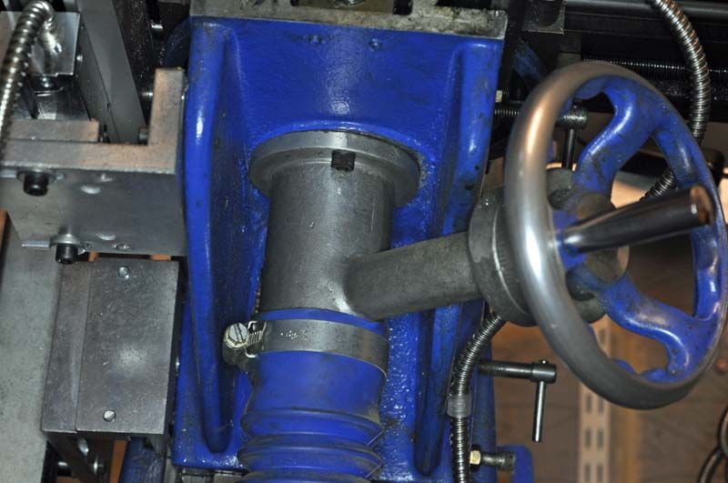

                Hi Sean,
                This is the table raising arrangement on my Sharp MkII milling machine.
                Under the gaiter there is a 10 tpi 1/2" ACME screw that moves with the table and projects through the mill base. I don't know for sure what happens inside the gear box but I suspect it is like Martin's jack. One rotation of the handwheel raises the table 1/10".
                HTH,

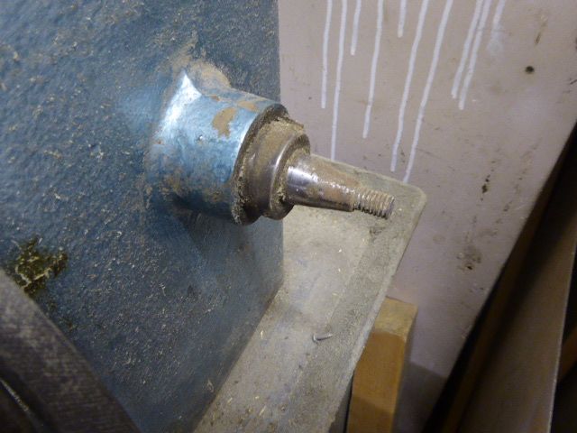

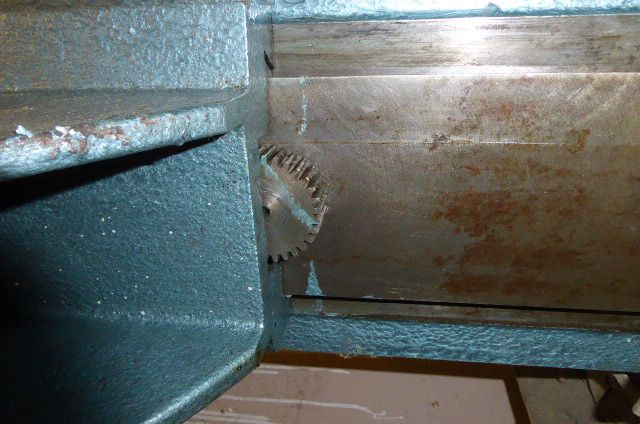

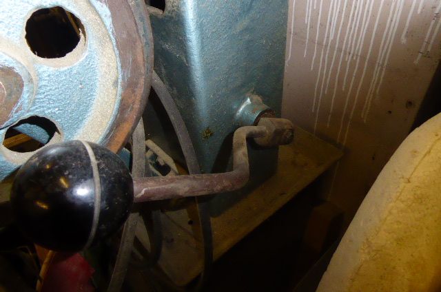

                                                    Hi. I'm fairly new to the forum so I missed the original posts. I have a Centec 2 that I aquired several years ago with the aim of restoring.
                                                    The knee adustment on mine is by a pinon operating on a rack inside the knee, This is attached to a shaft that passes right through the head stock and terminates in a taper onto which a handle fits. This all looks original.
                                                    It would be quite easy to fit a graduated hand wheel in place of the handle. But I do have the much sort after quill feed vertical head.p1000392.jpgp1000389.jpg
