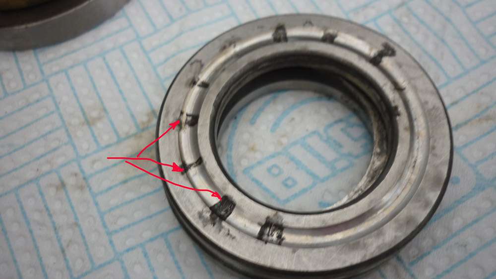

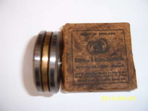

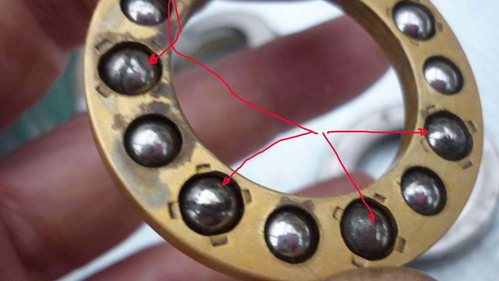

                          Different mill ,different bearings but i replaced some bearings in my alexander , it hadnt been used for years but i managed to find some old unused Hofmann bearings on ebay.The bearing were rusted and pitted due to lack of use for years and lack of oil/grease.So it is worth checking the bearings if your taking the head apart.
                          The grease i used was called Kluber isoflex NBU 15 ,expensive for a small tube but hardly used much.
