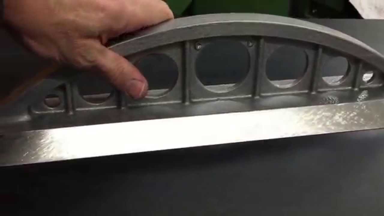

                              Pete Rimmer generously gave me some hands-on scraping instruction, lent me one of his camelback straight edges, and even checked out my surface plate to get me ready for the next steps. It’s great to see that kind people are still willing to help others learn and improve.
                              The hardest tool to source was a scraper, but I’ve now got a Sandvik Coromant 25mm carbide scraper, a diamond grinder setup, and I’m ready to get to work!

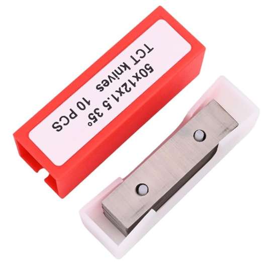

                                Graham, in case you find the Sandvik scraper a bit too big for the dovetails, I found these carbide blades seemed to hold an edge OK.
                                I cut a length off and brazed it onto a length of stainless bar, topped with a file handle.
                                This is an Amazon link, just to show the style of the ones I bought, but obviously I can’t be sure that this is the same grade of carbide.
                                I wasted a lot of time trying to source a suitable lump of carbide when I should have just gone out and bought the same blade as you, though it was all a bit more difficult during lockdown.
                                I had various carbide pieces in stock, but found that many, whilst tough, would not take, or hold a fine enough edge.
                                The various eBay links at the moment all seem more expensive and in China

                                  Those TCT Knives are used in wood machining, rebate blocks etc, and are widely available from woodworking machinery suppliers and sharpening services. Many other sizes are available.
                                  One of the sharpening services I used to use, used to collect the blunt ones, re-grind them, and sell them on for decorators paint scrapers.
                                  If you are near a Joinery Manufacturer/wood machinist you could probably get used ones for free, they will need re-sharpening though.
