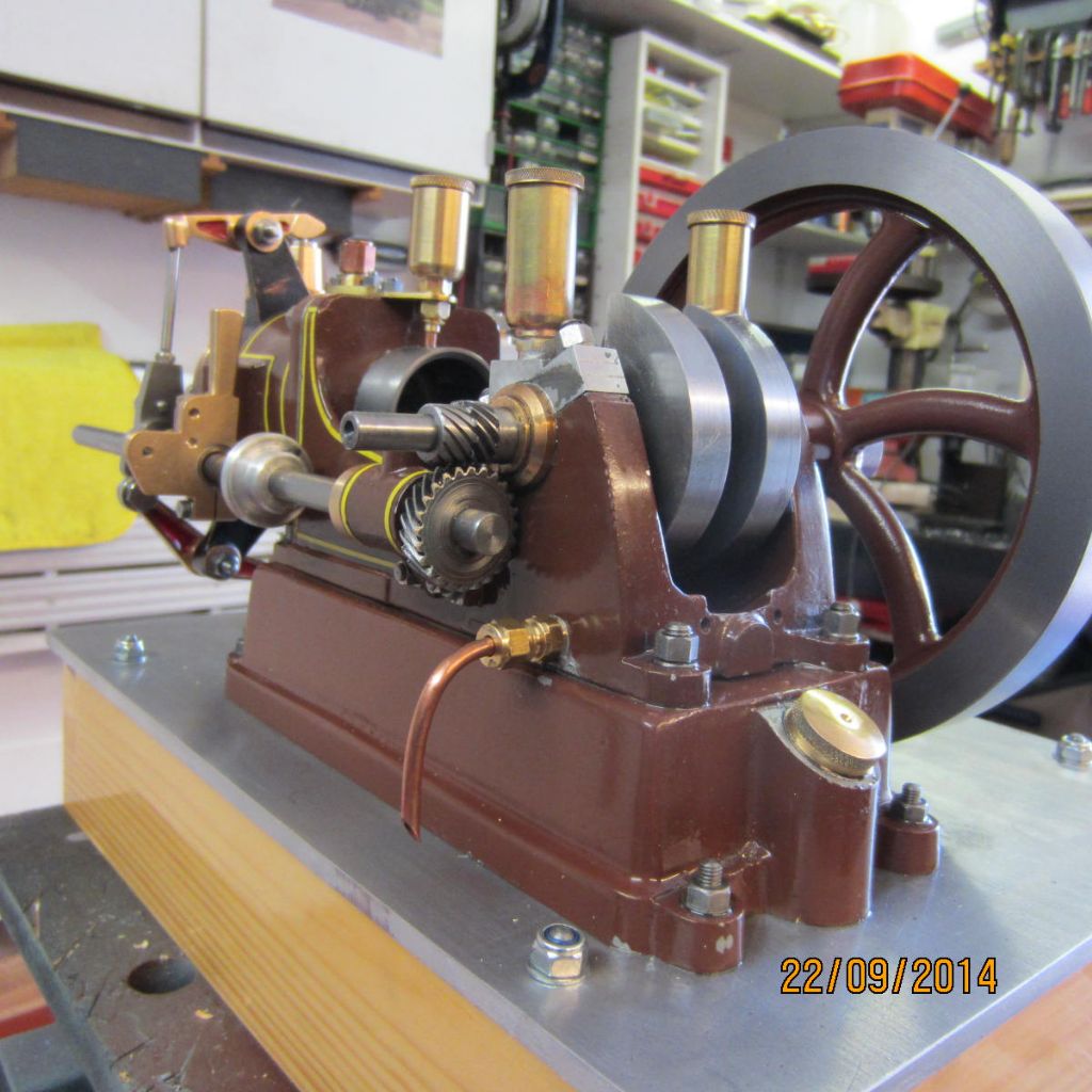

        I have got involved in finishing a second hand Centaur Gas Engine, that a friend has bought. Has anyone out there built one, using the alternative timing gears supplied by A.J.Reeves. The centre distance of the gears is approximately 9/32" greater than shown on the drawing. This of course will alter the geometry of the valve gear. Also, it will be necessary to cut a crescent shaped cavity in the cylinder support casting, 1 1/4" long by 9/32" deep, to accept the larger diameter gear. I could reduce the cavity size to 15/16" long by 1/8" deep, by packing the camshaft out sideways by 1/8", but this will change the geometry still further. Any input about this would be most welcome.

            Maurice. I used stock gears supplied by HPC Gears, **LINK** the large gear is 32DP 24 teeth and is 1.123 overall dia, I had enough metal on the side shaft bearing housings to allow the large gear to fit without having to machine the groove in the engine frame casting.
            This setup does alter the centre line of the side shaft but very little and the valve gear is as the drawing, what it does alter and it doesn't effect the running or the valve settings is the inlet push rod is slightly off square.centaur 1a.jpg

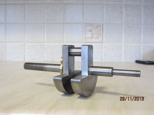

                  Maurice. The crankshaft has a portion reduced to 5/16" dia for the 12 tooth gear, my drawing does show this reduction, the other thing you may have to bevel the crankshaft bearing just enough to clear the 24 tooth gear, I think you will see that on the above picture.
                  Part Number for HPC Gears H32-12/ RH H32-24/RH
