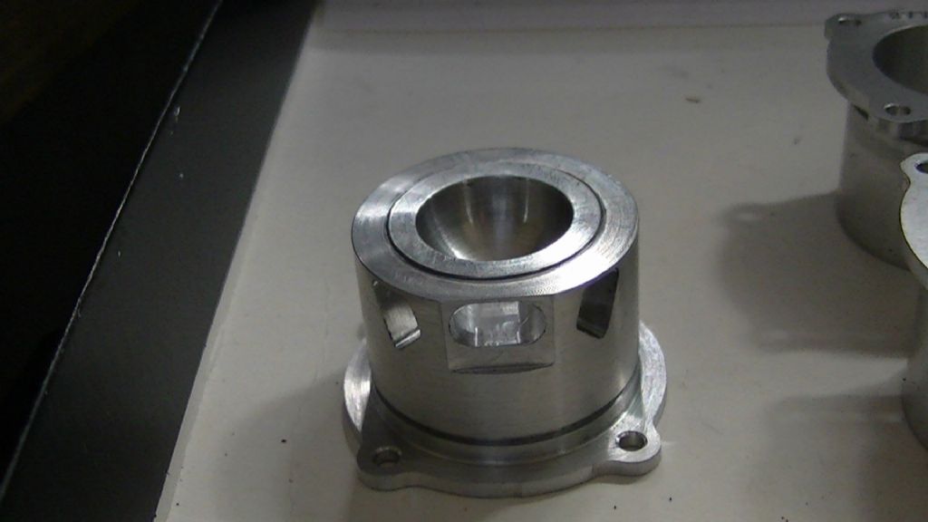

                          Emgee
                            @emgee
                            I use mainly carbide but also get very good finish with HSS, sizes used from 16mm to 1.6mm slot drill, the max spindle speed is 2000rpm which I use with the small cutters but the feedrate may be as low as 25mm/min with 1.5mm DOC for some jobs using 6082T6 and 7075T6 aluminium.
                            Go to 5 mins in the video to see the 1.6mm slot drill cutting, finished ports in the picture.
                            Emgee
                            **LINK**
