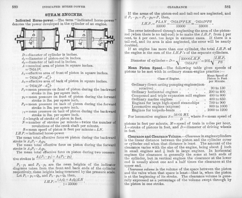

                          As will become clear, I have little knowledge of and even less interest in, Steam engines, though I can and do appreciate the engineering that goes into them, full size and scale.
                          My late father was presented with a copy of D. A. Law's "Pocket-Book for Mechanical Engineers" in 1933 when he won first prize in the H.M. Dockyard School, Hong Kong as a 4th year fitter apprentice Christmas Examinations.
                          It is to this publication that I reach when a question such as this is posed. Often, I garner little from it, but on this occasion, I think there might be a bit of interesting reading within its hallowed pages. I present, for your delectation, a scan of two pages which may or may not be relevant.
                          steam engines
                          If nothing else, it gives me pleasure to know my father read and hopefully absorbed some of its contents.
