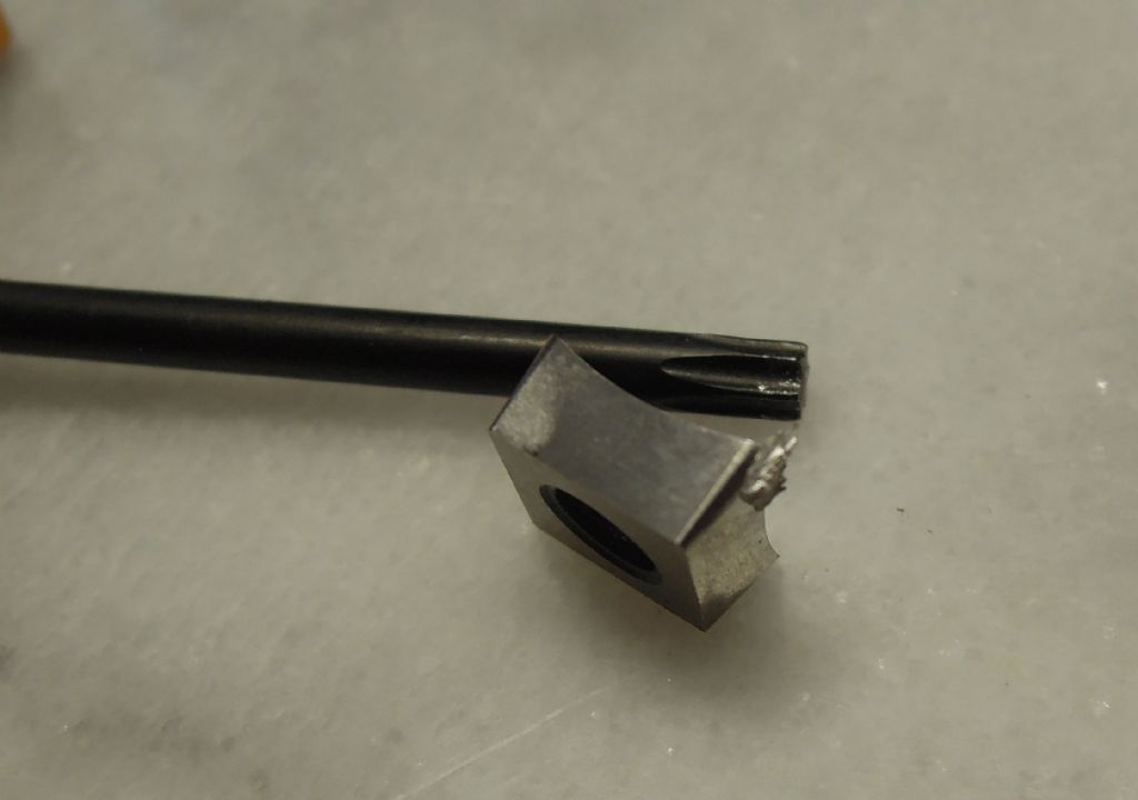

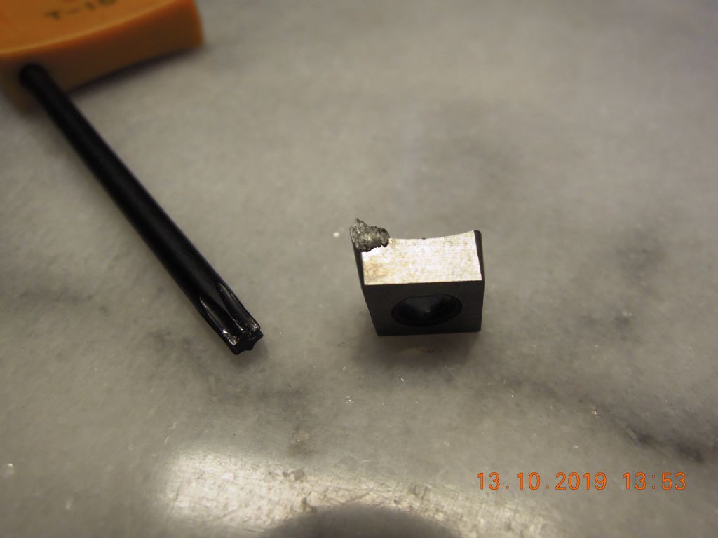

      I have started machining the face of a large bar end of aluminium 150mm max diameter at about 1000 RPM. All went well for about 20 mins then suddenly the cut goes to the dogs.I take the tip off and see this….
      It won't pick off with a finger nail and knowing how fragile the tips are I don't want to force it. I've not had this issue with any previous aluminium cutting with these inserts.
      Any suggestions on (a) how to remove it safely and (b) how should I change my conditions to help avoid it again ?
      For now I've put the tip in an ultrasonic cleaner but not hopeful this will do much really. I suppose I could heat the tip to the melting point of aluminium and let it drip off
      Gerry

          Gerry,
          It should push off with a screwdriver blade. Refit it to the holder to secure it and then push from under from the bunched up material shown in your second picture to shove it off into fresh air.
          Trying cutting aluminium with some paraffin lubrication in future, that should prevent another such accumulation.

                          1000 RPM is pretty high for 150mm diameter (even with carbide tooling and ally material) and will generate the kind of heat that is welding material to the cutting edge. Try slowing the rpm down. Maybe try 500 and see how it goes.
                          And 20 minutes is a long time to face a piece of bar. It may be that too slow a feed rate is letting the tool rub on the job and generate heat without cutting, resulting in the fine ally particles building up in a welded mass on the edge.
                          And +1 on use a bit of WD40 when machining ally. Seems to reduce the stickiness and is not as stinky as kerosene (parafin)

                              Never had a problem with BUE when turning aluminium alloy with aluminium specific inserts. Birdsnesting of the swarf yes, but not BUE. Two things are odd about the pictures. One, the insert doesn't look quite as polished as I'd expect for a CCGT insert. Two, the built up edge seems to run down the side of the insert, not just on the top where you'd expect it to be.
                              So, as per previous posts, summat isn't right. Cutting speed is correct according to Machinery's Handbook. But we need more details on the material, source of the insert, depth of cut and most importantly, feedrate.

                                      Hi all and thanks again for your comments. I should say that I'm privileged (?!) to have my workshop in the house (and in a carpeted room whats more) so I cant really use cutting fluids. Occasionally I dab on a bit of white spirit but that soon turns to smoke and generates lots of complaints. HOWEVER, my problem of BUE has been solved.
                                      I discovered that the cause is (as Andrew mentioned) the re-digestion of swarf into the cutting zone. By stopping the process and clearing the build-up, or changing the speed allowing the spirals to shoot off in a harmless direction the BUI simply never happens. And even if it does happen, I also discovered that just ignoring it and pushing on will often cause the BUE to break off and get everything back on track.
                                      The only harm the BUE seemed to do was make a noise and mess up the surface finish. A light finishing cut takes care of that.
                                      By the way, the U/sonic cleaner did help but for all the wrong reasons. A quick 5 minutes had no effect at all. But as an experiment I left the tip in the tank and by next morning the aluminium had corroded. The U/S had no difficulty removing this so I just repeated this giving it 5 mins per day and a week later there was no sign of the aluminium and the carbide itself was as good as new !
