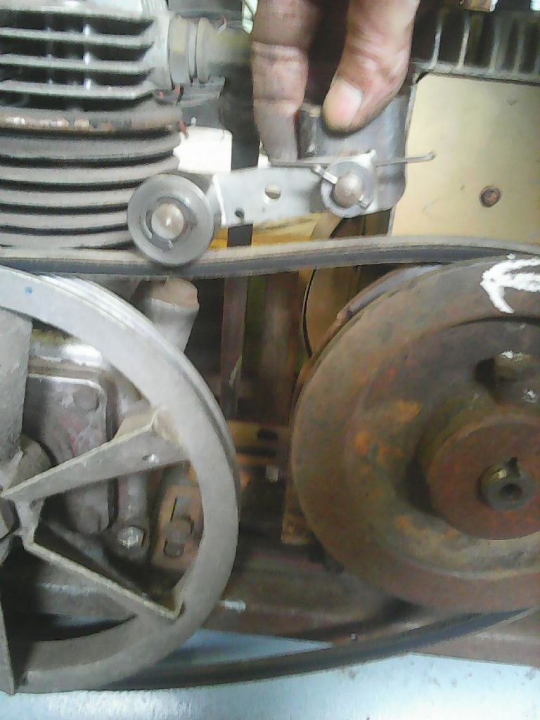

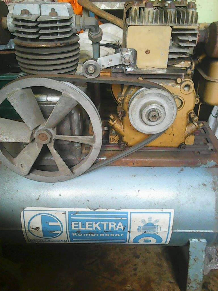

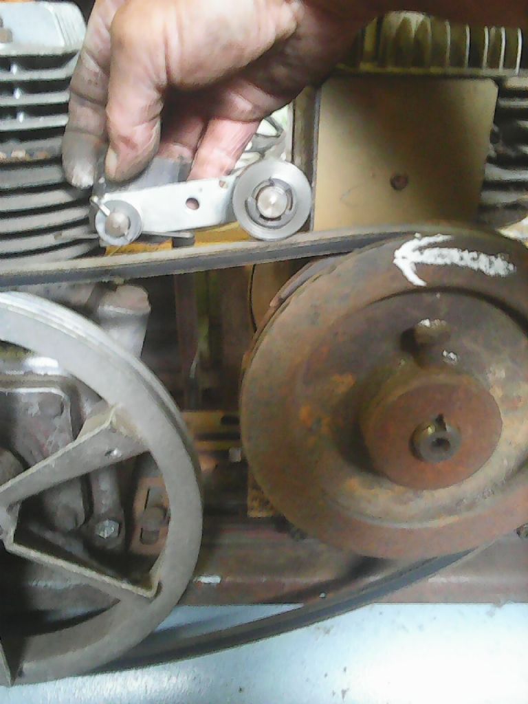

      I've been building up a compressor . It's now powered with a 3hp Briggs engine . Small problem with starting , not quite enough torque with the vee belt tight.. Retightened whilst running ,it drives the pump fine ,so i'm using the belt as a disengaged clutch to start it .. Which brings me to the jockey wheel i'm going to fit… Does it really matter if its trailing or leading ? I wonder if there would be a little servo effect if leading? I know it should go on the slack side of the belt, but what do you reckon ? Engine is on the right ..

          I would have it set up as per the top picture .
          I feel your problem has more to do with the drive pulley ratio , i would be looking at something like 4:1 or 5:1  and some sort of decompressor valve on the pump so you are not trying to start the engine under load

              go with the first photo…..
              done something similar but with a Lister Diesel…….on the outlet pipe from the comp I used a lever type ball valve (couple of quid from the likes of Screwfix) to dump air for start up……..do what "not dun it yeti' sorry, says, go for the old style cast iron compressor, mine is over 50 years old and nice and quiet…..elec driven tho……

                Yes , I'll fit an unloader valve . It is a cast iron barrel pump.. I don't know its cfm , but when it had an electric motor on it , it was just about enough to spray paint continuously with a devilbiss gun . I nicked the motor for something else …I,being a hoarder, thought it about time i did something with it , piles of mower junk turned into a portable compressor !
                I've got another compressor , started off as a plastic piston ring rubbish direct drive pump but i changed the whole lot to a iron ring pump with a sump , I bought from the classified on here .

                      blush Who said the pulley ratio could be better? He was right ! Stalled right out when i loaded the belt. Bored a new smaller pulley and cut a keyway, laugh Starts and runs gooder now , but this pulley is light alloy with no flywheel effect ,so when i use it, i'm going to start it with the belt slack , leaving the tensioner off ,and run it until it's warmed up unloaded, set the throttle and then tension the belt. photo0168.jpg

                        That fan pulley on the compreessor will not have such a high speed rating, I would think. Beware.
