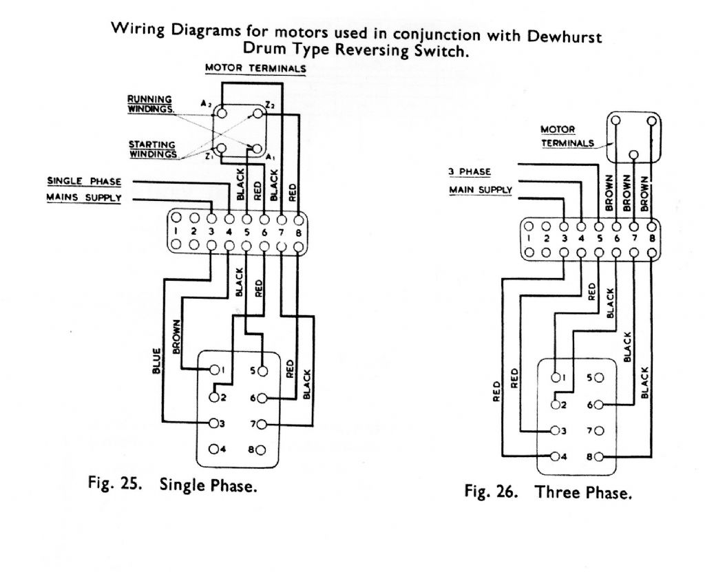

      Hi all I have a boxford model a
      Canary anyone post a wiring diagram it has a dewhurst forward and reverse switch and single phase motor

          Robbo
            @robbo
            The wiring diagram shown in the Boxford manual, for Dewhurst switches, is the standard Dewhurst wiring as shown by Myford etc and issued with the switch when new. Connected through a terminal block.
            As here:
            #241787
            Martin 100
              @martin100
              I seem to recall the wiring diagram was also affixed inside Dewhurst switches, maybe on the inside of the curved cover?
              #241789
              Speedy Builder5
                @speedybuilder5
                What most of these diagrams omit is an earth connection to the lathe bed itself. It is all too easy to ignore this and should a lead lamp, angle poise etc etc 'crash' onto the lathe, the lathe becomes live, your fingers are on the topside handle and suddenly you are the connection to earth!! Hmmm!

                  #242111
                  kevin large
                    @kevinlarge76611
                    Hi guys my motor is a gryphon don’t know if this the original my problem is now I don’t know what terminal is what there are 6 terminals only 4 are used so I don’t know what is a1 a2 etc I can’t see any markings
                    HELP
