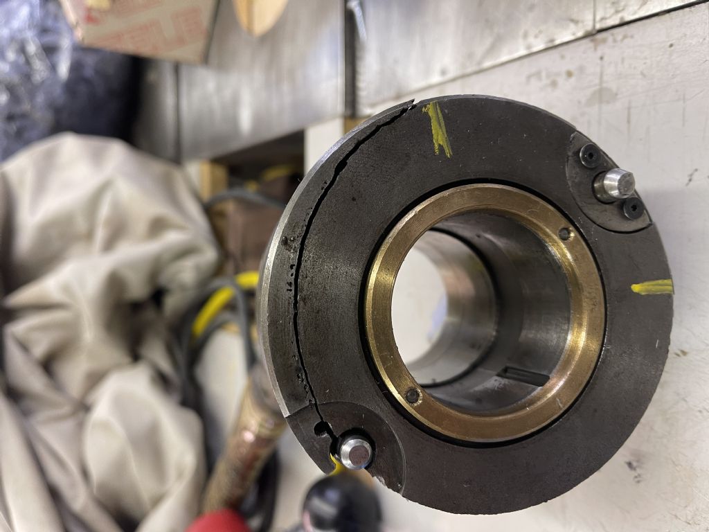

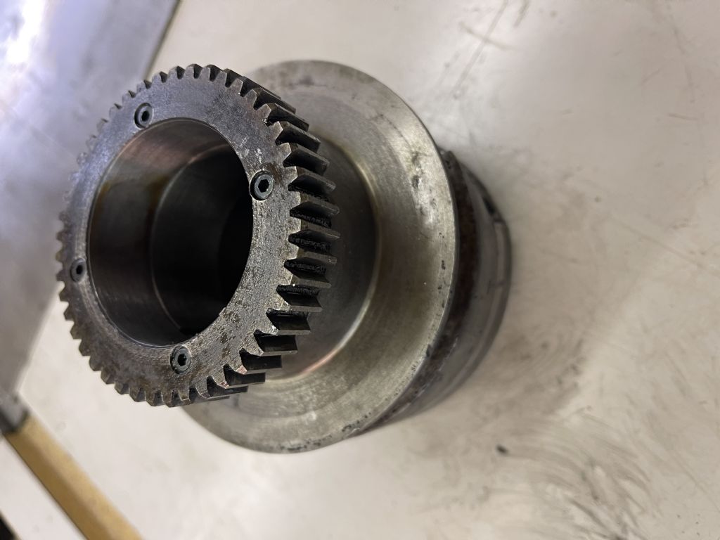

      Hello All

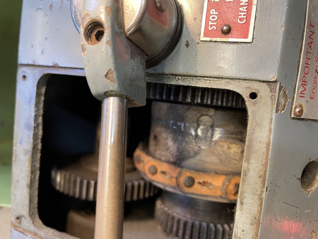

      I have tried parting off a 95mm blank of en3b and I noticed that the chuck kept slipping, I looked at the belt and all seemed ok, I then took the top cover on the headstock off only to find that a section of the drive pulley had broken away as well as the body holding the pins, a repair had been done by a previous owner which was to put insulation tape around the pulley main body to hold the pins in. Does anyone have a idea of how to repair this or where I might find another pulley?

            I will get a picture, the problem is that the chunk of cast iron that is missing also forms the inside wall of the pulley.
            #583059
            Roy Birch
              @roybirch29994

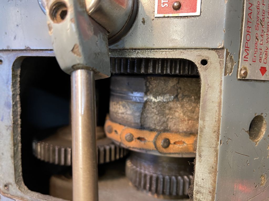

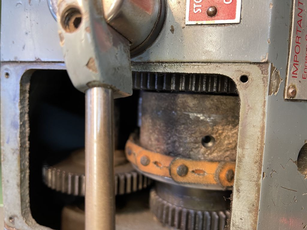

              img_0648.jpgimg_0647.jpgimg_0646.jpgimg_0645.jpgThe delamination of the cast iron is at max 3mm deep where the drive pin is, the delamination travels 1/3 of the circumferance of the pulley and is exactly from jaw 1 to jaw 2 on the chuckimg_0644.jpg

                The delamination of the cast iron is at max 3mm deep where the drive pin is, the delamination travels 1/3 of the circumferance of the pulley and is exactly from jaw 1 to jaw 2 on the Chuck

                      I suspect the problem is that someone either pushed the spindle lock in whilst the machine was running or a chuck got stuck and they used too much force with the spindle lock engaged, I dont have the facility to make a new one as I would want the main headstock pully out of the machine to make test fits and I dont have another lathe I could use.

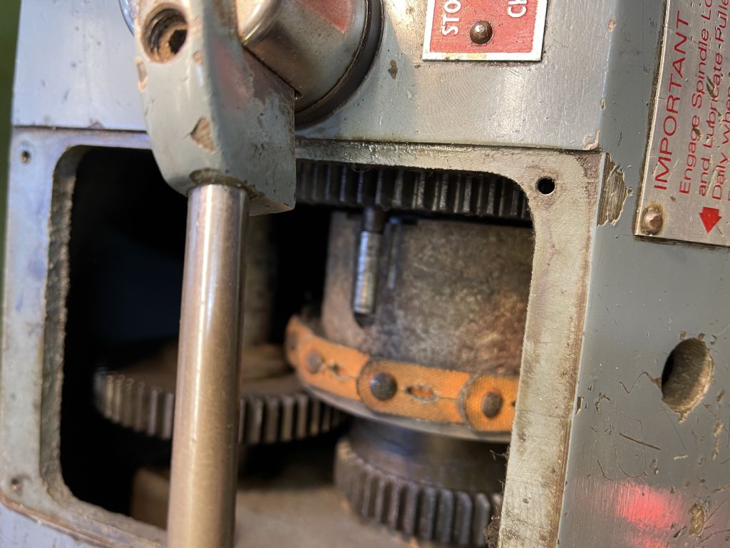

                        Mmm that looks nasty. Not sure what you mean exactly about the inner wall, as I am not familiar with that particular lathe. But it looks like something might be done along the lines of taking the pulley out and machining the OD down and then turning up a steel repair ring and shrinking it on then securing with pins or screws etc. Or you might have to cut that whole section off and turn up a complete ring and attach it somehow to the rest of the pulley. Either way, looks like major work.
                        #583071
                        Hopper
                          @hopper
                          PS cross posts. If you don't have facility for a major job like that, could a very large Jubilee clip type of hose clamp be substituted for the electrical tape as a temporary bodge? Or a purpose made band of sheetmetal with a clamp arrangment on the ends to pull them together?

                            The main problem is that the lathe is slipping due to the wall of the drive pulley being cast into the part that is missing so even if I tried to make a new one it would be difficult on this lathe.

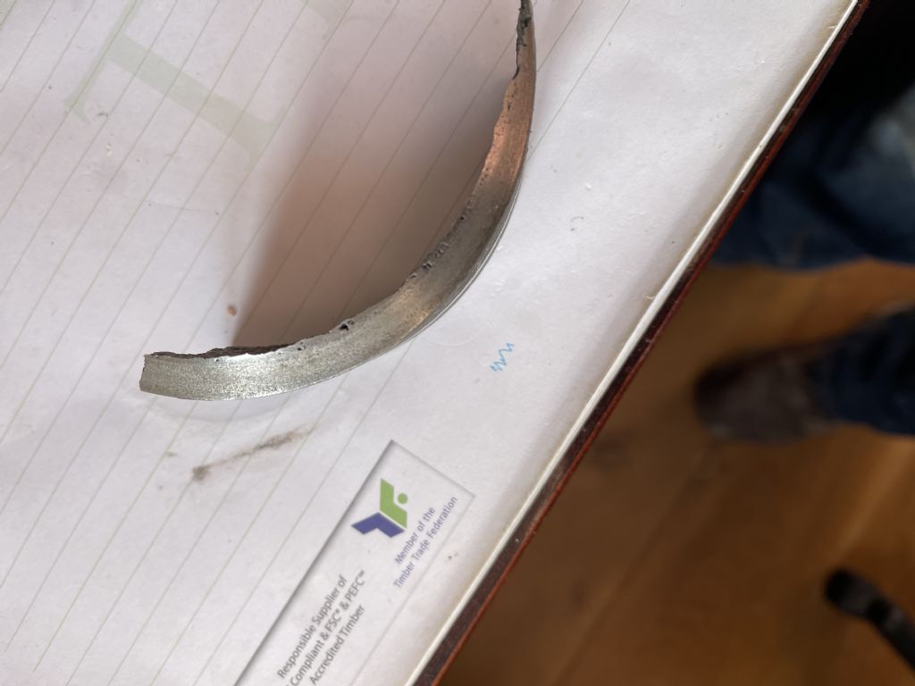

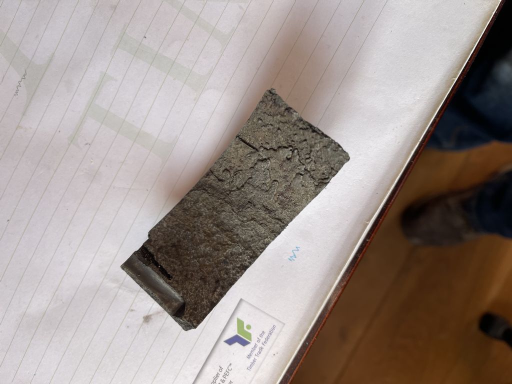

                                  So upon further investigation I have found 2/3 of the missing piece, whoever was operating this Boxford at the time left this inside nicely against the drive belt, photo 1 shows the inside, photo 2 shows the outside which also shows that someone was trying to use the spindle lock with the chuck still turning and photo 3 is the reason for the belt slipping as this is the inside wall of the belt pulley, does anyone think this is user error or was the casting suspect in the first place? and does this piece and I am sure I will find the other bits iside the headstock somewhere make a repair more likely?

                                          Just seen Roys post (after I had just typed this up) – I agree with his diagnosis as this is very similar to the Boxford AUD.
                                          Looking at photo 5, it may be that the damage was initially caused by the spindle lock pin shearing the slice off of the pulley. If there had been a stuck chuck and excessive force was used to remove it, that force would have been transmitted through spindle lock pin and then the machined slot in the pulley. Incidentally, there is a wear mark on the piece which sheared off. Was that caused by the spindle lock pin ?
                                          Hopper's idea may be the best way forward -If you have access to another larger lathe.

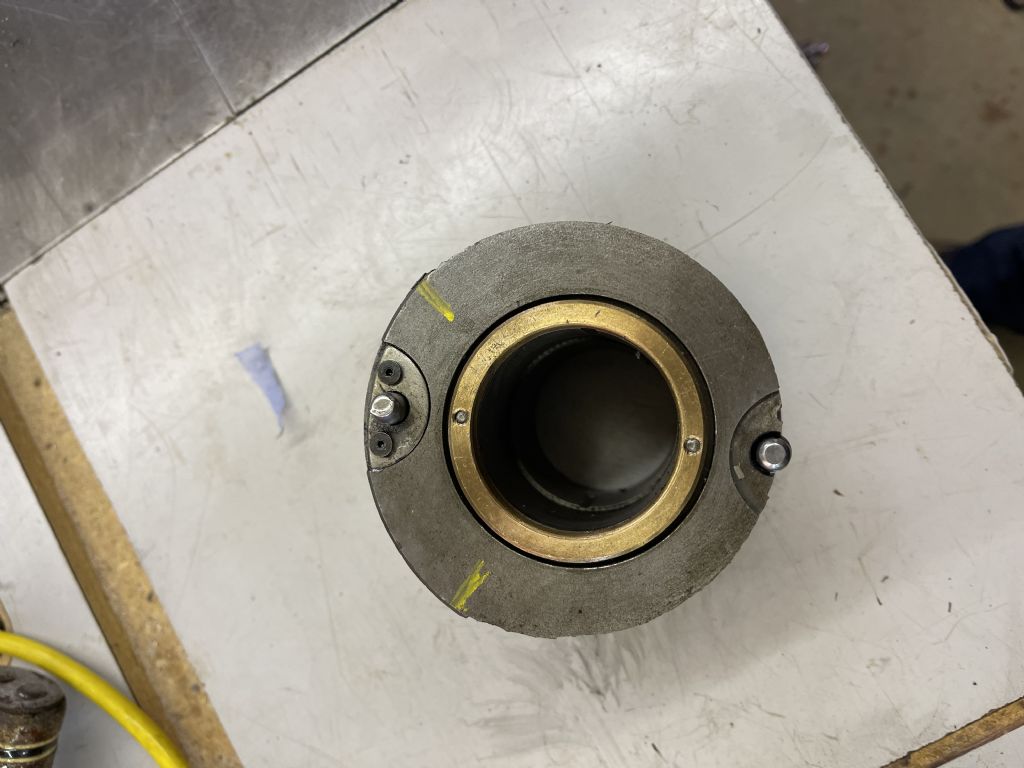

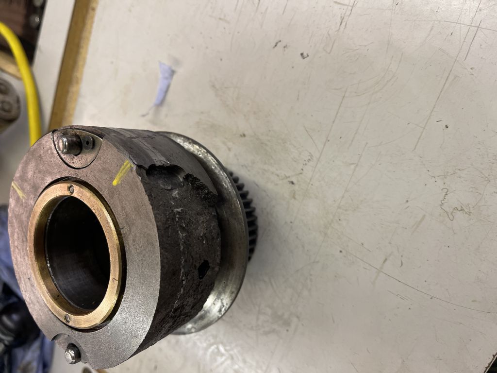

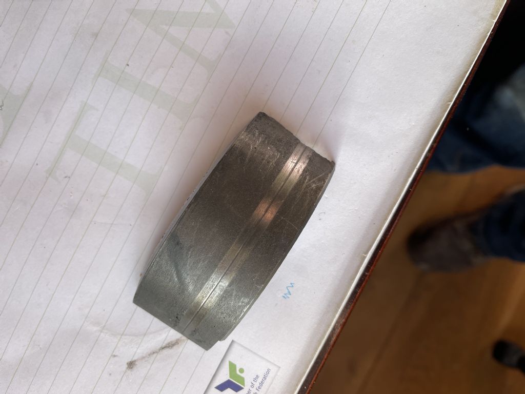

                                              So here is the pulley out of the machine, the drive gear shows some elongation of the holes for the drive pins so I think this lathe may have been put into back gear with the shaft still turning,
                                              Photo 1 shows the area that is missing from the pulley, this distance is at least 2/3rds of the pulley missing some material.
                                              Photo 2 shows why the lathe had a lot of slippage
                                              Photo 3 seems to indicate that this is made in 2 parts as there is a golden ring around the part that holds the back gear which I assume is silver solder.
                                              Photo 4 shows the deepest part of the damage with very little pulley side left.

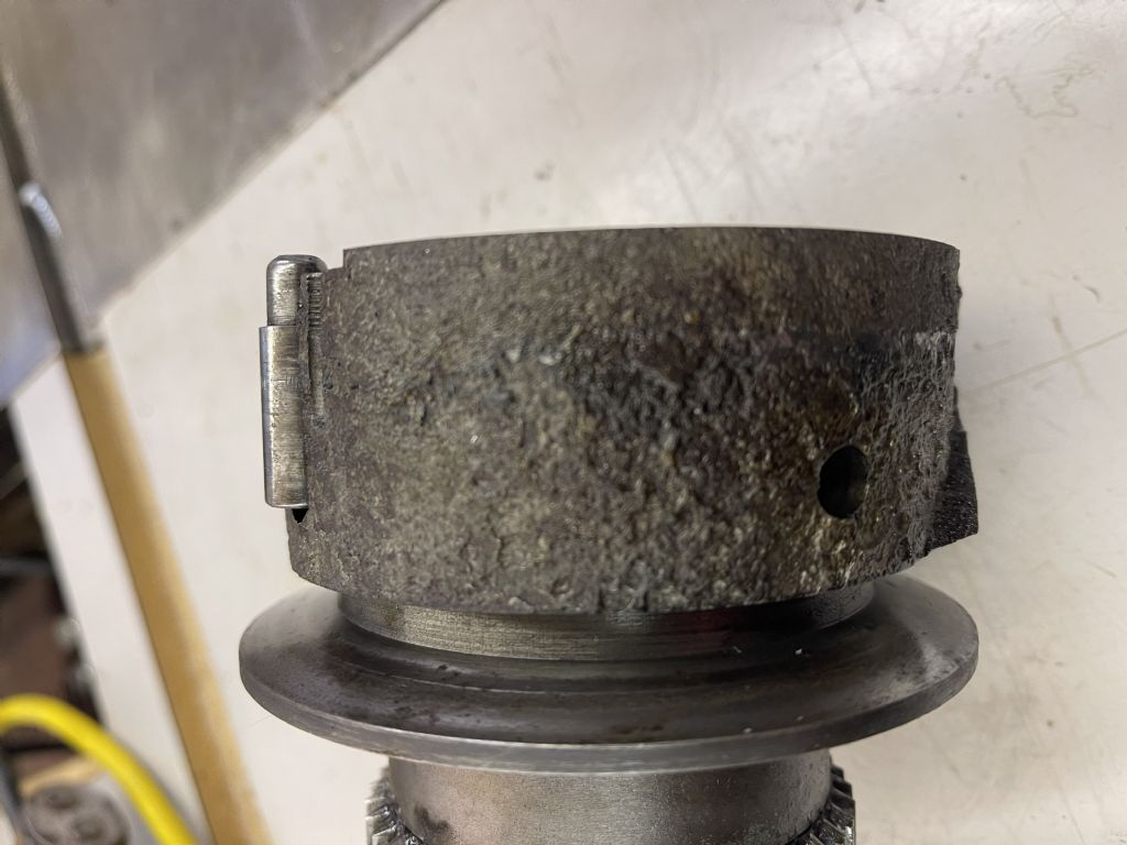

                                              Photo 5 shows the piece that I found against the drive belt in place on the pulley block.
                                              This pulley block is different from the normal AUD as this one is solid and the AUD block is machined to have an internal hub which I assume has a lot to do with weight so any other replacement has to be the same as you would machine most all of the internal hub away. I now dont think the repair is feasible unless I drilled a new spindle lock hole in the undamaged area of the pulley and a new button oiler hole which runs into the small keyway in photo 5.
                                              Regards
                                              Roy

                                                One more thing to add is that I now believe this casting is at fault because the two pins in photo 5 should have sheared off befor the casting took any damage

                                                  Looks like there's a crack on the pulley side as well.
                                                  #583348
                                                  Roy Birch
                                                    @roybirch29994
                                                    No that’s not a crack it’s the piece that was broken off which I have just placed on the hub
                                                    #583352
                                                    Dave Halford
                                                      @davehalford22513
                                                      Posted by Roy Birch on 31/01/2022 16:50:06:
                                                      Gear side photo so the other side of the pulley, there's a spiral of little black spots
