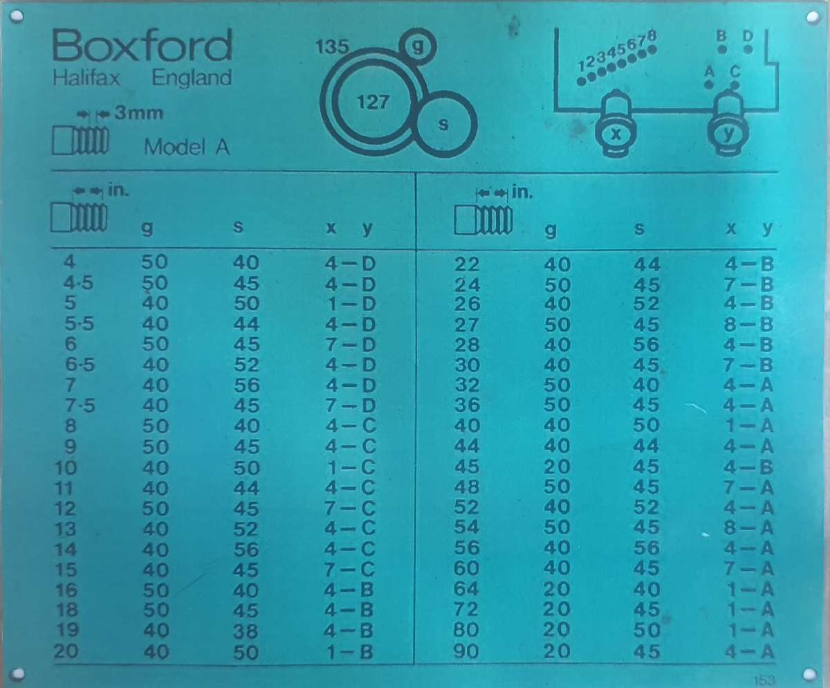

              To translate 16TPI leadscrew minilathe language into Boxford/Myford 8TPI language, that would be:
              The magic ratio of 16/25.4 = .6299 becomes 8/25.4 = .3149
              Which is as close as dammit to 63/200 = .3150, an error of .0001.
              Myford’s 21T metric conversion gear, to cut a 1mm thread with an 8TPI leadscrew, is used in a gear train of driver/driven = 45 x 21/40 x 75     = 945/3000 = .3150, ie an error also of just .0001.
              So while the 21T is oft pooh-poohed as an “approximation only” it, like its triplicate brother the 63T, it is plenty good enough for most practical applications within a ratio error of 0.0001.
              This of course all applies to change-gear lathes and not gearbox lathes. Gearboxes add an extra layer of complexity because you are limited to using the 8 or so pairs of gears inside the gearbox as part of the overall calculation, and using different stud gears to make up the difference. Hence perhaps, manufacturers using the 100/127T combo instead of the seemingly more obvious 80/127T combo that would give the same magic ratio of .6299 as 16/25.4 .
              I don;t know. But my head hurts thinking about it. And it’s time for lunch and an afternoon in the shed welding up the legs for my Stirling engine fan. No numbers or calculations involved.
              Its in the back of my mind somewhere that John Stevenson conceived, made and sold a special 30-something Myford stud gear for gearbox metric conversion and I am sure there was  thread on teh old forum about it somewhere. Might have a search later on.

                        Michael
                        The 127 gear does the conversion magic.
                        The other gears are chosen to get the desired pitches / TPI in sensible places on the gearbox tumbler setting. Official factory conversion sets seem always to be chosen to give a nicely linear arrangement of pitches / TPI by either changing gears in the drop train in sequence or simply resetting the tumblers.
                        From what I’ve seen the, usually computer calculated, “funny” ones using other gears hop around the box like demented flea. Some seem to want both stud driver and gearbox driver to be changed for certain threads. An absolute recipe for confusion for anything approaching general work. But acceptable if needs must and you can use what you have for “just this one” job.
                        In the Boxford case where the stud drive gear is changed the 135 tooth gear is chosen to work with the 40 tooth gearbox drive gear and the 18 – 30 tooth pair at the gearbox input that drives the Norton gearcone that sets the basic pitch /TPI sequence. If I read the parts book correctly, Boxford use the same cone for both imperial and metric boxes.
                        I’m pretty sure you need a factor of 8 in there hence changing the gearbox drive gear from the standard metric 45 teeth to 40.
                        My metric Smart & Brown 1024 uses a 120/127 conversion gear and changes the gearbox input driver in sequence to generate a range of pitches / TPI for given tumbler (dial and lever) settings.

                                #736602
                                Craig Brown
                                  @craigbrown60096
                                  20240617_204123
                                  This chart gives the information required for cutting imperial threads on a metric Boxford. I had ment to post it sooner but I had forgotten about it until I saw it in my cupboard tonight
