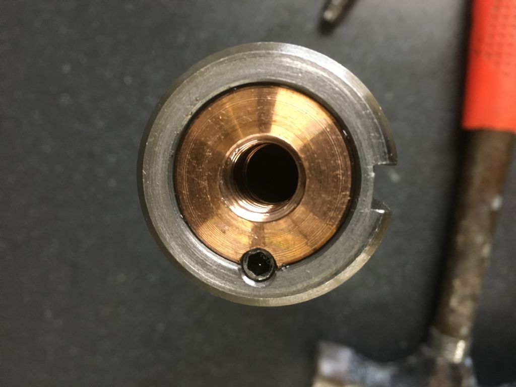

        #320719
        David Standing 1
          @davidstanding1
          Lee
          I have a nasty suspicion you will have no other action.
          HOWEVER, be very careful – do not use a thin bar – in the back of the quill is the leadscrew nut, and it will be bronze/gunmetal or similar i.e. soft.
          If you have a piece of round brass bar a little less than the diameter of the tailstock bore, fine. If not what I would suggest is you go to your socket set, find a socket with an outside diameter just less than the bore of the tailstock, fit a long enough extension bar, and use this as a drift to knock it out. The socket will then impact on the quill itself, and not the nut.
          If you can stand the tailstock in the vice, in soft or lead jaws, on its end, tight enough in the jaws to support the casting but loose enough for the quill to slide through the jaws; even better, as all the driving force will be transferred to the quill.
          I am betting it will tap out quite easily.

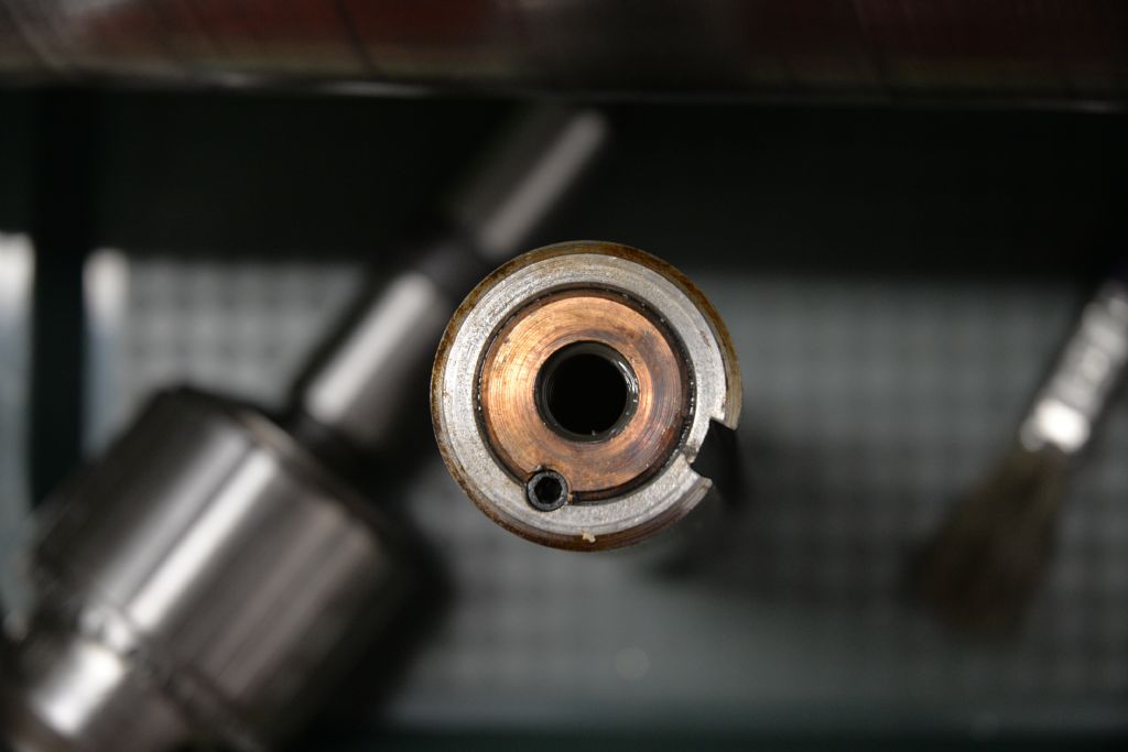

          Photo of the tail end of the quill below.
          I'm now going back to clearing out the workshop as my new Tom Senior horizontal mill arrives tomorrow!

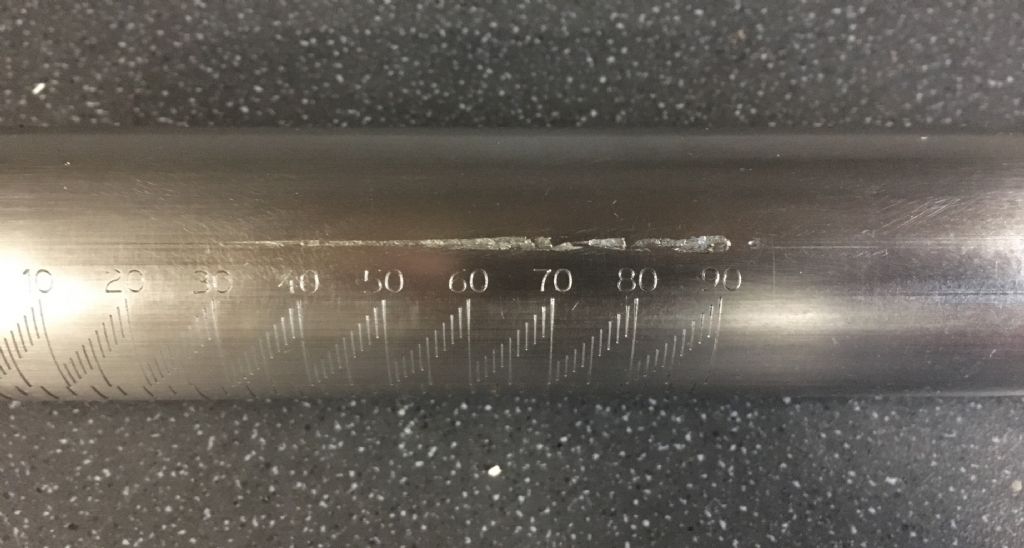

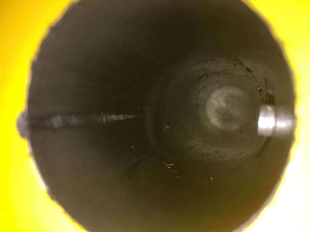

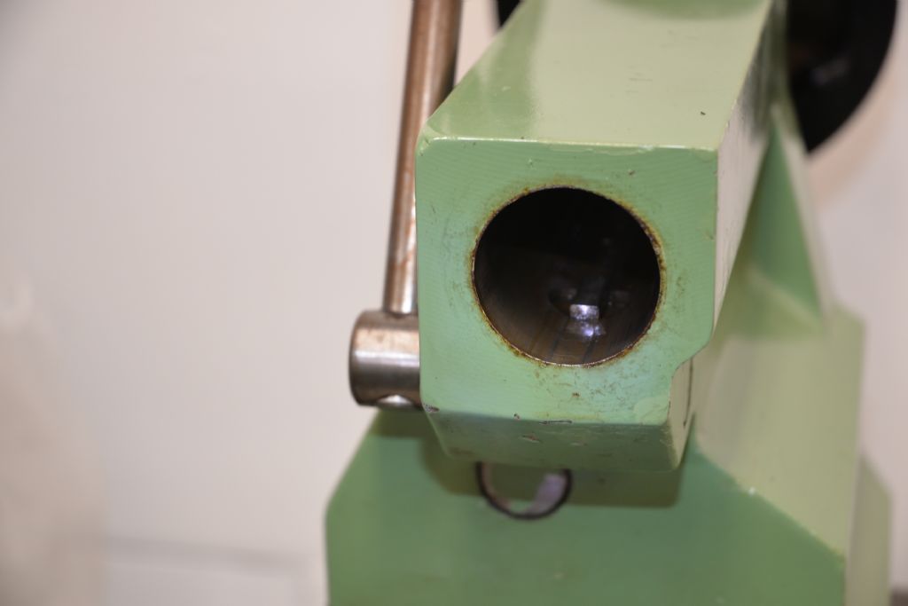

                494cc842-0682-4ee2-a00f-9523b99987ae.jpegc9754678-1be2-46fe-b68a-39f58b6990d7.jpegA few picks as promised Dave
                #320772
                David Standing 1
                  @davidstanding1
                  Lee
                  Thanks for the photos.
                  Out of curiosity, does the scar go back as far as the oiler in the headstock casing?
                  And per our conversation earlier, once the scars clean up it shouldn't affect operation.

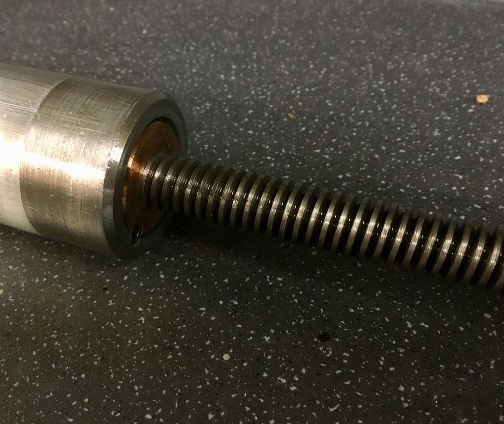

                  #320796
                  Lee Goulding
                    @leegoulding74917
                    Screw thread
                    #320810
                    David Standing 1
                      @davidstanding1
                      Lee
                      Thanks.
                      Sorry to be a pain, but can you post a picture of the screw out of the nut, and with the oil cleaned off?
                      To keep others in the loop, the quill is now out of the tailstock, but the feed screw is locking in the feed nut.
                      I suggested to Lee that he use a pick on the nut threads to clean out any swarf etc in the nut threads, but the feed screw still locks up solid in the nut after about 1".
                      The nut will not unscrew from the quill for further inspection (yes the grub screw was removed).
                      I can only assume that after force was initially used to try and wind the quill out, the feed nut or screw are damaged.

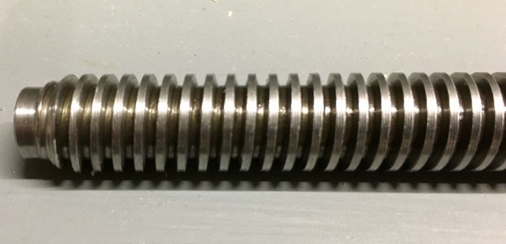

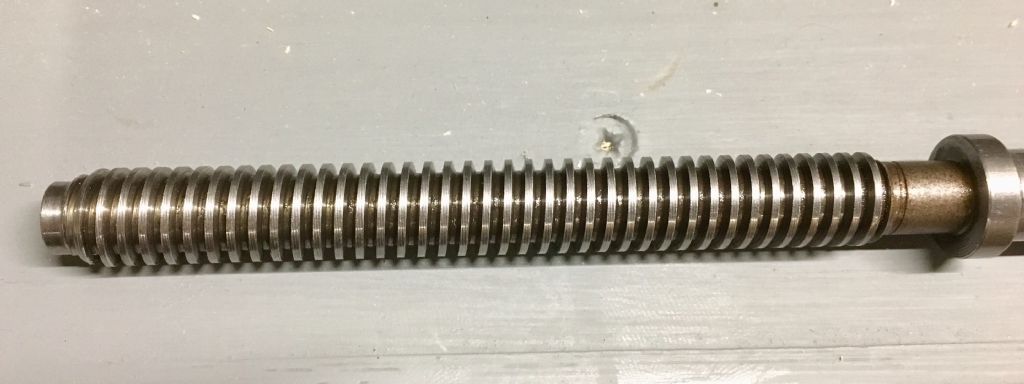

                              eb89a2d2-c3f4-4fda-8c2c-026e11d7a37c.jpegSome pictures David of the thread it goes into the brass screw about 15mm max and then is really tight
                              The brass thread looks clean and clear but hard to see the bottom of it as you know
                              #320892
                              David Standing 1
                                @davidstanding1
                                Lee

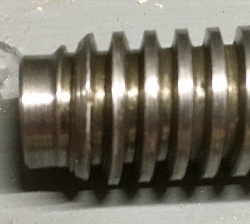

                                Turns one and two of that thread look like they are burred over.
                                I believe that is an Acme thread form, in which the root and crest are parallel, and the angle is 29 degrees.
                                The start of the screw looks very suspicious, as none of the Acme thread form is rounded, it is all angular and sharp edged.
                                A photograph of the front end of the screw at a slight angle, and closer if possible, would confirm.
                                #320896

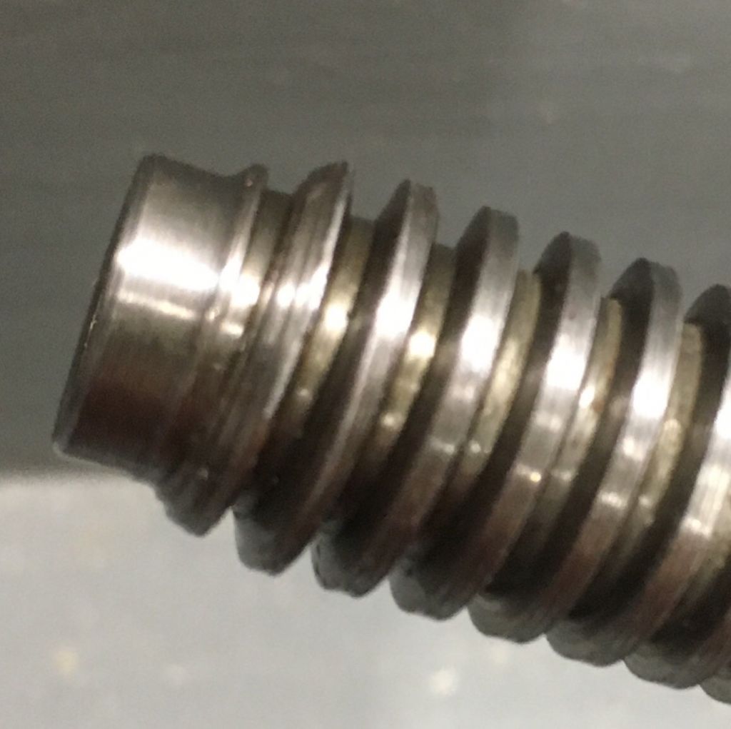

                                  69af55f0-48c1-495f-8959-249ed624a238.jpeg02585e0a-cb7e-44c7-9e10-e9287f228dd9.jpegCloser pic of screw front does look rounded
                                  #320899
                                  David Standing 1
                                    @davidstanding1
                                    It does.
                                    The edge of turn one doesn't really matter as it is the lead in, but whilst the back of turn two looks ok, it looks like the front of the thread has been pushed down into the the thread root.
                                    If that is the case, your best bet is probably to try and dress it out back to the correct thread form with a flat needle file (ideally one with a plain edge).

                                      I’ve had a go at dressing it best I can but still hits a tight spot 😂

                                          Lee Goulding
                                            @leegoulding74917
                                            Hi All
                                            Massive thanks to you all for contributing and massive thanks to David Standing for the extra mile and phone chat
                                            Eventually after trying my best to dress the thread it was still a little tight but thought I would put it back together so I could apply a little more pressure using the wheel and to my surprise the thread went though and is now running better than ever.. hope it remains that way
                                            Thanks again everyone
