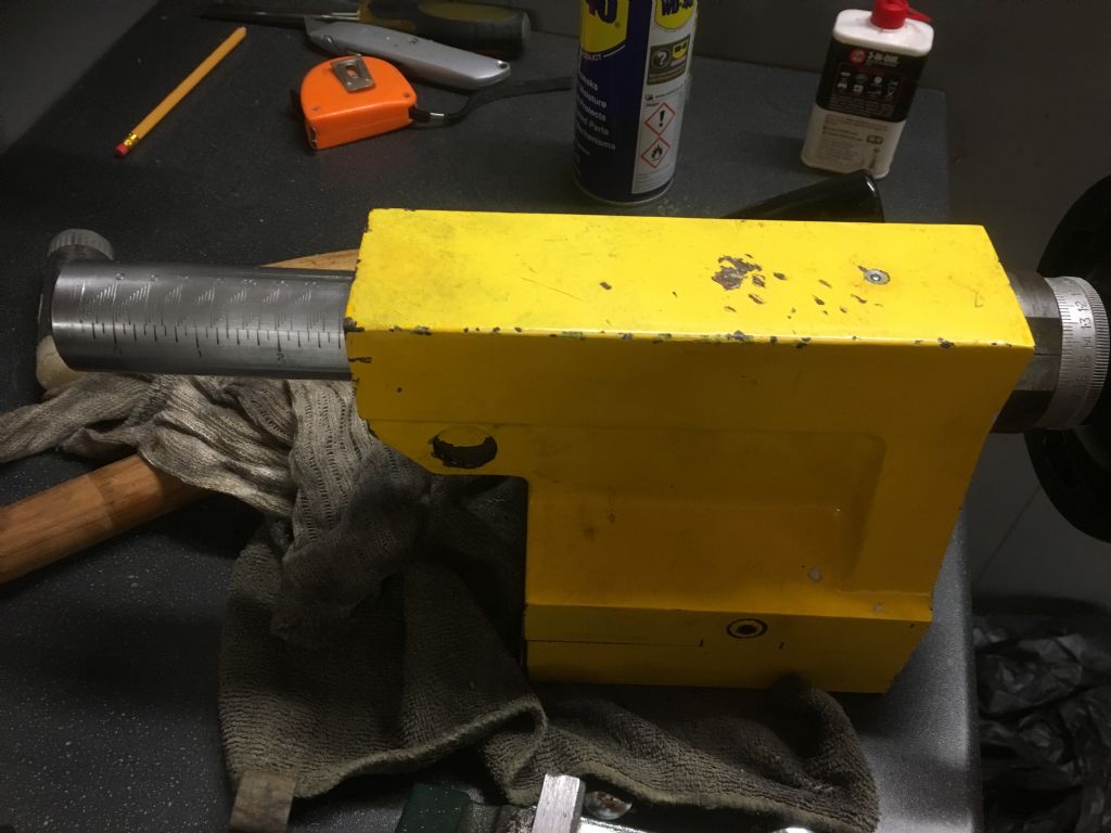

      a9eeb427-e7fa-4f9d-8acc-fa8ec9e88d52.jpegHi Guys
      Been using this Lathe for about 6 months and tails stock has been fine up to today it has just gone mega stiff all of a sudden and only been using wood no metal cutting
      It literally went from drilling a 7mm hole very smoothly to not being able to wind it out
      I have managed to wind it out to try and get the barrel out and have noticed a grove in the shaft
      Any ideas how to fix it

          Groove in shaft? The barrel will have a groove along its length and a grub screw or pin will locate in that to stop it rotating. Perhaps this worked loose allowing bit of rotation when it jammed. Is the scale on the barrel normally on top – most are?

            As Baz says if you over extend the barrel then the pin disengages with the keyway and if not carful goes back crooked when you wind the barrel back in.
            May also have end float adjustment on the handle which could have turned and tightened things up

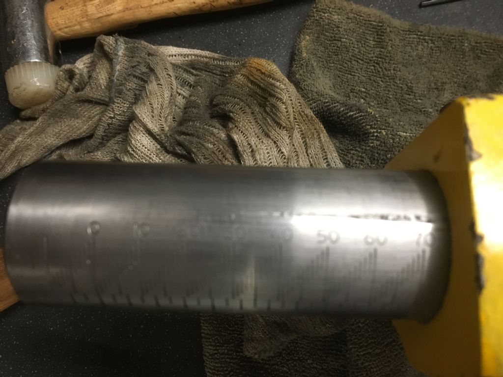

              Just saw the other photo, looks like something has got into the top of the barrel and galled the surface.

              Lee Goulding
                @leegoulding74917
                Hi Jason
                Agree but really not sure what as ive only been turning wood and it was very smooth one second and really stiff the next
                Im struggling to turn the handle now and have had the handle of and the screw out but cant see anything obvious.
                Also cant find any screws etc that hold the barrell in and im sure it just locates on a ridge that the underside of the barrell fits into
                How best do i go about getting the barrel out to see whats happening
                Thanks

                  Just take it apart and try each bit separately. Smooth movement of barrel in body, smooth movement of screw in barrel. diagram here

                      I have just done a quick visual on my 330 tailstock (same one as yours), using the same reference points, and your quili appears to have rotated about 20-30 degrees in the tailstock housing.
                      To double check, turn your tailstock upside down, the keyway in the quill should be at BDC (6 o'clock) position.
                      I am struggling to understand how it can have rotated as the keyway is 6mm wide, with a dirty great Woodruff key in the base of the tailstock housing.

                                    I've just had another thought, re the scoring on top of the quill.
                                    It looks to be at 12 o'clock. That's where the oiler sits. I wonder if the oiler has broken up internally and that is what has caused the scoring and jamming?

                                              If part of the oiler has broken up, you wouldn't see it when you took the quill drive screw out. Remember it sits above, and is covered by, the quill. If it breaks up then the only way out would to be jammed between the quill and the tailstock housing, and travel along it – just like the scoring you now have.
