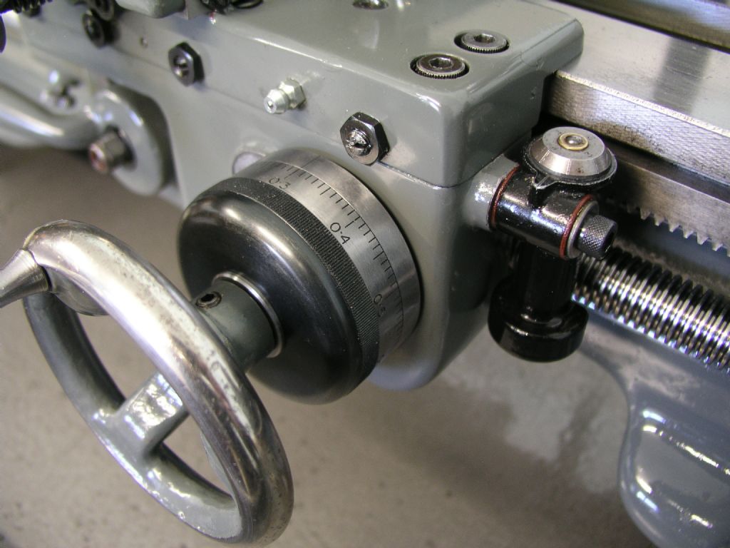

              If you want to measure carriage travel you don't need to go digital. Graham Meek's resettable carriage handwheel dial integrates perfectly with the lathe, covers the full travel of the carriage, and provides adequate accuracy for most tasks. Interesting project to make, or you can buy ready made. Photo of my example attached:

                    Regarding the tailstock, Gray also designed a very nice resettable tailstock dial. Unfortunately it is for a Super7, not an ML7, so unless you are prepared to obtain a Super 7 tailstock it’s not a solution.

                            Standard/optional Myford graduated handwheel for the main leadscrew is a cheap way to measure carriage movement.

                              I've already got a graduated leadscrew handwheel, but never use it for moving the carriage. I either use the saddle wheel, power feed or the top slide.
                              The wheel is too stiff to turn with the gear setup I've got for fine feed. I suppose there's an obvious way of rapidly disconnecting the leadscrew from the rest of the gear train, which I'll feel daft about when you point it out!
