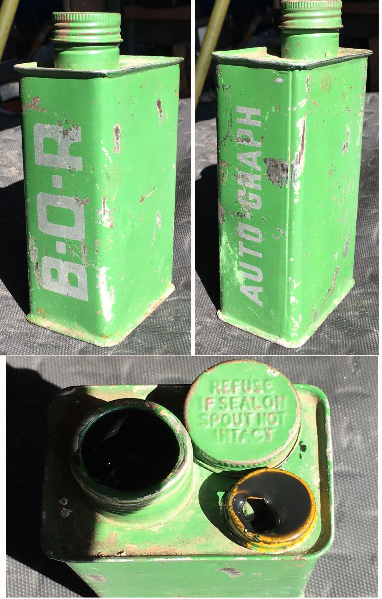

      I recently purchase this can at a rally with the intention of using it to store steam oil for my model traction engine. I believe that it was originally made by the Burmuh Oil Refinery in Glasgow, circa 1910 and contains graphite in oil.
      The can has never been opened and still had a metal seal intact. (a note on the lid to refuse to buy if the seal is not intact).
      Does anyone have any history of the product or its intended use ?

          The company name was Burmah – it incorporated Castrol and after financial difficulties became part of BP.
          I seem to remember that Halfords was part of the group too and that Sir Dennis Thatcher was a director at one time.
          I suspect that the oil you have is colloidal graphite – a popular additive to car engine oil at one time. People have tried adding it to steam engine lubricating oil but reports suggest it separates out and can clog things up.

              I was also told that it is probably colloidal graphite but not sure how it was used. I was told that it is good for lubricating bronze bushes but not ball bearings because there is less friction and the balls may not rotate and wear on one point only.. Not sure if is used straight or mixed with oil (it already is mixed with oil).
