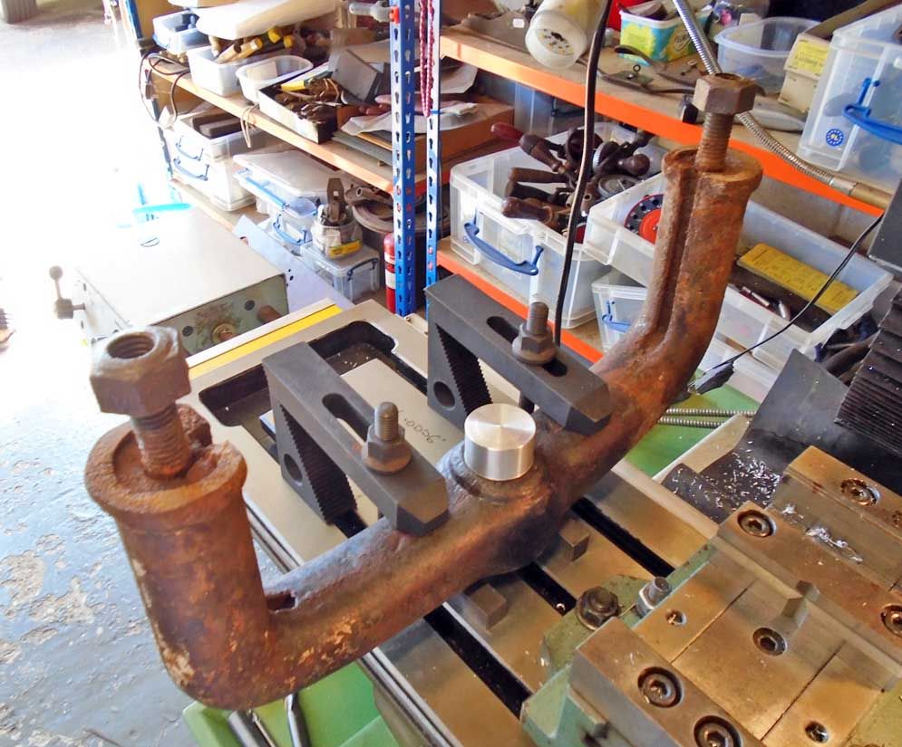

      Hi All,
      Here is my first attempt at setting up the arch section for boring out whenb the nut and new screw arrives.
      I have made an ally plug to allow the centre to be found.
      I am concerned how rigid and safe this will be, also It is not sitting quite vertical and is difficult to tap into the correct place without it becoming loose. Should I try some alloy or lead sheet between the bottom and the small parallels perhaps?
      I have had to raise it up a little to allow the boring bar to clear at the bottom.
      Any advice is most welcome.
      Cheers, Martin

      ega
        @ega
        Try vee blocks under the work instead of the parallels I think I see in your photo.
        Better still, clamp the work via U bolts as well.

        Martin King 2
          @martinking2
          ega, I did try vee blocks but the ones I have are way too small sadly. Will try and find some U bolts.

            #415436
            Tim Stevens
              @timstevens64731
              If I were doing this job, I would be happier if the legs of the arch were stayed in some way, ie fixed to the bed so that they remained upright. Just in case anything started to go wrong – it might save a big problem.
              Cheers, Tim

              Martin King 2
                @martinking2
                Hi Tim, I thought about that and was going to make some large hardwood blocks recessed for the nuts that would clamp to the table but it would be way too high then to allow machining.
                Cheers, Martin

                Gordon Smith 1
                  @gordonsmith1
                  Why not lay it flat and use the lathe?

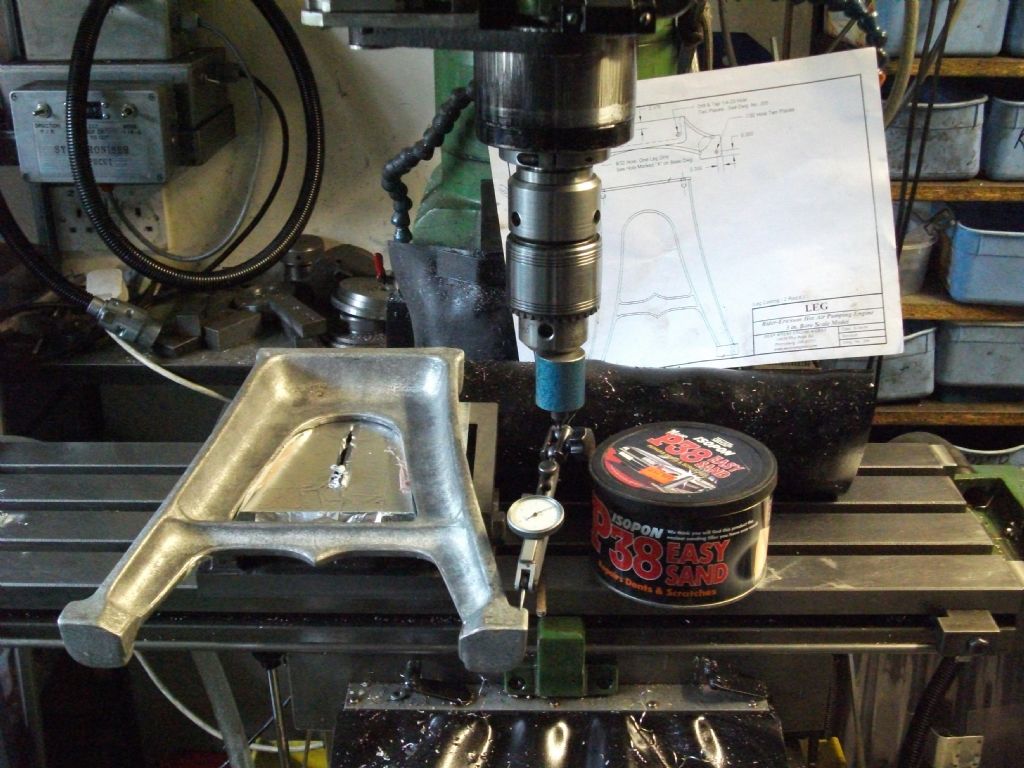

                        This is the method i use when holding thin and awkward
                        and irregular shaped pieces for machining.
                        This part of a hot air engine had no flat surfaces and was
                        a thin aluminium casting ,using an adjustable angle plate
                        the top surface is covered with some aluminium tape ,the part is
                        attached to the plate using some plastic padding ,it is essential to
                        put some release agent on to the casting to release the part
                        easily ,a single clamp through the central slot in the angle plate
                        provides enough clamping force to hold the part for machining
                        as the plastic padding in this instance forms a shoe for the
                        part to sit in.
                        Used this method many times for these sort of jobs, works
                        every time.

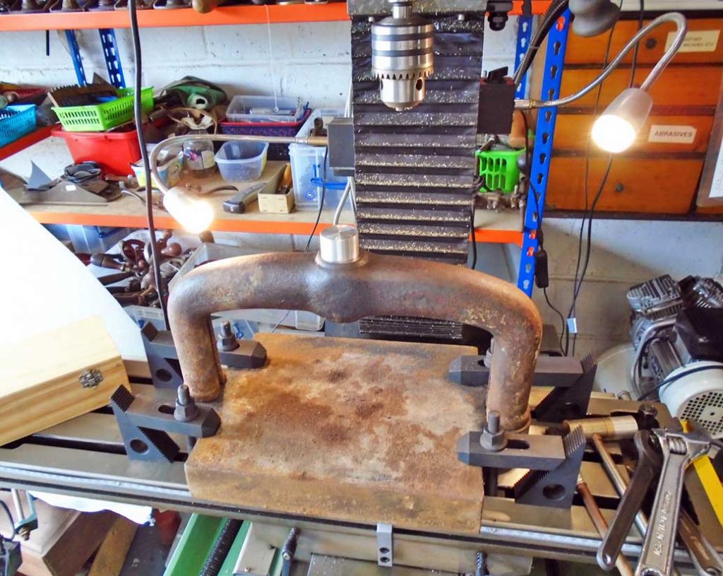

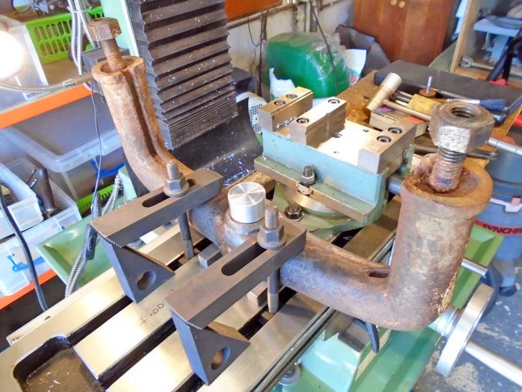

                        Martin King 2
                          @martinking2
                          Hi All,
                          I did not feel happy with the first setup so have taken Tim Steven's advice and used the actual bottom section of the press to hold the arch section and clamped the whole lot to the table as shown.
                          This is a lot more stable and managed to tke a skim cut off rough surface at the top odf the arch with a face cutter. It all felt very secure.
                          The only problem now is that there is not enough daylight to put my axis centring gauge in the drill chuck to get the centre point. Even with the shortest ext diameter pointer it hits the top of the arch.
                          Cheers, Martin

                          Simon Williams 3
                            @simonwilliams3
                            If you are short of head room, two suggestions:
                            1 Do it the old fashioned way with a dial indicator clamped to the quill, i.e. get rid of the drill chuck.
                            2 I hold the spigot of the centering indicator in a collet up the quill taper to save forfeiting several inches of head room. In my case the collet is MT2 but it means the top of the centering indicator is right tight under the nose of the quill.
                            I guess the accuracy of the centre isn't crucial to a few thou' so use a sticky pin in stead of the DTI.
                            HTH Simon

                            Jeff Dayman
                              @jeffdayman43397
                              Dowel pin and cigarette paper may do the job for finding centre to your aluminum plug within a couple of thou. Short, cheap, and has worked for well over a hundred years.
                              Forgot to mention I have used car body filler to encase and secure irregular parts for light machining. Coat the casting in spray furniture wax or proper release agent spray, then make a plywood box to contain filler and part. kitchen plastic wrap can be used on the bed of the machine to keep filler off it. encase the part to halfway across it, like a casting parting line, then wax the face of the filler and fill the other side.

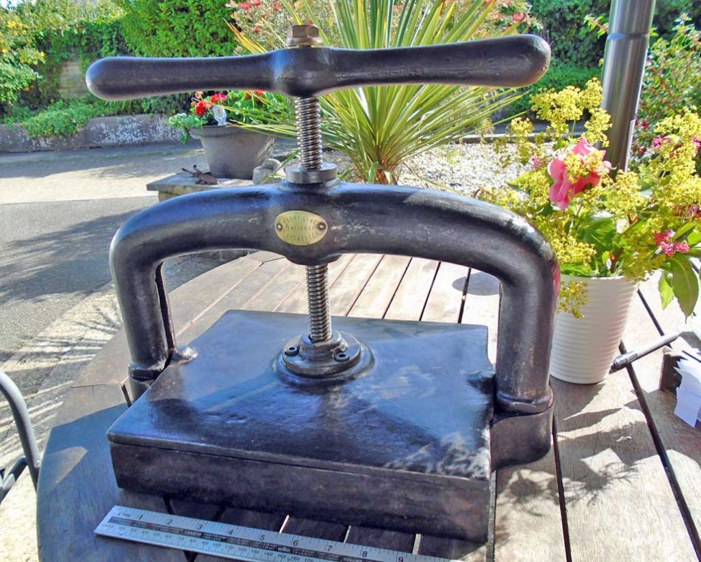

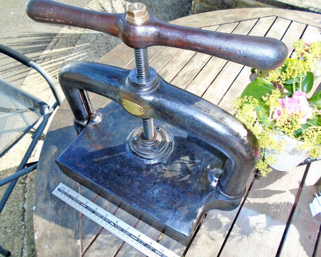

                              Martin King 2
                                @martinking2
                                Hi All,
                                Finally got the arch section bored out OK, had to turn it over for the last 5mm or so which was a bit nail biting!
                                Finished the leadscrew section and pinned both ends and loctited so all good there.
                                Gave all the castings a good going over with soft flap wheels which was a pretty filthy job, then used a phosphate coating and wax polish.
                                Looks a bit better now!
                                My thanks to everyone for all the help and advice, much appreciated.
                                Must be my week for presses, just got a much bigger one with column extensions but no normal length bolts so will have to make a couple.
                                Cheers, Martin

                                Brian Wood
                                  @brianwood45127
                                  That looks like a nice, satisfying outcome Martin, well done. A world away from how it was when you bought it

                                  David George 1
                                    @davidgeorge1
                                    Nice job in the end and nice to see the results as so many don't let us see what happened.

                                    ega
                                      @ega
                                      Very pleasing pictures!
                                      A small quibble: would it be more correct to replace the three cap screws at the foot of the screw with cheese heads?

                                      Martin King 2
                                        @martinking2
                                        Eva, You are quite correct, the original screws were cheese headed. Two of them were so seized that I had to saw them off from under the retaining plate. Then had to redrill into the old screws and tapped M8 to fit cap screws I already had. Did not want to spend more time on this as it is designed to make a profit!
                                        currently on you know where smiley
                                        regards, Martin
