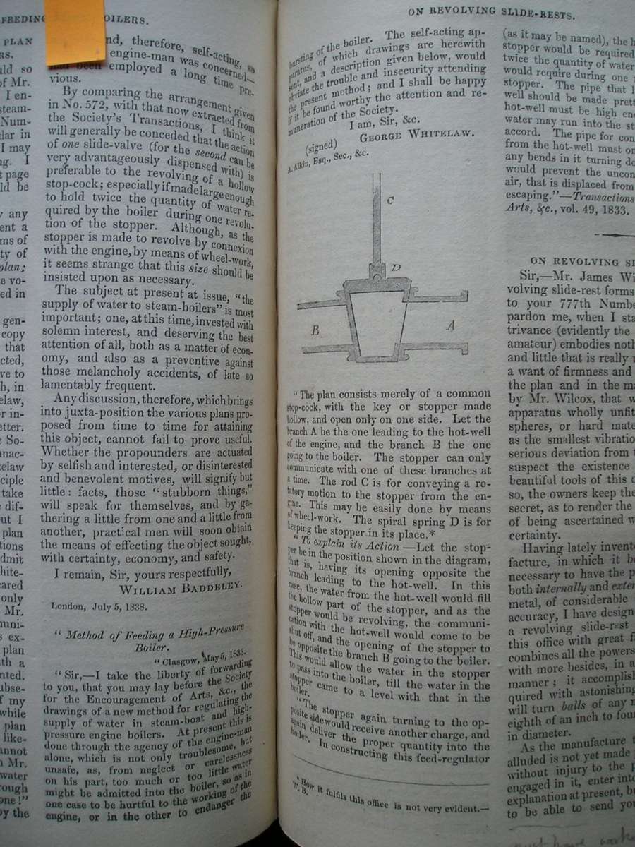

      The latest ME had a letter about injectors and boiler feed pumps, this referred back to a previous article. Having read this article, with such a silly title I hadn’t noticed it before, I have some comments.
      I am slowly reading through a large pile of Mechanics Magazines from the early to mid 1800’s. Quite by accident I came across an article that I noted down, that discussed boiler feed pumps to high pressure boilers. Copy of article attached.
      What caught my eye was the pump design that didn’t need to force feed water into the boiler against the steam pressure. Briefly it worked by filling a valve up with water at atmospheric pressure and then swapping the valve to be open to the boiler pressure. At that point the entrapped water would simply run out of the valve and into the boiler. It works on the principle that if the valve is completely filled then there is no sensible change in the volume of water.
      There are obviously losses associated with the rotation of the valve, less that forcing water against the boiler pressure? Both a feed pump and an injector are lossy devices. Either from the raise in pressure to force the water into the boiler, or the loss in energy of the steam as it is condensed. I have yet to come across an article that actually defines these losses.
      With this rotating valve there is a requirement for the feed water to be above the valve, and the valve above the boiler, so that gravity is used transfer the water in both cases. This is probably not ideal, some form of pump pressure in and out would be better. But, again, because water is incompressible then there will be minimum losses.
      Something to think about?

        Sounds rather like perpetual motion, lubricated by snake oil.
        Any pipe or vessel, at a pressure below that of the boiler, when connected to it will see an outflow FROM the boiler.
        So a “one sided” stop cock, filled with water from the hot well, will contain water that is below boiler pressure and temperature.
        How is the water propelled from the hot well into the pipe to fill the “stop cock”?
        I really cannmot see how the water could then be induced to enter the boiler against the pressure.
        Boilers are topped up by means of pumps, or Ms Giffard’s clever use of cones and venturis to convert fluid velocity into pressure, in an injector.
        For a flow, there must be a pressure differential, so that the external pressure exceeds the boiler pressure.
        If I am wrong, please explain the theory

            In principle it works, BUT
            as soon as the water filled void is exposed to steam a lot of steam will be condensed. Not a loss as it heats the water. As long as the void is higher than the boiler gravity will drive the flow
            After the water has run out, the void is full of steam. When you switch back to refill, this steam will exhaust back into the environment. I suppose you could somehow pass it through a heat exchanger.
            A injector sounds a lot simpler to me

              Looking at it in reverse, when the cavity is open to the boiler, it is filled with boiling water at full steam pressure and temperature.   Thus, when the cock is turned a slug of energy fires back into the cold-water system.  High pressure in 1833 might have been manageable, but I’d expect violent results from a slug propelled by modern high-pressure where a 10 atmosphere boiler is very much on the dinky side.
              As a result, I think the 1833 mechanism would put a small amount of cold-water into the boiler in exchange for blowing a lot of heat into the cold-water tank.  Very inefficient compared with a force pump or injector; thermally, these are one way systems that don’t give the boiler much opportunity to leak heat out into the feed system.
              Keeping a rotary valve steam tight would be an engineering challenge too.  I also think the system would consume a lot of power because the turning part is pushed hard into the body by steam pressure.   Took a few Horse Power to move full-size locomotive slide valves, which is why effort went into designing balanced and mushroom valves.  In comparison, the bearing surface of a force pump is exposed to far less friction and probably easier to lubricate.   An injector has no moving parts at all.
              So I think the 1833 system would work at low pressures, but waste a lot of heat, and I strongly suspect it becomes less practical with rising boiler pressure.
              None of my reading on steam and boilers mentions anything like this system on a real boiler.   Perhaps they were so common, no-one mentioned them!   But being a suspicious Old Henry, I guess the idea didn’t work as well as the alternatives.

                I1) As already explained, the principle works if the cock and water supply are above the boiler water level.
                2) The dollop of steam in the valve is of much smaller mass than the incoming water. Given a reasonable head of water above the valve, the steam would be immediately condensed (possibly fast enough to hammer).
                3) The condensate would go back into the boiler.
                3) The boiler pressure is tending to blow the valve out of its seat, not in.
                No, it does not seem a very practical proposition, and that is most likely why we have never heard of it.

                        Thank you for your comments. The first article was in 1826 but I couldn’t make any sense of the woodcut, so just noted it down. The second article, as copied, was from 1838.
                        The injector consumes a huge amount of energy when working, but so far not seen any figures. These articles pre-date the injector, so all locos must have used feed pumps.
                        If you rotated the valve at a certain wheel speed, then also had a small force pump running in synchronism to push atmospheric water into the valve, then 1/2 revolution later another pump to pump the water out? The whole idea here is to not have to use the pump to raise the pressure of the water in the valve from atmospheric to boiler. If the pump is full then there is no loss in raising the pump contents from atmospheric to boiler pressure. That is where the sneaky part of the pump works.
                        Not certain the idea of using gravity to both fill and empty the valve is really workable, hence the addition of a small force pump to empty and fill the valve.
