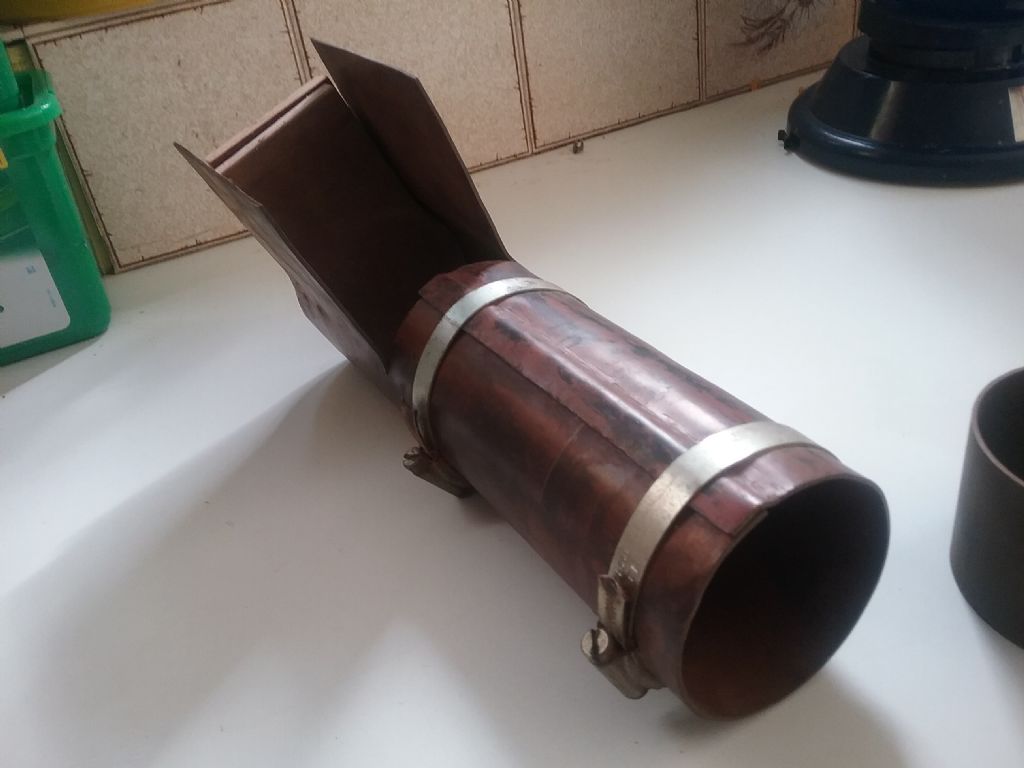

      Hi folks,
      I have rolled uo a boiler from a piece of flat sheet copper and have made a lap joint at bottom, this will be riveted and then silver soldered, is there any problem doing it this way ? The reason I done this is I had problems sourcing 31/4"" dia seamless tube I have found a source but of course there would be extra cost plus with tube extension pieces would have to be fitted at the firebox end  cheers Mick20170508_100655.jpg

        Roderick Jenkins
          @roderickjenkins93242
          I think the usual way is to have a butt strap inside the tube, this makes it easier to get a good seal with the smokebox.
          HTH,
          Rod
          #297053
            Butt strap outside is prefered as the inspector can see how the solder has flowed into the joint. You may also need to recalculate the thickness as the strength is derated if there is a joint over solid tube.
            Best thing to do is ask your boiler inspector as at the end of the day it is him who will pass or fail the boiler and some have different views to others.

              Thanks, calculate thickness of what Jason?
              Mick
              #297059
                The thickness of the barrel, solid drawn tube has a valuve of 1, single row of rivits 0.5, soldered or welded value of 0.8. *so either leave thickness as is and have a lower working pressure or up the thickness to compensate for the joint to keep the original working pressure.
                J
                Taken from Hainings "Countryman's Steam Manual"
                #297061
                nigel jones 5
                  @nigeljones5
                  Ive never checked this before but my 'industry standard' excel spreadsheet concurs with Jason's observation, there is a 20% reduction in operating max psi for a silver soldered joint (god only knows who comes up with these figures as if properly made it is at the very least as strong as the parent metal).

                    #297064
                      Posted by fizzy on 08/05/2017 13:23:48:
                      I suppose the 20% allows for the fact that the joint may not be properly made, hard to be 100% sure that solder has flowed completly through the joint particularly if rivits are a bit too tight or there is the odd gap within the joint (out of sight) that is too large for the solder to bridge.

                        I'd be tempted to check and then double check it before unrolling all your hard work. You might find that 1/16" thick or 16g sheet at 80% is still well inside the requirements and surely none of your work is lost if you need to put an external strap along the seam. Also, as you point out, the outer firebox extensions are a pain if you use tube.
                        The main question for me is which data do we use to check whether 80% of the sheet thickness is ok?

                          duncan webster 1
                            @duncanwebster1
                            16g tube at 3.25" OD is plenty thick enough for the 80 psi I suspect your boiler is designed for. I wouldn't use the joggled joint, as Roderick says the norm is to have a butt strap.
                            What you will have to watch out for is the stay pitch, which will be quite small for this thin material.

                              Posted by duncan webster on 08/05/2017 19:15:15:
                              But it's no longer a (seamless) tube so at 80% it is effectively 18g tube.
                              As I said speak with your inspector as you are deviating from the published design, he may be happy for you to carry on, he may not. Best to find out now before investing more time and money into the boiler.

                                The problem with a tube is that the outer firebox wrapper has to have extension pieces butt strapped on the inside silver soldered in order to reach the foundation ring, does this make fitting the throatplate more awkward? Boiler steams at 80lb test pressure 160lb, so if I use 64lb working pressure and test to128ln will the engine still steam satisfactorily?

                                  I put the numbers through what is probably the same spreadsheet that Fizzy refered to and you should still be OK with what you have and still be over a decent factor of safety BUT don't take my word for it check with the boiler inspector.
                                  As Duncan says the stay spacing on the flat areas is the one to watch, what stay spacing do the drawings show and also what thickness is the firebox

                                    Firebox wrapper 1/16" same as boiler barrel, throat,smokebox,firebox backplate, and backhead all 3/32"thick, stays 16 of on each flat side 3/4" apart, perhaps I could use a 3/32" buttstrap on barrel seam. Your advice on talking to a boiler inspector is the way to go

                                            Just to back up what Julian says, with a 1/16" wrapper and 3/4" spacing of the stays punched into the spreadsheet the stayed surfaces come below the factor of safety used which is 5 and therfore below the desired working pressure.
                                            And further to Phil's comment about 1/16" (0.0625) being surely OK in place of 16g (0.064" ),
                                            1/16" material puts the stayed areas below the factor of safety
                                            16g is enough to tip the balance putting headed stays just over the factor of 5, 5.01 to be exact!

                                              I' m getting confused now, just miked the copper I have used for boiler and it is 0.065" , Martin Evans book for Rob Roy says 1/16"– 16 g, copper and the stay details are from his book also, my mistake for saying 1/16"" instead of 16 g from Jasons calculations this just meets the safety requirements needed , I shall procede with caution thanks for the help gents it is much appreciated

                                                  Mick, you still need to watch what type of stay you use, as I said headed stays just come over the 5 but unheaded eg plain rod or poking a rivit through the hole will only give about 4.
                                                  Once again check with your inspector before proceeding with caution.

                                                      As promised, the extract from the book by Martin Evans;
                                                      'Model Locomotive and Marine Boilers, M Evans, 1988 (reprinted 2011)'
                                                      P27,
                                                      P = D x F x WP / S x R x C x T x 2 where P is plate thickness (inches), D is outside diameter (inches), F is safety factor, WP is working pressure (lbs per sq inch), S is UTS (lbs per sq inch), R is rivet allowance, C is corrosion allowance and T is temperature allowance.
                                                      According to Mr Evans…. Safety factor is between 6 and 10 with 6 too low and 8 is acceptable., UTS for copper is 25000 lb per sq inch, no corrosion allowance for copper, temperature allowance of 0.8 for copper working at 80 lb per sq inch (Rob Roy working pressure).
                                                      Rivet allowance for silver soldered joint is 0.8.
                                                      Plugging in the numbers gives;
                                                      P = 3.25 x 8 x 80 / 25000 x 0.8 x 1 x 0.8 x 2
                                                      = 0.065 inches. so the 1/16" is fine considering the range of the safety factor.
                                                      Jason – does the lower safety factor for stays apply to the other parts like this barrel thickness?
                                                      I understand that Mr Evans has his critics but I would be really interested to know what data any inspector actually use these days. It is all very well saying 'go see an inspector' – but what do inspectors use? This should not be wrapped in a black cloak or worse – a computer spreadsheet/ software.
