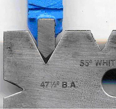

        Hi All,
        This is a posting more for the beginner than the experienced modeller/turner.
        I need to turn a Whitworth thread and this requires a 55º included angle lathe tool. As I lost my collection in a fire I decided against trying to grind up an HSS one as the job is a one off and my tool grinding rest is non operational at the moment. So I decided to buy one and ordered a 55º brazed tip tool from a major supplier.
        I immediately recognised that it was not the correct 55º angle as soon as I saw it, and on measuring it is actually 82º smile o.  I might not have noticed it in my excitement if I were a beginner and could have ruined a job on which I already have invested considerable turning time crying 2.
        Obviously the supplier will replace it but it is an inconvenience and fortunately me and them are going to the same Midlands show this weekend, but it has cost me several days and I don't want to remove the job from the lathe if I can help it as concentricity is important in this particular job.
        Here is a scan of the tool and a setting gauge to show the problem and act as a warning to always check that you have received the correct item when ordering remotely.
        supposed 55 lathe tool.jpg.
        Best regards
        Terry
        Edited By Terryd on 13/10/2012 12:44:02

          Sorry about that Terry, even if it was the correct angle, even one of my home made ones would not be that rough, do you mean to say they where trying to sell that thing? Ian S C

            What a terrible looking object, tool is too good a word .Perhaps you should have it carbon dated?

                          A quick look around the usual suspects and it would seen the cutter cost £3.17 but go to another supplier of better quality tooling and you will be looking at £11.97 assuming both are 3/8 – 10mm thats almost four times the cost
                          Its just the usual that you get what you pay for, if things are made to a price you won't get top quality at bargain basement prices.
                          Maybe the thread should be retitled "beware of cheaply bought lathe tools"
                          J

                              Every brazed tip tool that i have brought has required to be sharpened. This included a multi tip face milling cutter that came with a second hand mill, The first owner had tried the cutter and saild it was hopeless, i sharpened all the tips and find it cuts OK.
                              So my point is even if you ordered a 55 deqree point tool, i would not expect to use it without a touch up on the grinding wheel.
                              I know that this means they can supply the same tool what ever the angle you ordered.!!!
                              This only applies to brazed tip tooling tooling, HSS tooling i find if better finished.

                                The Sale of Goods Act – designed to proect consumers from unsafe and/or shoddy goods states among other things,
                                Goods should be as described.
                                If a tool is described as 55º that is what it should be, not 55.5 or 49.5, certasinly not 82º and there is no reason or difficulty why that cannot be done. By accepting shoddy goods and modifying ourselves we are encouraging manufacturers and suppliers that it is acceptable. Besides, many of us don't have the facilities or skill to grind brazed tip tools especially to accurate angles.

                                  I use some brazed tipped tools on a couple of jobs where inserted tooling isn't suitable because of bulk.
                                  I pay a lot more than £5 or £6 per tool but they still come semi finished, a quick lick on the diamond wheel soon gets them nice and sharp.
                                  Jason is also correct in that you only get what you pay for.
                                  Anyway I can't see much wrong with this threading tool other than a quick lick, if you are threading PG fittings even the angle is pretty good as they are 80 degrees smiley wink
                                  John S.

                                    It would only have taken 5 minutes or so to have ground an HSS tool to 55 degrees, you've got a tool angle gauge, it would have been a far better job than buying that rubbish that you did buy, and wouldn't have cost you anything.
                                    Richard.

                                          This tool doesn't need to be "touched up" as some people quote, it's a complete regrind if you have a Silicon carbide or diamond whel to hand. I'ts also irrelevant if some of you guys can grind a screw cutting tool in 5 minutes, a lot of people can't!

                                            Unless you are on CNC or have Grahams quick release clutch I can't see any reason to use carbide on a manual lathe for threading.
                                            Carbide is very fragile, it's only a powder after all and unless run at the correct feeds and speeds it won't perform correctly.
                                            As you have no control over feed, that's determined by the pitch, all you can play with is speed but as that's linked at a far higher rate that you can work the reverse or half nuts it's a waste of time and money given you will chip more tools that using HSS which operates at a far lower range.

                                                Grinding lathe tools is the most basic thing we do when starting to learn lathe work,
                                                If you don't have a go at it , then you'll never get the hang of it, It's not clever or wildly technical, it's just got to be right for the job you are doing at the time.
                                                If you've got a threading tool angle gauge ( probably less than £5 ) and a grinder, you'll never need to buy any threading tools at all.
                                                Like John says, there is no need for carbide threading tools on a manual lathe at all,

                                                  I agree that you only get what you pay for and accept the shortcomings, but I paid for and was supplied with ostensibly a 55º tool as I said in my original posting to cut a standard Whit thread. I was not after long lasting tool, just a one off small job. As far as I am concerned it is disposable.
                                                  It was advertised as a 55º tool and that is what should have been supplied. If it were 57º then I agree it could be touched up with a diamond hone. But as it is over 80º it needs more than just 'a couple of licks'.
                                                  I much prefer HSS and when my grinding rest is up and running I will use that to produce a reasonably accurate one next time.
                                                  I was just trying to warn newbies to be on their guard in my OP.

                                                    While I agree that the "tool" you bought appears to be not of merchantable quality, I don't quite understand why you had to wait a minimum of overnight delivery to get one, and now wait to get a replacement. I hope you don't take this as antagonistic but surely you had have a bit of HSS left from pre-fire days, I would be even more surprized that you don't have a threading one of some description, and a grinder MUST have been one of your first purchases post fire. There is no way that HSS tooling would have been affected by a domestic house fire, save for bit of discolouration, and so should still be useable.
                                                    Now, as to loosing concentricity don't you have a four jaw? i would have thought that a man of your experience would not think twice about taking out and then replacing a work piece as many times as is needed.
                                                    Now, again, assuming you do have a tatty old bit of HSS to hand but don't have a grinder, yet (limited budget quite understandable), a 6" self adhesive abrasive disc stuck to an old bit of MDF, and spun in a lathe, makes a perfectly useable grinder. The fag of having to cover the bed ways out weighs waiting till the Midlands to get a replacement any day in my book.
                                                    As I said this is not meant to be antagonistic, so don't get all het up at what is meant to be helpful advise. It is just that, although I am a patient man, i would never let the lack of a simple tool bit stop me if, with a few minutes and some means of grinding, I could get one straight away.

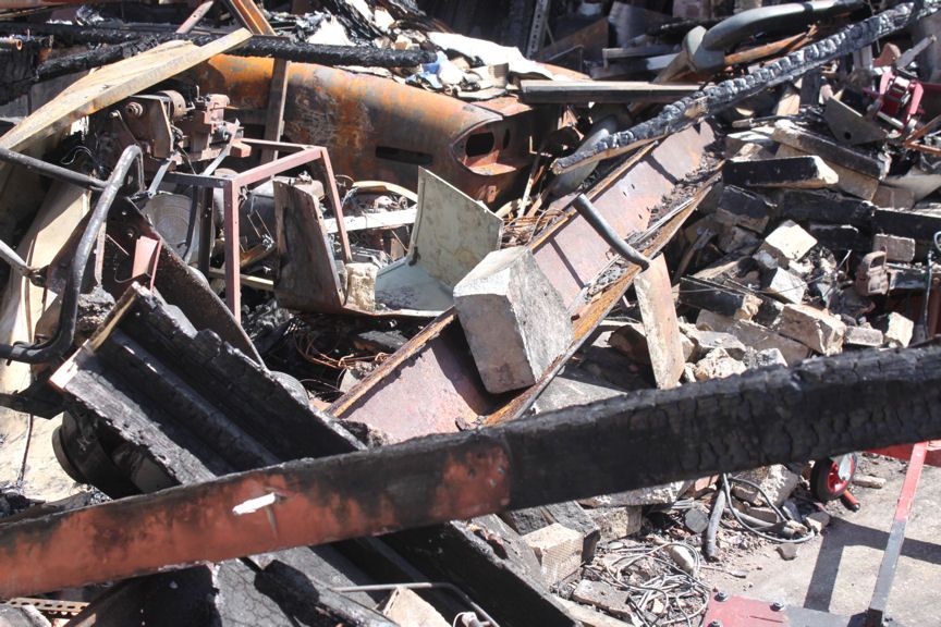

                                                      Most of my tooling was lost in the genreal debris after the firemen had thrown everything around to get at the smouldering embers and I was not allowed to enter as it was unsafe. I saved what I could but it was precious little. Until you have experienced one of these it is amazing how much debris and carcoal there is and th emen engaged to clear the site did a thorough job of it. My concrete floor had around 50mm of wet charcoal covering everything from the substantial wooden timbers and roof. It was wet due to the firemens efforts and 2 weeks of rain following the fire. The temperature was enough to cause an 8×4 RSJ to bend like a bow.. The damage to the HSS tools is mainly rust.. Just to demonstrate, I attach a couple of pics to show the devastation after the fire and the firemen had done their best.
                                                      I an quite capable of grinding general lathe tools but my eyes are not up to the accuracy required for a threading tool and as I have pointed out my grinding rest is not yet refurbished. Many folks find it difficult enough to grind up even basic lathe tools without a Worden or similar.
                                                      As for the 4 jaw, you are correct, I find them no problem to accurately locate work and am surprised when others do have problems, but it's a bit of a fag with these modern bolt on fixtures, it's just another chore I'd rather not have to do it I can help it.
                                                      And you are right, As I said in my first post it was aimed at newbies, I was not complaining just pointing out that problems have happeed somewhere in the supply chain and that they should be aware o fit. I also said that I am sure that the reputable supplier will change it. I must say that I am finding it a bit tiresome when some posters jump to conclusions without reading posts properly and miss the intentions, I must admit to being guilty of it at times though myself.  Click on the pictures……   If you dare……..disgust
