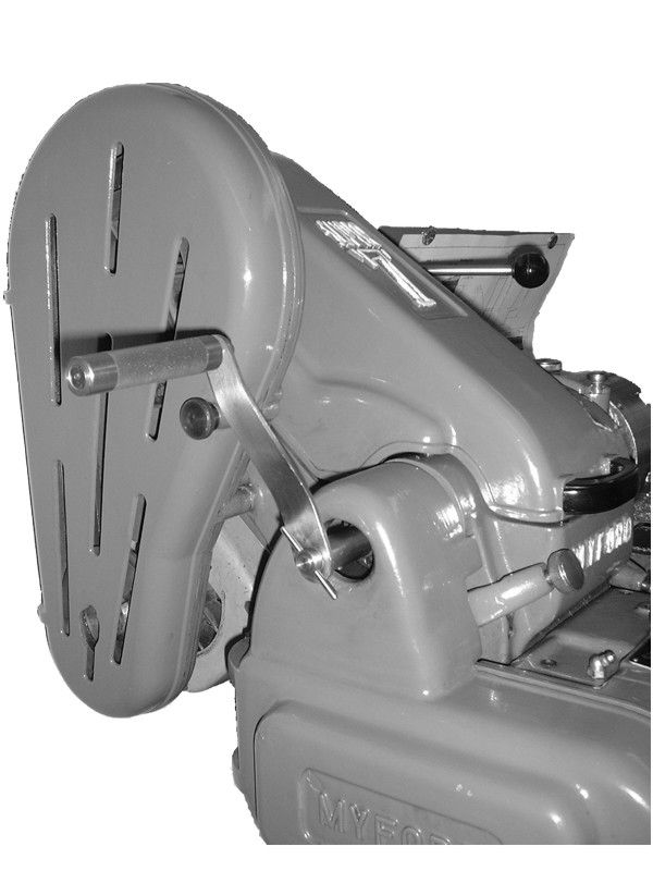

      I'm sure this should be a simple one: I'm making the Hemingway Myford Spindle Driving Handle (mandrel handle) and I need to bend two angles on the 1/8" thick mild steel bar for the crank (around 7/8" wide). The bend radius is not critical, though the two angles need to be 'reasonably' accurate to ensure the two ends of the bar end up parallel (like a Z, though with obtuse not acute angles). I have already shaped the piece and drilled the two holes.

                    If this is the driving handle. You should be able to just hold each end in a vice and bend it by hand. For a bit more leverage use a large shifting spanner (universal metric/imperial tool that fits every nut), or wack it with a hammer as suggested.
                    Note: If you have to make a tight bend or bend thicker steel, it has to be red hot at the bend. You have to be quick and do it while it is still red.
                    Paul.

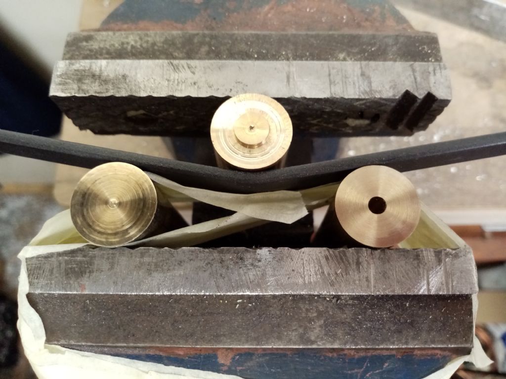

                            Simples just use the 3 pin/bar method, cut 3 pieces of steel bar in your case about 1 inch diameter or use whatever you have its not critical and tape them to your vice see pic below.
                            Place your steel between them making sure its horizontal and the 3 bars are vertical but again not super critical. Tighten the vice until you achieve the required angle. Your 7/8" x 1/8" bar will bend easily in your large vice with little effort.
                            A pic below of a quick set to give you the idea, no heating, cutting or bashing.
                            p. s. If you want a tighter bend just close up the centres between the 3 pins and use a smaller dia on the single pin though depending on the angle it may need spacing off to allow clearance between the bar and fixed jaw. Also if you want more of an angle you can use larger dia pins to give more clearance between the vice Jaws.
                            Ronf

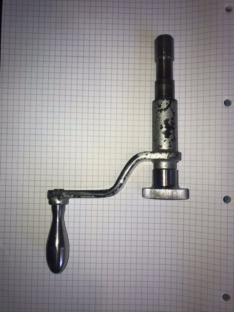

                                            This is the similar handle I made and it is very useful if you don't have a VFD with jog function. I use it for thread cutting with taps and dies and also screwcutting. Even used it to true up the lathe motor drive pulley!
                                            However, if you start the lathe with it still fitted and it whacks your elbow, it don't half hurt. So make it a habit to disconnect the back gear, turn the reversing switch to off and turn off the main power when you fit it.

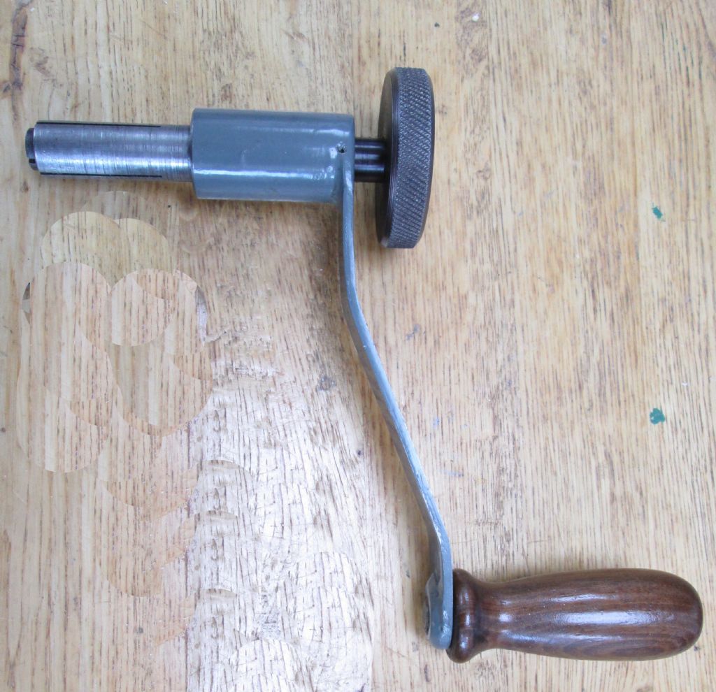

                                                This was my effort, the crank was cold bent from 6mm mild steel in a 5” vice, a bit of work with a file cleaned it up and a good friend welded the boss for the handle and the other end to the main shaft. It was a completely ad hoc build and turned out to be functional. Being a thicker piece of material and the dimensions not critical means any marks from the hammer can be dressed away with a file to tidy it up, the edges were given a radius to improve the feel when handling.
                                                Mike

                                                  Very nicely done, Mike
                                                  Looks like it was ‘meant to be’
