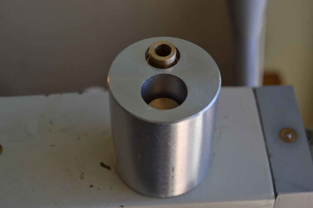

    Gas_mantle.
      @gas_mantle
      Hi all,

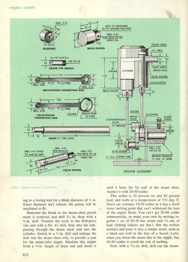

      As a complete beginner to this hobby and someone who has only owned a lathe a few weeks I feel I'm now getting past the 'swarf making stage' and have decided to try and built my first steam engine.
      I've decided to have a go at this :-
      **LINK**
      If it proves to be beyond my skill level I'll put it to one side for a few weeks till I have the necessary skills and/or tools to do the job.
      The plans are in imperial but I've decided to work in metric (my lathe and measuring equipment are all metric) so whilst I am working to the basic design the measurements are flexible and I'll modify / embellish it as I go along.
      As I say I am a complete beginner so if people want to offer me advice or tell me better ways of doing things I'm more than happy to listen.
      Here goes :-

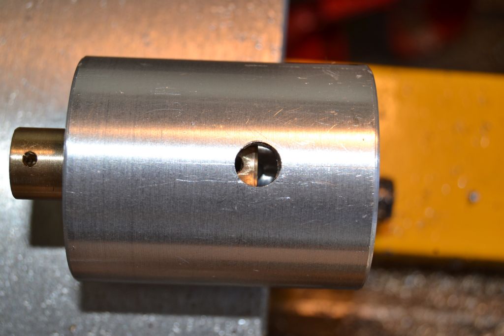

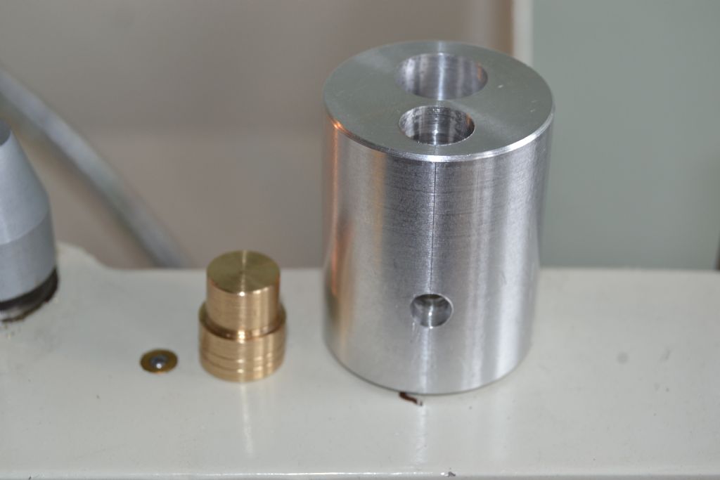

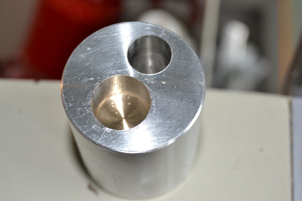

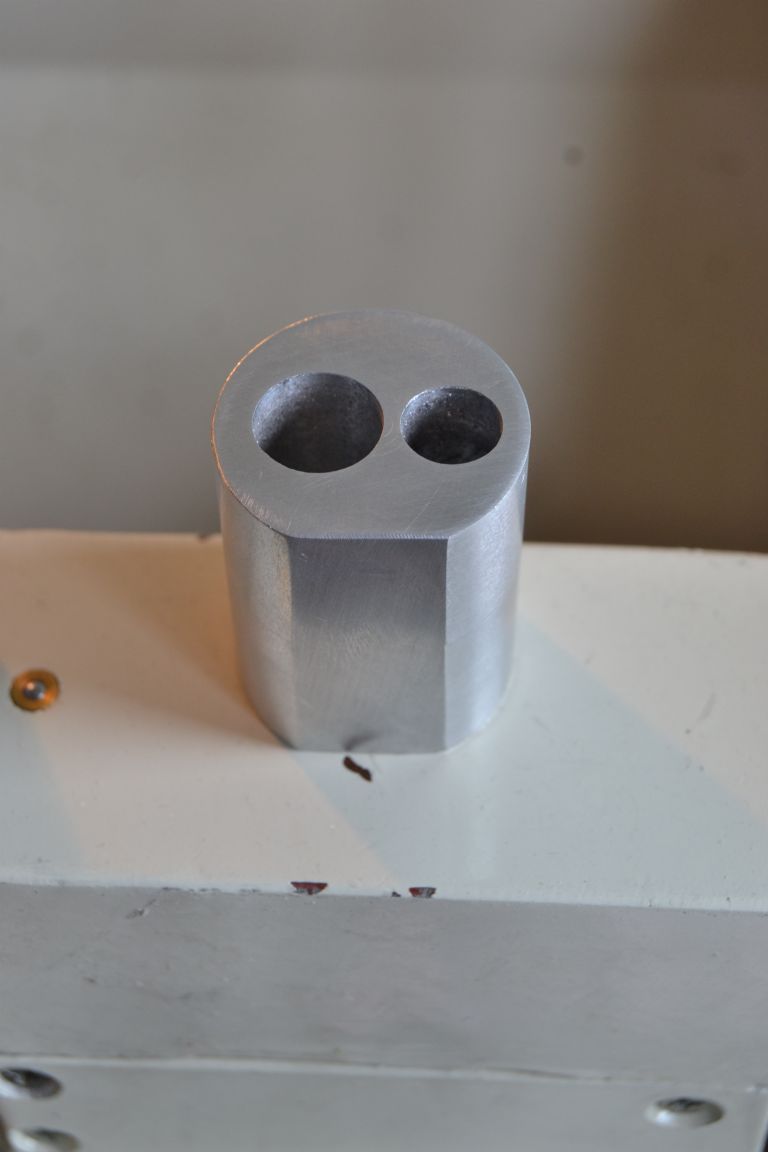

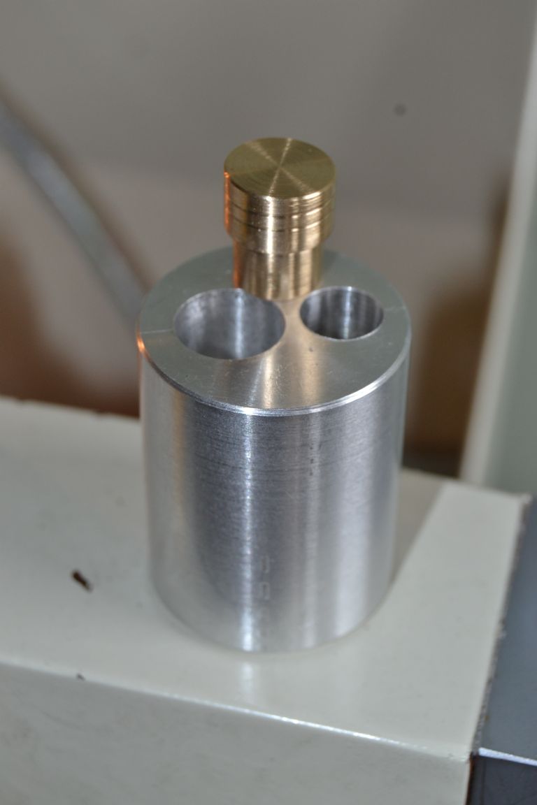

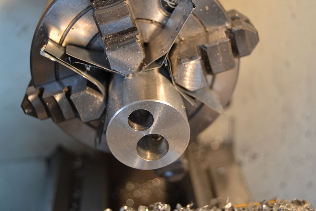

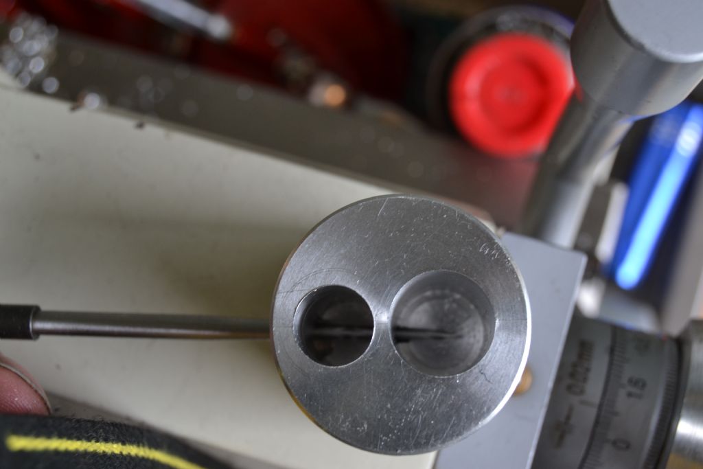

      Firstly I decided to machine the cylinder block / steam chest, I didn't have a piece of brass big enough to hand so I settled for aluminium (It's unlikely the engine will ever see live steam so I figured aluminium will do for compressed air).
      Block turned and faced to size then power piston bore done.
      Steam chest bore done, I decided to make this slightly larger diameter than the plans as I think that may prove more forgiving at my skill level.
      Ready to begin drilling inlet port.
      Drilled through as far as power cylinder, I was a bit relieved at this point. With my limited tools and experience I wasn't certain how parallel the bores were etc. However once the inlet was drilled through my scriber seems to suggest they are reasonably true.
      I decided to omit mounting holes for the cylinder at this point as I'm not yet certain how I'll go about it but will probably deviate from the plan.

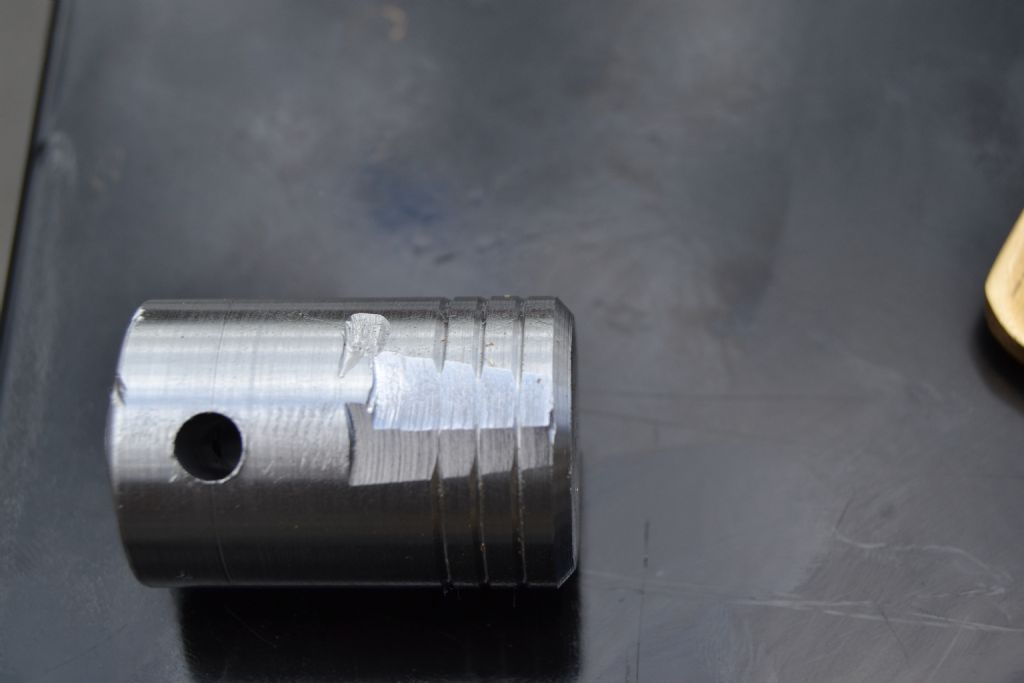

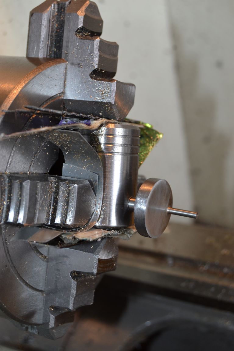

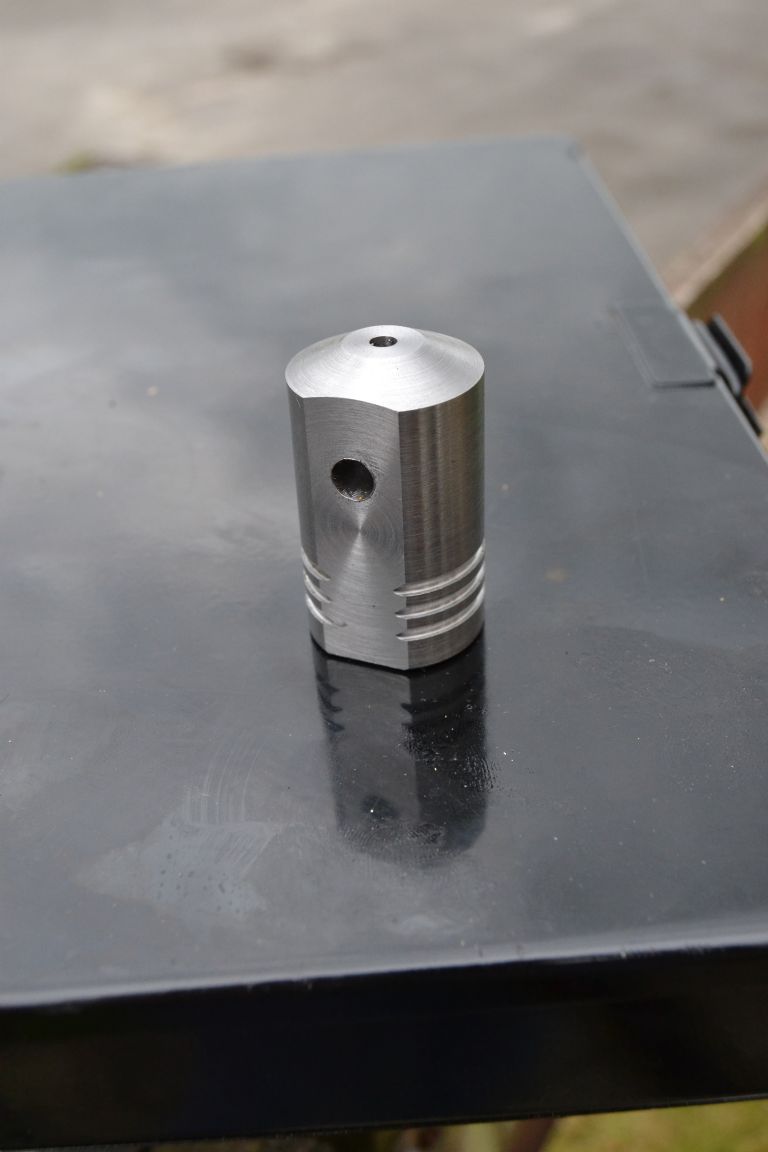

      So – I decided on the piston next. This time I had a suitable piece of brass
      I did damage the first piston when I turned it around in the chuck but had better luck second time
      I decided to cut in a couple of very small oil rings that aren't on the plan but I thought they may help me get a better airtight seal.

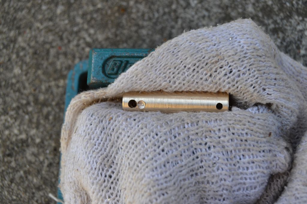

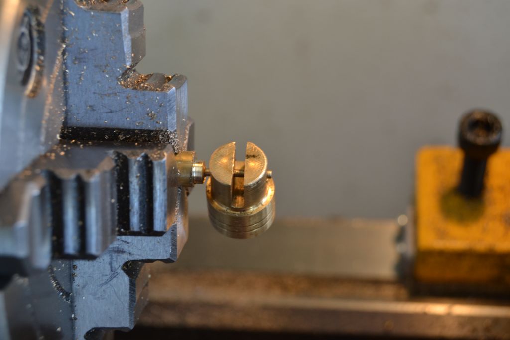

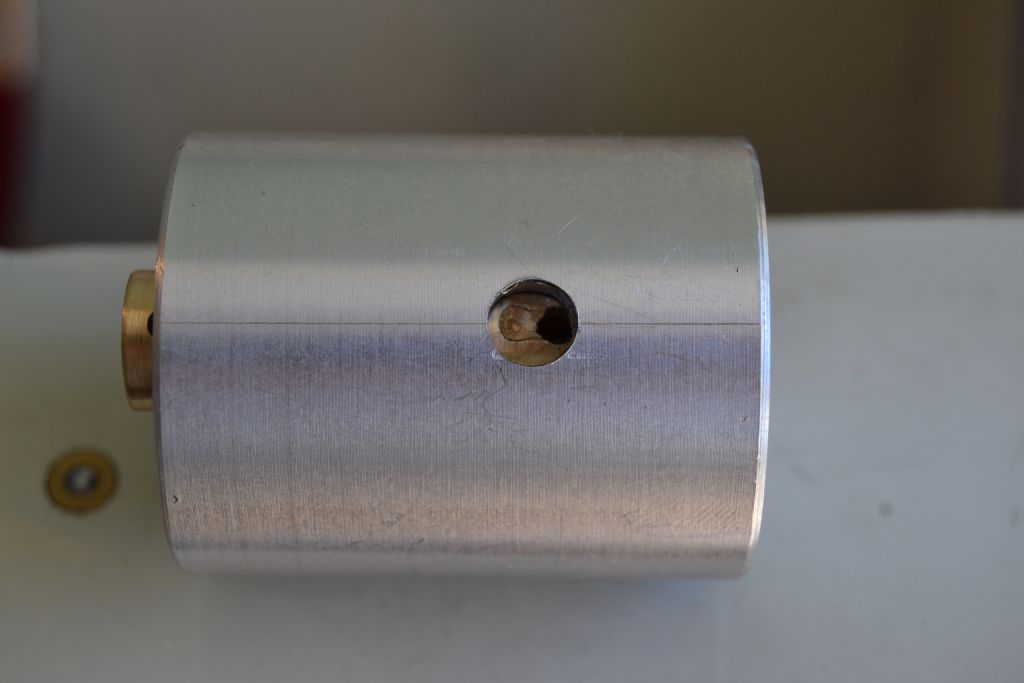

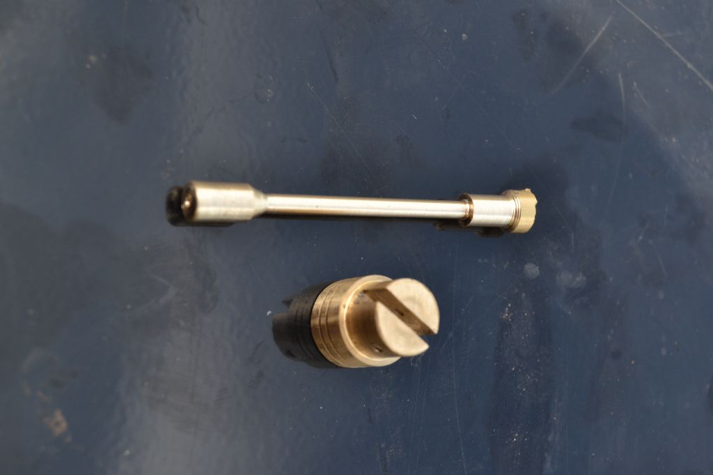

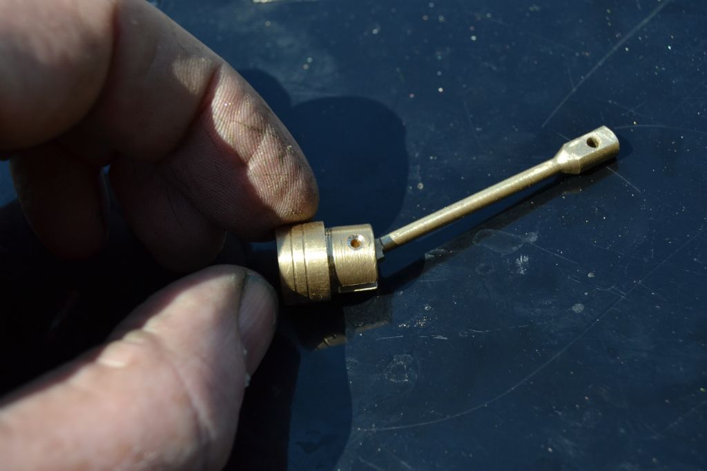

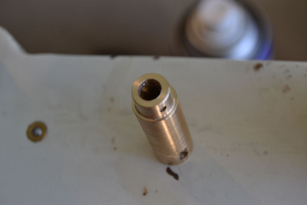

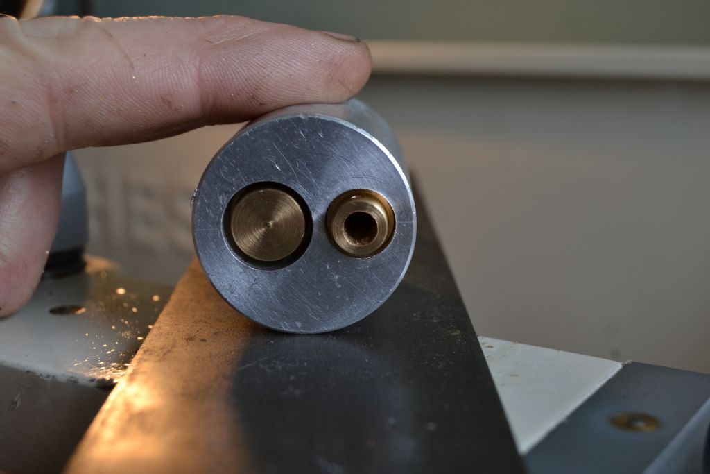

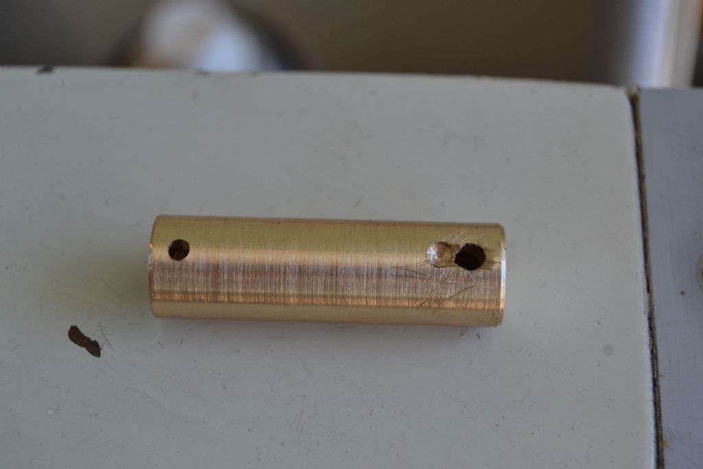

                                Today I thought I'd have a go at making the valve/exhaust piston, It's basically just a brass cylinder bored through to a blind end just a few mm before passing right through with an slotted exhaust port bored in at 90* to meet the central bore.
                                Firstly I faced, turned, and bored out to fit the cylinder bore.
                                To drill the exhaust port I decided that without a bench drill I'd probably be just as well using a rechargeable power drill. I realise that isn't a precise method but I'm only wanting to drill 2mm holes only 2-3 mm deep and minute accuracy isn't crucial. As can be seen the hole and adjoining recess aren't perfectly aligned but I think they will meet the requirements
                                I struggled to file the slot alongside the exhaust inlet and although it's not attractive it does appear to be the right size and in the right place.dsc_0020.jpg
                                This photo shows the piston valve at it's furthest travel so TDC will be just slightly short of this position, so for now at least I'm satisfied the valve will align with the port correctly when turned 180* to face the power cylinder port.
                                The next photo shows the top of the valve piston with the inlet port for the power cylinder just about visible at the back. So I'm hoping that once the valve piston has been rotated to face the power cylinder port the exhaust will line up near TDC. Well that's the theory anyway !dsc_0026.jpg
                                The valve piston now with a shoulder turned at the con rod end (that I should have done earlier but forgot !) All the remains is to cut a slot to accept the con rod.
                                Both pistons and the cylinders almost complete.
                                Peter.

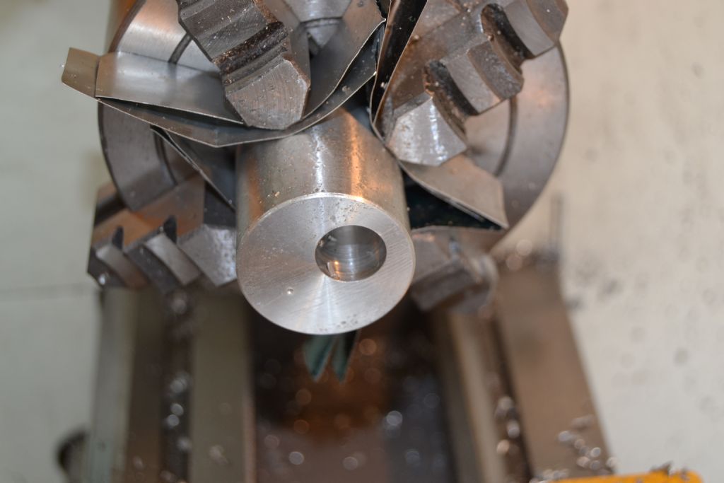

                                #195244
                                Gas_mantle.
                                  @gas_mantle
                                  Hi,

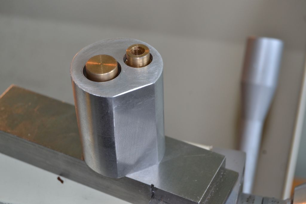

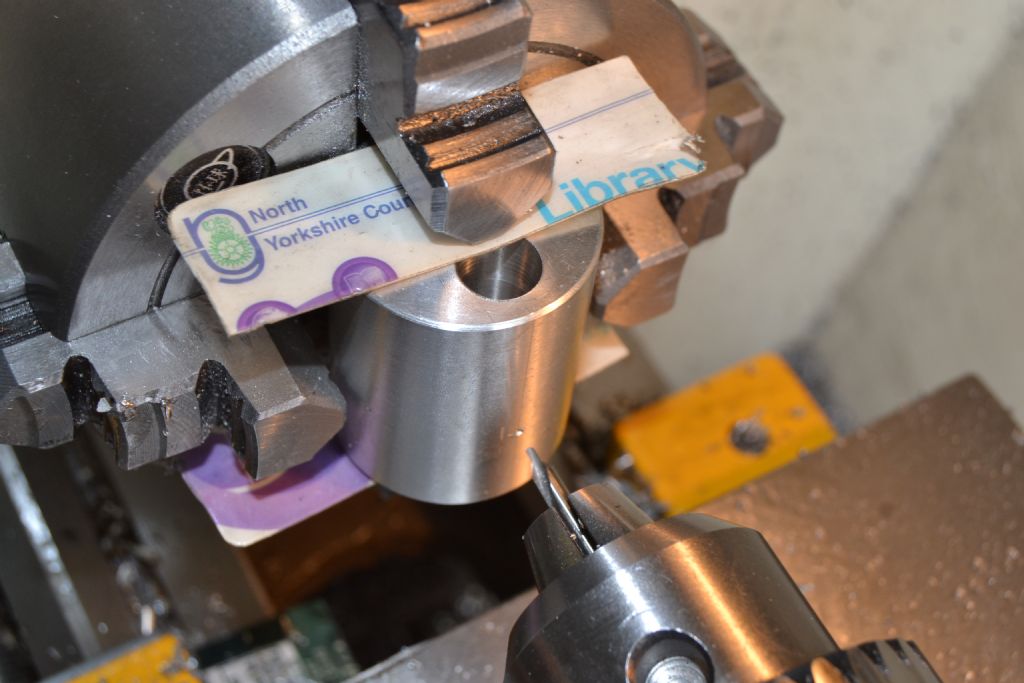

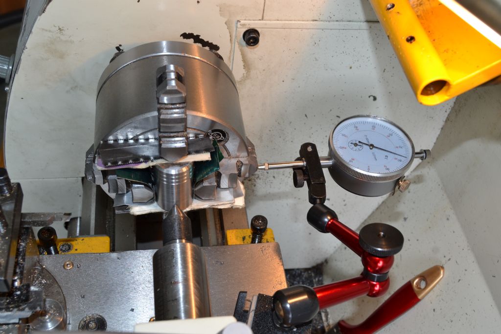

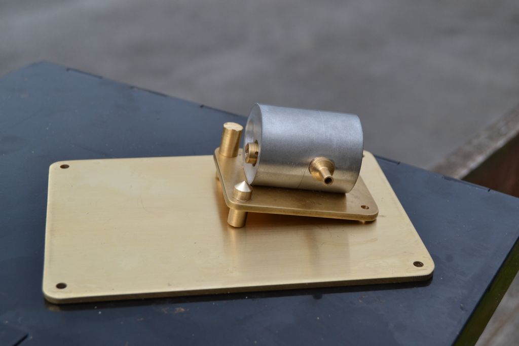

                                  Although the plans have this as a vertical engine I'd prefer to have it as a horizontal so have been doing a lot of thinking how I might best go about it. Part reason I didn't try a 'wobbler' as a first project was that without access to a milling machine I didn't feel I could reliably file the necessary flat face by hand with sufficient accuracy.

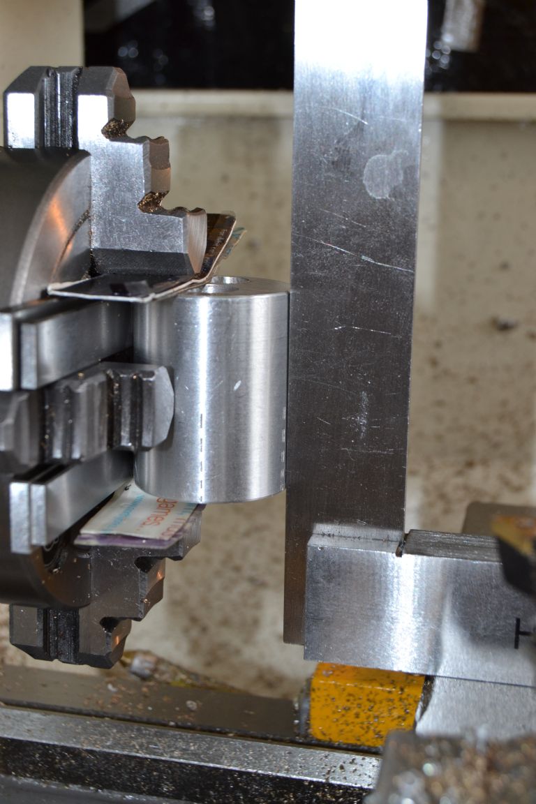

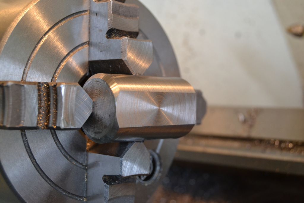

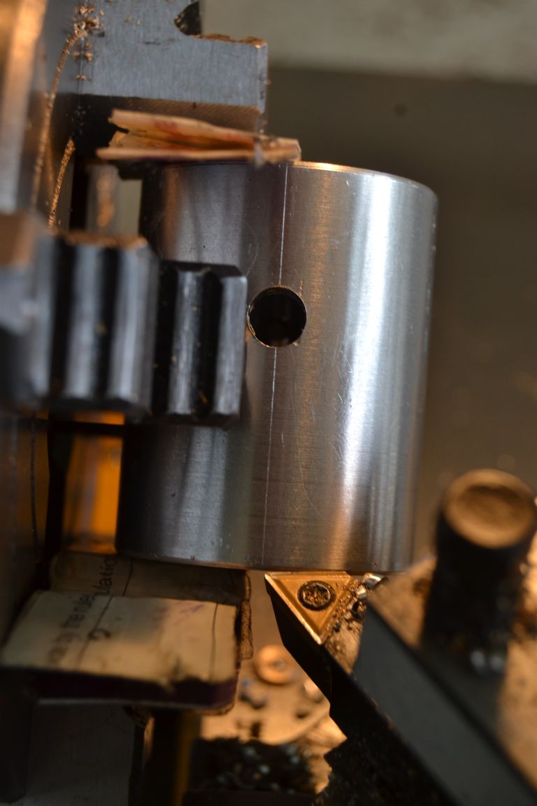

                                  After some helpful advice from other members here they suggested I could face off a piece placed a cross the lathe chuck if I was careful about it.

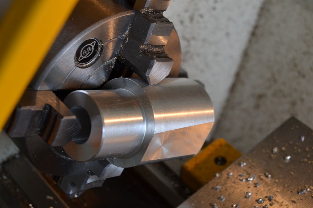

                                  I decided I wanted to bottom mount the cylinder block and reasoned the only way was to face off in the way others had suggested, with the intention of bolting it to a plate. The cylinder walls are fairly thin and bottom mounting seemed the best option.
                                  I decided to have a test run with a piece of similar sized aluminium and sure enough it worked with ease. At least now I know that till I get a mill it is possible to do very basic 'milling' in the lathe. As this was only a test piece I didn't go to the trouble of lining it up properly but you get the idea.
                                  I figured that lining up would be a problem but with the use of parallels and a few faint scribe markings that were still left from earlier drilling operations I could just about manage. I used the tool point to align with the scribe markings and rotate the work by hand in the chuck 180* whilst not moving the tool.
                                  In order to get access to the scribe markings along the centre line I needed the work out of the chuck slightly beyond its diameter so it's actually only being held firmly by the 2 flat ends with the other 2 chuck jaws gently touching the curved sides. I realise that's far from ideal but the intention is to take light cuts on a soft material and I have got a very firm grip of the flat ends of the work.
                                  Success ! – A bit of filing and tidying up to remove a few minor scrapes and chuck marks and also seems to be ok.
                                  Edited By Peter Nichols on 28/06/2015 15:34:48

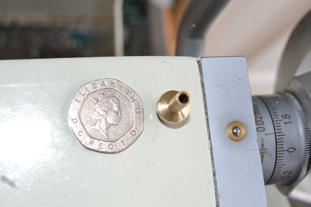

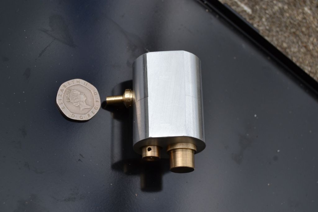

                                      I'd have liked to start on the con rods and possibly the main axle/crank next but decided I'd be better getting the cylinder mounted on a brass plate and on a piece of scrap wood for now, then I can look at where the crank needs to go etc and finally make the con rods to suit. I indend to make the rods out of round brass bar rather than the flat strips in the plan.
                                      I'm looking at buying a small compressor/airbrushing kit (about £65) as an air supply as the airbrushing is bound to come in handy as well but I did notice aquarium airline on Amazon – £2 with free delivery ! so I ordered some.
                                      Till I've decided how best to clean up the brass base plate I thought for today I'll just do the airline fitting, I didn't think ahead at the time but I decided to risk drilling it out to cut an M8 thread into the cylinder block as I think anything smaller wouldn't pass sufficient air.

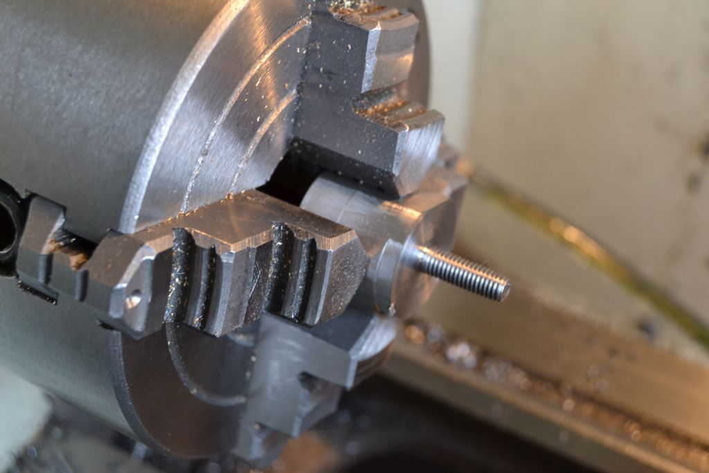

                                      The result meant I have an M8 to 4mm airline fitting bored through to 2.5 mm, I wanted to try and bore it out a bit more but though I'd be pushing my luck
                                      I can't say I'm overly happy with the result but the likelihood is it will only be a temporary measure and it does look like it will do the job till I come up with a better idea.
                                      Peter.

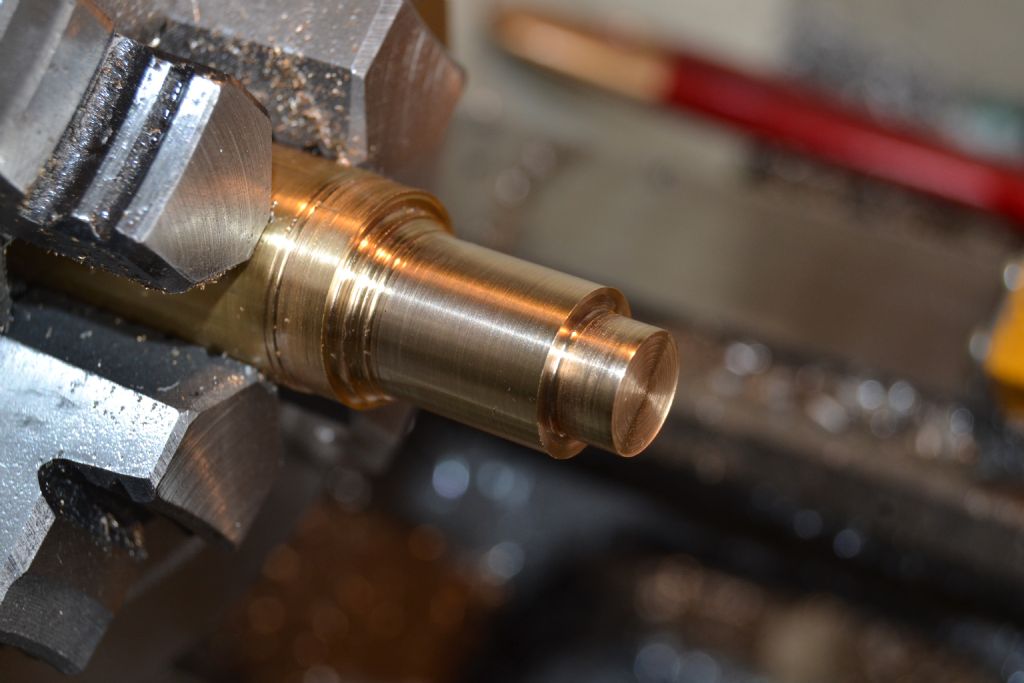

                                                #195706
                                                Gas_mantle.
                                                  @gas_mantle

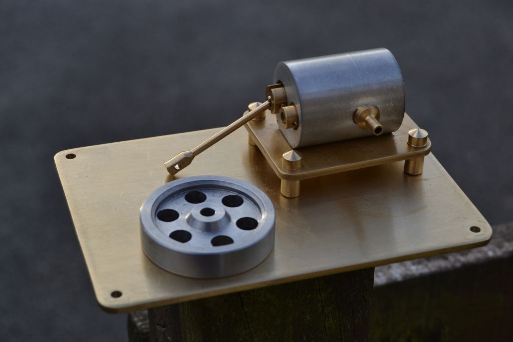

                                                  Hi all,

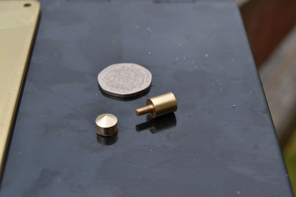

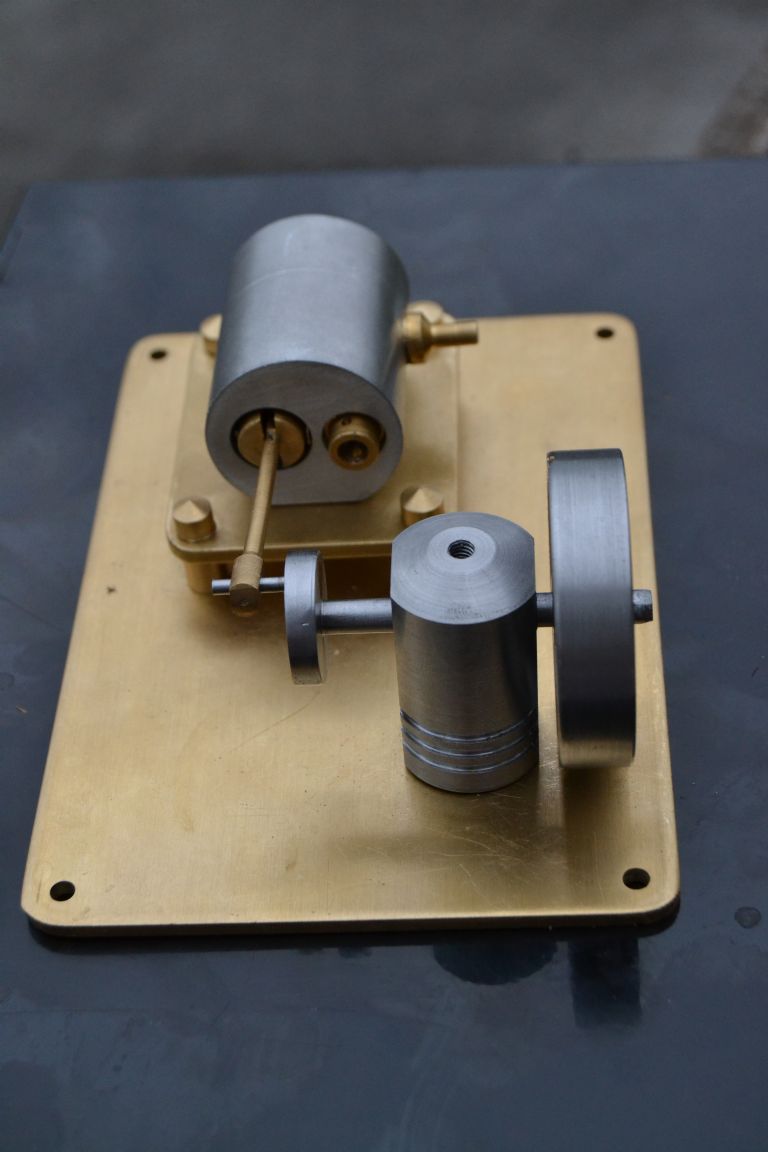

                                                  Since I've now decided the engine will be a horizontal rather than a vertical as in the plans I was faced with how to raise the cylinder block a little so that the line of the pistons travel will be in line with the main axle / crank assembly.
                                                  I took the rather unorthodox step of raising it on a small brass plinth. (I have limited materials and tools to work with) It may be unusual but I'm satisfied it will work and at least look presentable.
                                                  I decided to make the legs appear to be one piece although they are a glorified nut and bolt.

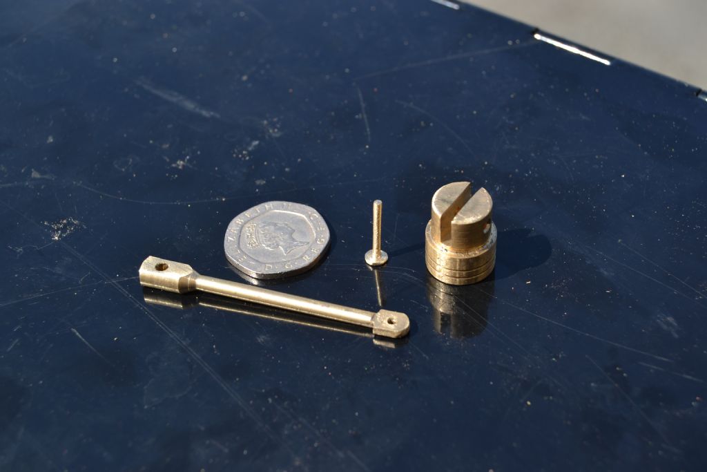

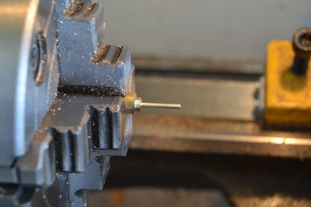

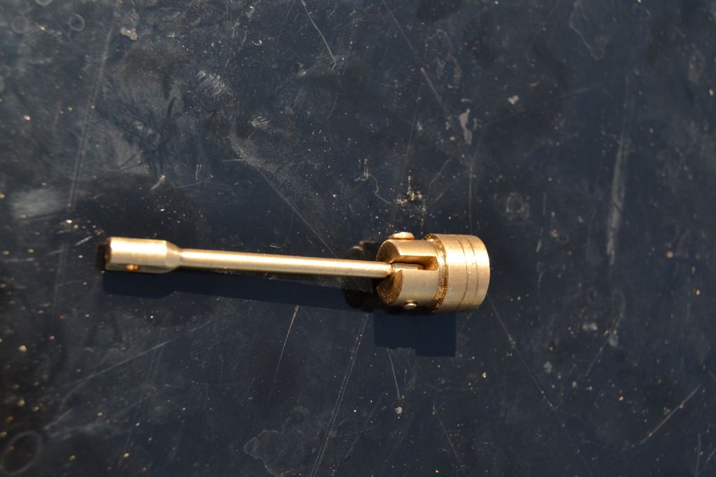

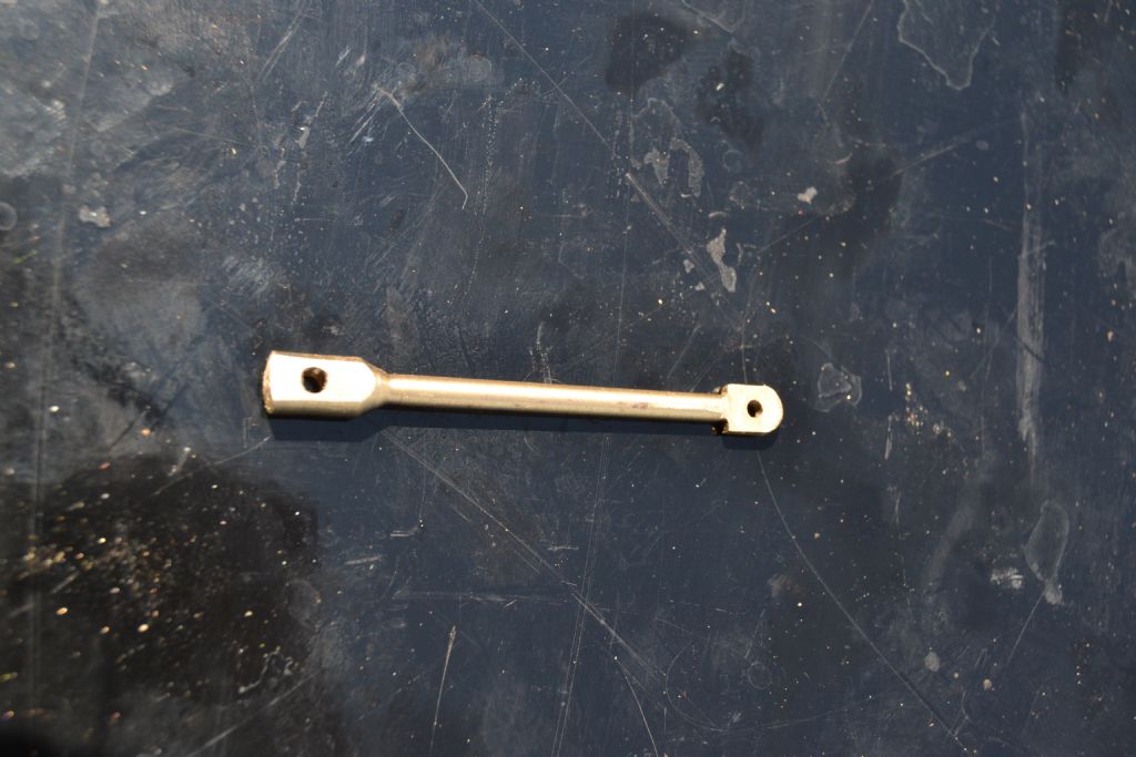

                                                  Next I opted to make the power piston con rod, I decided I wanted to make it out of a brass rod turned to size with the ends filed and drilled by hand.
                                                  Since the diameter isn't critical I decided to turn between the chuck and a centre and hope I could get it thin enough to look right. I was pleasantly surprised that using this method and a bit of care I was able to get to about 3mm over about 60mm
                                                  Half an hour of filing and drilling to arrive at this
                                                  So far I'm reasonably pleased with the result and ready to make the piston pin. The holes in the piston and con rod are 1.7mm so I'm hoping I can turn a short rod down to 1.5mm ish.
                                                  The pic below is at 1.7mm and just slightly too large, the only way I could figure out to get a few more cuts was to support it by holding a pen behind the work opposite the cutting tool. Not a very precise method admittedly, but it did work on a small workpiece where a good finish isn't important.
                                                  A few more careful passes and hey presto 1.5mm, just enough to allow the piston free movement.
                                                  I chose to keep a 'head' on one end of the rod and lightly pein the other end.
                                                  Which then nicely leaves me to its current state, with a flywheel I made a couple of weeks ago. The wheel wasn't made for this engine and needs tidying up to remove some grooves but with a bit of work may be suitable.
                                                  Starting to look a bit like an engine !
                                                  Peter.

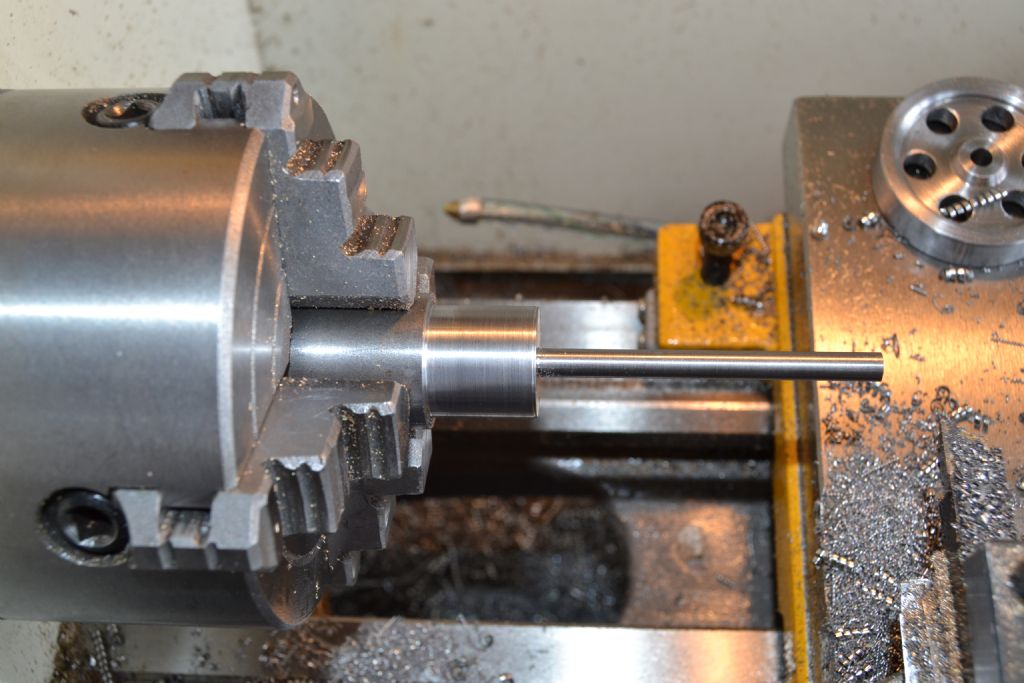

                                                  #195782
                                                  Gas_mantle.
                                                    @gas_mantle
                                                    Hi,

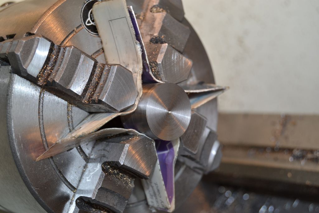

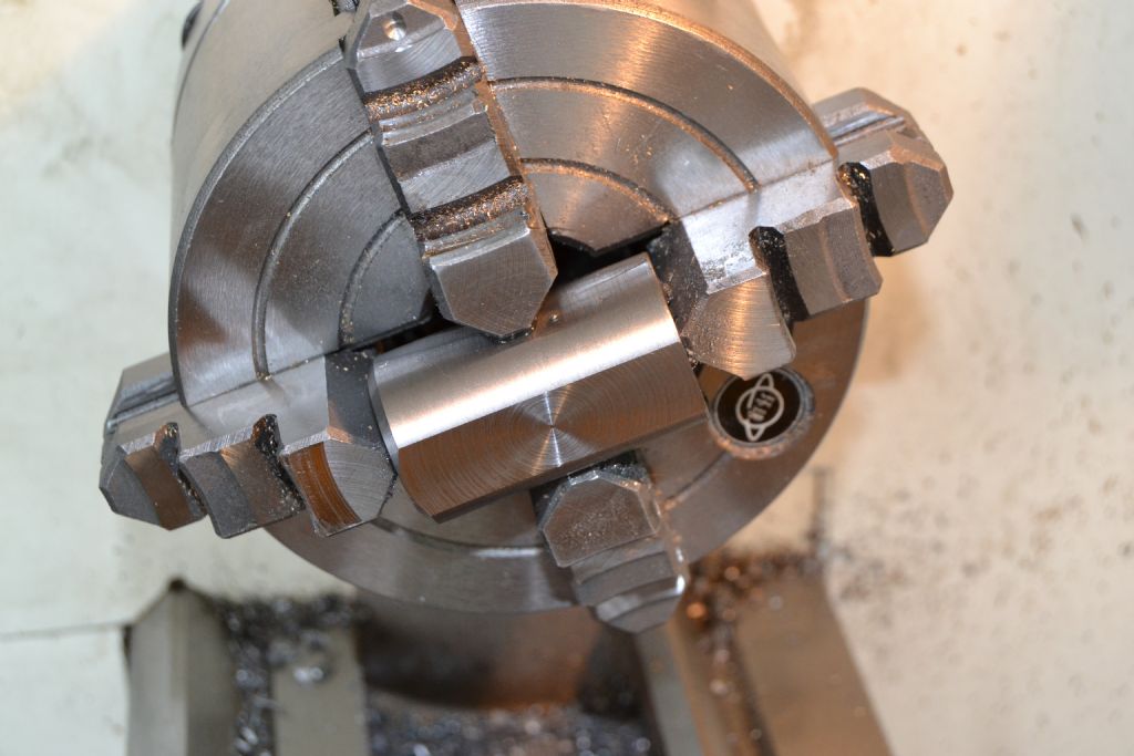

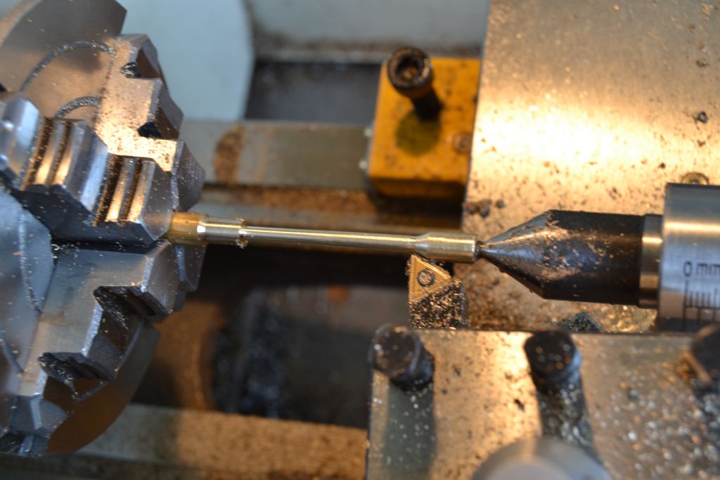

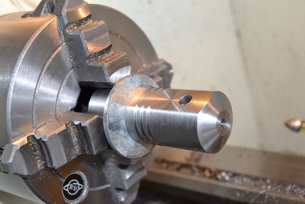

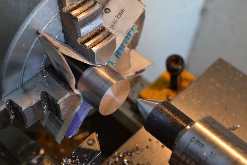

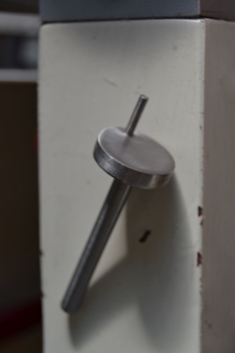

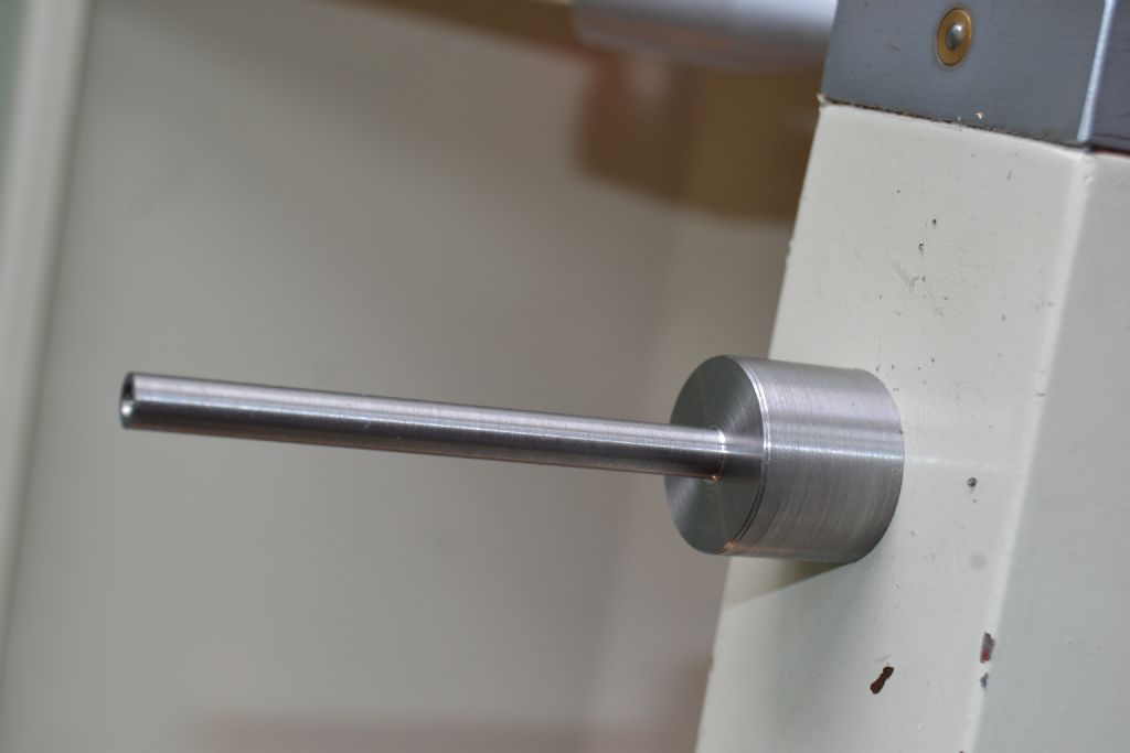

                                                    I thought I'd have a go at the main axle and crank today but after the disaster I had trying to make my first crank disc a couple of weeks ago I wasn't confident.
                                                    I still can't see how it's possible to turn a small disc shaped work piece that doesn't have a central hole, at least with a hole I could make a temporary arbour.
                                                    The only possible way I could see round the problem was to turn the entire axle, crank disc and crank pin out of a single piece (admittedly I could have done the crank pin as a separate item but chose not to)
                                                    Firstly I turned the axle and the end that would ultimately be the crank disc and crank pin to size.
                                                    Then turned the work around to face off and make a small mark indicating the centre in order to assist marking out for the crank pin offset.
                                                    So far so good, but I'm still not confident about trying to machine down the crank disc width and leave the offset pin.
                                                    The main axle is 5mm diameter which doesn't seen enough to bear the strains of holding the work while I do the offset.
                                                    In order to hold the work by the widest part in the chuck I won't have much to hold on to if I want to make the crank disc relatively thin but this seemed the better option.steamer 8 (9).jpg
                                                    Surprisingly it worked better than I expected and after a bit of light filing and emery cloth use to get rid of a few chuck jaw marks I ended up with this.
                                                    Although the method I used did work I'm sure there must be an easier way, can anyone suggest a better way of turning small disc shaped object without a central hole, particularly ones that need offset turning like the crank disc ?
                                                    Thanks
                                                    Peter.
                                                    Edited By Peter Nichols on 04/07/2015 21:23:42

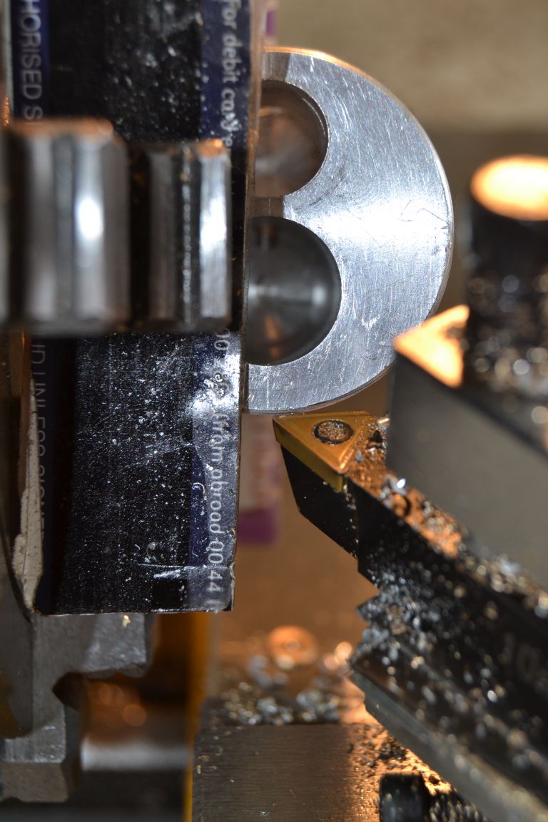

                                                    #195978
                                                    Gas_mantle.
                                                      @gas_mantle
                                                      Hi,

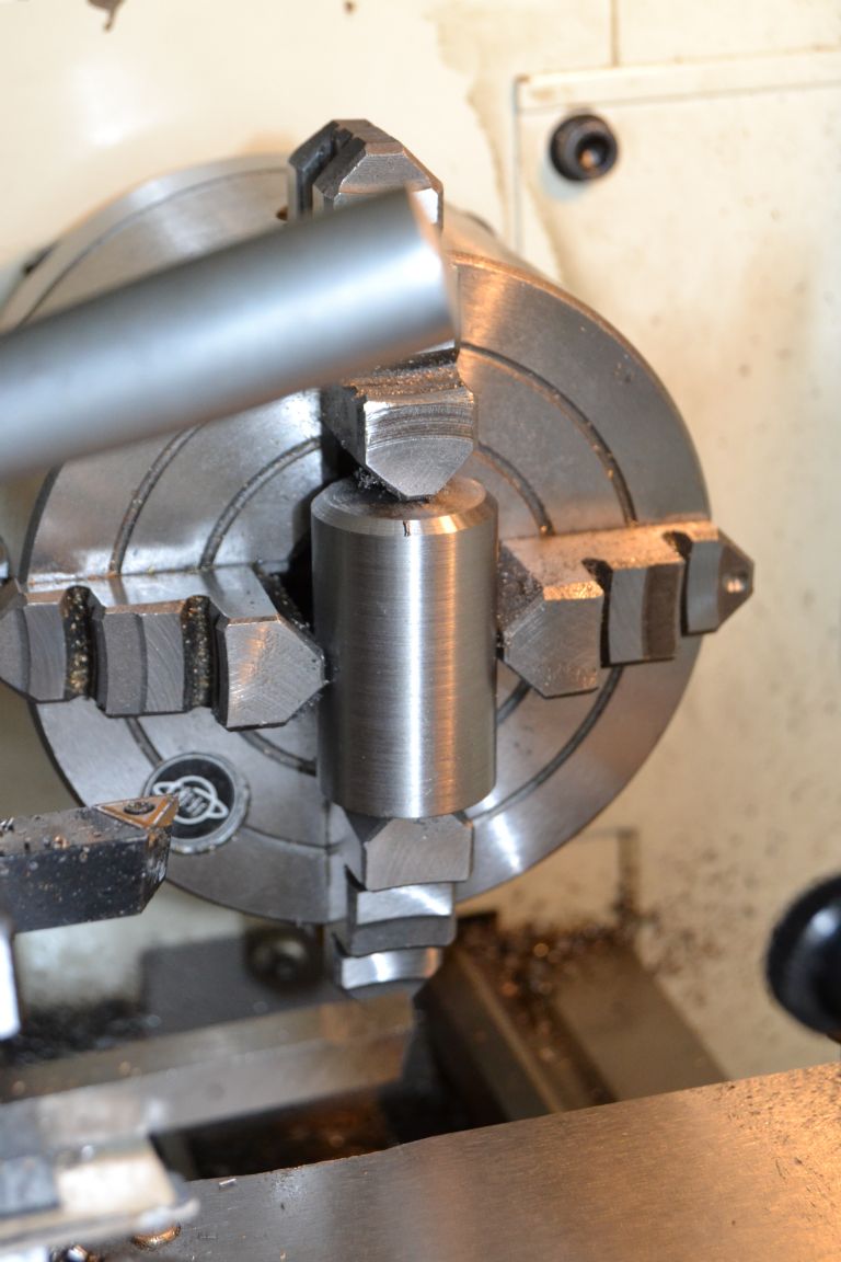

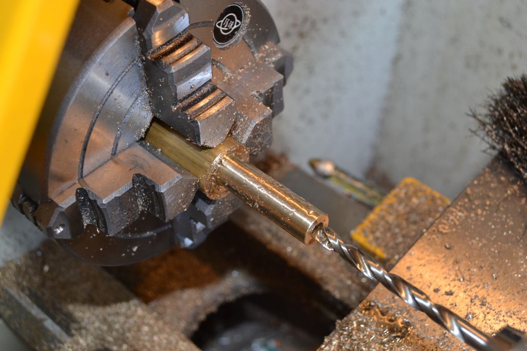

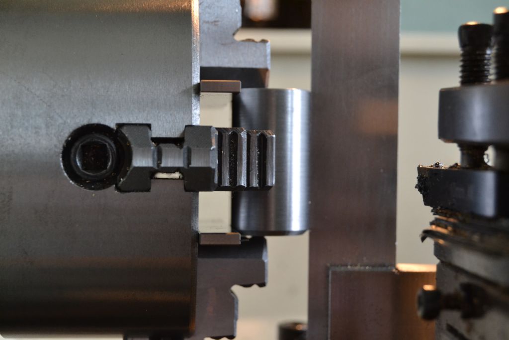

                                                      I had been wondering for a while on how best to support the main axle, given the small size of this engine I didn't feel there was enough room to have 2 separate supports and decided I use one relatively large diameter cylinder of mild steel and attempt to machine 2 opposing flat faces where the axle would enter and exit.
                                                      Yesterday when I began the task of making the mounting it turned out to be one disaster after another, I struggled to get anything square and at one point even resorted to using a dial indicator on the chuck jaws when I was running out of ideas.
                                                      Eventually I did manage to drill the axle hole but it tuned out to be far from parallel to the base. Even in this small photo it's possible to see how far out of line it is.
                                                      Trying to machine 2 parallel flat surfaces in the lathe by facing off with the work across the chuck proved to be the killer blow and I ended up with this.
                                                      I decided the best thing was to have a few beers, sleep on it and try a different approach tomorrow.
                                                      Second time round I thought I'd try to machine the 2 parallel faces first (after truing the diameter and facing the ends). The first face seemed to look ok, visually at least.

                                                      I took far more time and care aligning the work this time, whilst saying to myself 1000 times 'I must not leave my parallels in the chuck'.
                                                      First impressions suggest 2nd face looks ok.
                                                      Yesterdays bodged attempt came in useful as a temporary threaded arbour to hold the work whilst I finish turned the diameter, cut a few decorative grooves and cut a taper for the top.
                                                      I also decided at this point to drill a small oil hole from the top to meet the axle hole. I'm not sure this will be necessary but it will give an excuse to top it off with a small knurled nut which will be a bit of added decoration if nothing else.
                                                      It's not perfect but I'm happy with the result.
                                                      Not yet fixed down and there is still a bit to come off the crank pin and axle but it's beginning to take shape.
