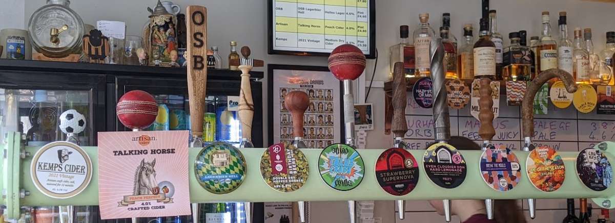

      Hi all- This may be slightly off-topic for an engineering forum, but I hope someone may be able to provide some material advice. More like arts and crafts, but I still have to machine some threaded inserts.
      For the local Micropub(where I used to work), I have been making some custom handles from weird and wonderful objects. They serve all sorts of weird beers, but generally from some repeat breweries.
      PXL_20230825_131951507.MP
      (Old picture, some have been updated/changed since (eg. there is now a whisk, a reamer, a tap wrench, an old telephone handset, and a manakin hand)

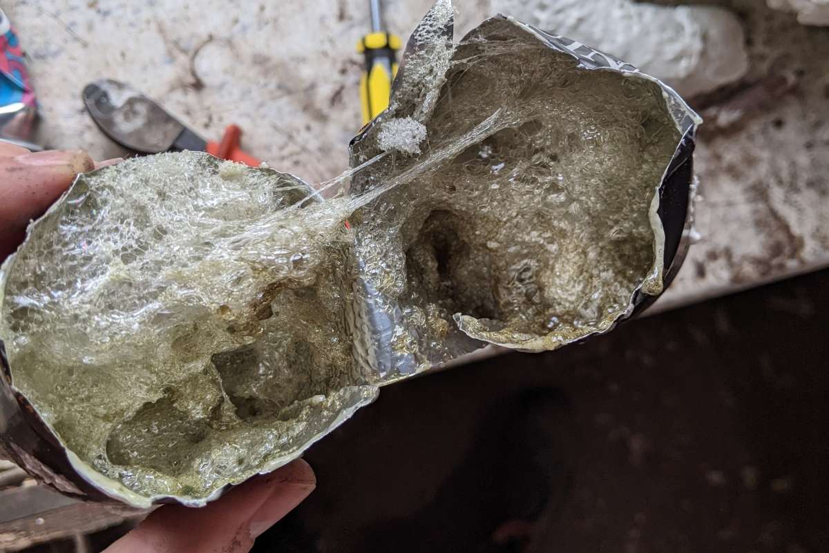

      I would like to take some beer cans, drain them (a real chore), fill them with some pourable material set, and create a rigid can into which I can glue a threaded insert.

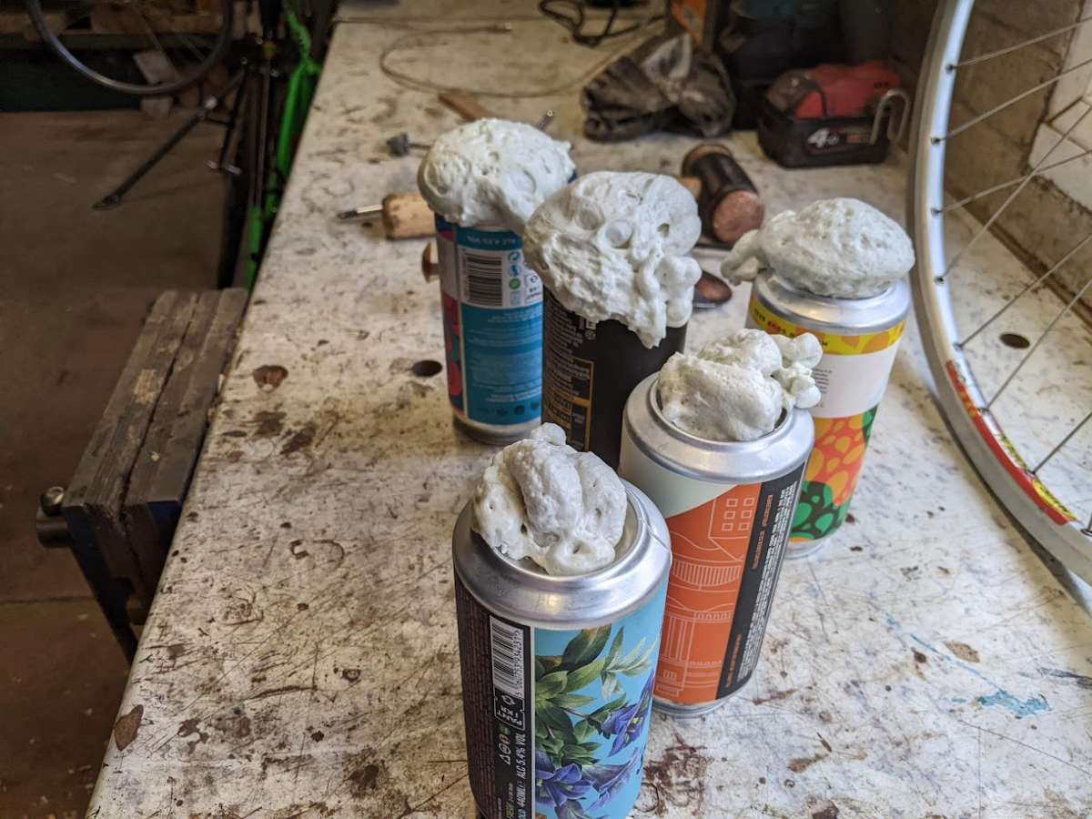

      I attempted this earlier in the year using Spray foam as that sets up quite solidly. However, it went terribly and all just oozed out of the can creating a very sticky mess.
      PXL_20230823_114406730
      Ideally, I would like to avoid cutting the can open more than just an 18mm(or so) hole in the bottom and a few smaller vent holes, so something I could pour would be good.

        PU resin would do it and not get hot like some others. For those sort of volumes it can be bulked up with various fillers.
        Pure cement (no sand) would also do it at a lot less cost, just mix to a pourable consistanct and place your insert before it sets.
        Plaster of Paris is a bit soft so insert may pull out, gets hot when a large volume cures and will dissolve if it gets wet.

                      In principle, the spray foam should work. The issue is that the process of applying/injecting it as shown in the photos is not controlled. It is oozing over the top because the trigger has been held in too long. Gun grade foam is a lot more controllable than the other option. Some simple experiments would determine the correlation between fill percentage and pull time. If that was too difficult, hot glue a piece of 15mm plastic pipe to the top (base) of the can to contain the overspill (just like a riser on a casting) and then break it off once expansion has stopped and solidification has taken place.

                                I do think the spray foam would work with a much larger hole, but it made such a mess. I did try plugging it and spraying smaller amounts but the results were not good. I do not want to go down that road again!PXL_20230824_093821869.MP

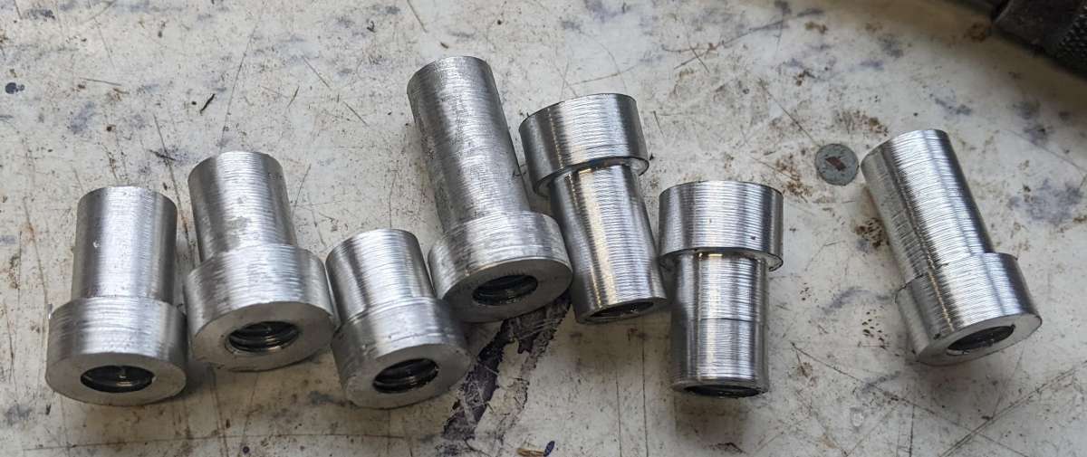

                                As for the mounting thread, the taps on the bar have a male 3/8x16tpi UNC thread, around 20mm long. For past handles I turned some female inserts of around 12mm dia, with a larger shoulder. The mounting threads also have locking rings on, which can be used as a kind of jam nut, so the rotation of the handle can be adjusted to the right location (and can logo shown appropriately).

                                    A thread or some grooves on the OD of the insert would help to hold it in place.

                                      If using a foam, first attach some ClingFilm around where the foam oozes out. Hold it in place with a light glue eg Pritt stick.
                                      Once the foam hardens then it can be cut off near the film and the remainder coaxed off along with the film.
                                      And, as Oldiron notes, put a thread or grooves on to the external surface of the inserts – the deeper the better.
