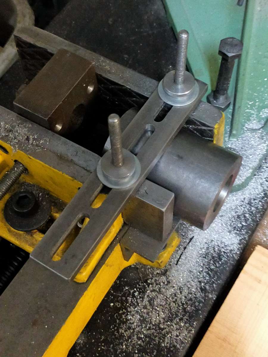

        I incorporated all of Neil’s excellent mods to my bandsaw but one further addition I have made is a bar across a pair of studs to hold stub ends firmly and to stop them tilting from downward pressure.
        Rod
        bandsaw mod

                Roderick’s top clamp is a very good idea.
                Another job on the “round tuit”
                FWIW, I tapped the far end of the moving jaw (M8) , made up and fitted a M8 stud, with a knurked “knob” so that the jaws can be better aligned when clamping short ends.

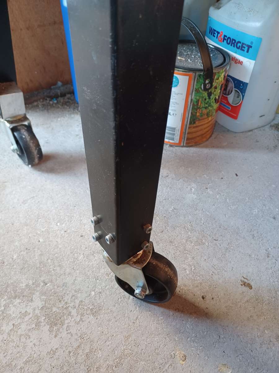

                David George 1
                  @davidgeorge1
                  I like Rod’s mod to put a downward pressure on a piece of short metal held in the vice. Another mod to do but i may put a screw through the clamp to press down on smaller pieces. I have fitted wheels on my saw which helps greatly moving it arround the shop. I saw a dolly trolly in Aldi for only about £5.00 and the wheels looked just the right size. I just made four ally blocks and bolted them on to the legs and fitted the wheels.
                  20240723_064229
                  David
