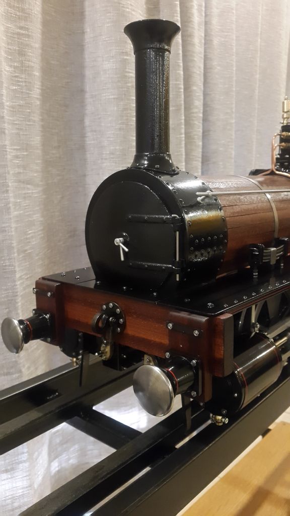

        Hi everyone. Here’s a little sneak peak of my next construction series… hopefully not much longer before it gets published.

                Yep this little loco is loads of fun on the track, and easy to drive (no pesky roof or cut-outs to take skin offcrying). She takes two large adults without slipping or complaining (haven’t connected another drive cart to see how many people she could carry). She has a constant lead valve gear so you just slip the reverser in full forward and you can forget about it until you parked in the station again. I haven’t found the valve gear to be lumpy (suppose that’s the benefits of dynamic simulations) and I can get my fingers between the cylinders for maintenance etc. I actually blew out one of the valve chest gaskets when I was (abusively) testing the loco and it was no issue to take the cover off and replace the gasket (just baking paper, no sealant) on the loco. I had forgotten to tighten two nuts and she still steamed for the rest of the day. Incidentally when I test a loco I do a proper job to make sure the design is sound.
                I like the analysis of the gents in the manufacturing yard picture! Seems like, even in those days the person that’ll do most of the work is furthest from the loco.
                Na, I just liked the look of that low pitched boiler and the odd valve gear. I actually didn’t know of the connection to Pretoria…
                I call this my COVID loco; it was designed and built in the first 9 months of 2020 when we had a very restrictive lockdown.

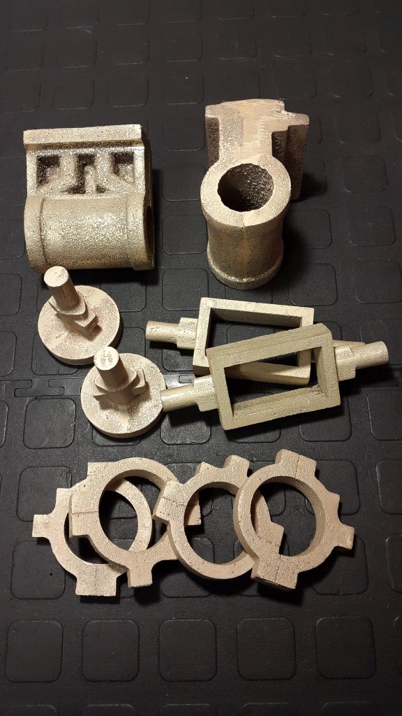

                                      The "Castings" are likely to be where the costs and work are for those that do not have the facility to cast their own like you do so will either have to make patterns to have the parts cast or fabricate/cut from solid presumably from bronze which could be costly. They also won't have any risers as a material source.
                                      Will the drawings have sufficient dimensions of the "cast" surfaces so that builders can make patterns, fabricate or cut from solid as it's usual to just dimension the machined features for cast parts?

                                        Jason; there should be enough dimensions to make patterns. If any are missing it wasn't intentional. I have no doubt that there is no casting I can come up with that you can't fabricate! But for the average builder or even the beginner I don't think any of the parts will pose much of a problem (to fabricate). The cylinders will require a decent torch, and some of the detail can be left out to simplify.

                                            I think you may find similar castings, any inside frame Stephenson 5g model with similar bore and stroke could probably be modified. The cylinder castings and cylinders are shown below. The fancy cutouts around the steam ports are only to improve the castability, and aren't necessary (besides these are at the bottom and on the large loco this was covered in cladding).

                                              One casting that might be difficult to find is the smokebox door, but this could easily be built up or machined from a disk. The cutout at the bottom is something unique.

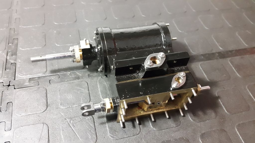

                                                The valve glands on the steam chest as well as the piston side cylinder cover has some interesting detail…

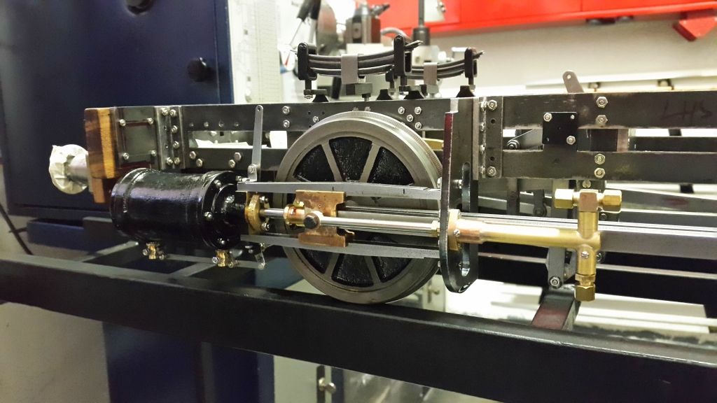

                                                      For everyone following the Ballaarat construction series here's a nice video showing the frames and linkage in motion.
